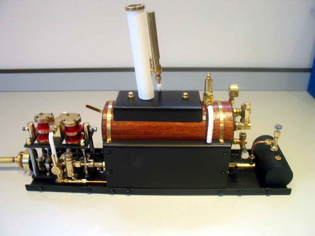

                  Fred Nightingale 1
                    @frednightingale1
                    Hi Robert
                    My first attempt at modeling was a 44 inch steam launch called Miranda from plans by Basil Harley, the only thing I changed was the burner. The original was meant to run on Methylated spirits but I redesign this to run on gas which is much cleaner and easier to use.
                    I have attached a picture of the power plant.
                    Steam Engine
                    Fred

                    Old School
                      @oldschool
                      Hi Robert
                      A few years ago I built a windernere launch powder by a Reeves V twin oscilating engine with speed control and forward and reverse the launch is about 3 feet long. The boiler is a horizontal centre flue fired with a petrol blow lamp very similar to the gas powered lamp in the picture above. The petrol blow lamps are no problem to build, run and provide a good source of cheap and ample heat to run a boat boiler.
                      My experience meths is fired boilers is wick lamps and single cylinder oscilating engine. for my children to play with when they were younger.
