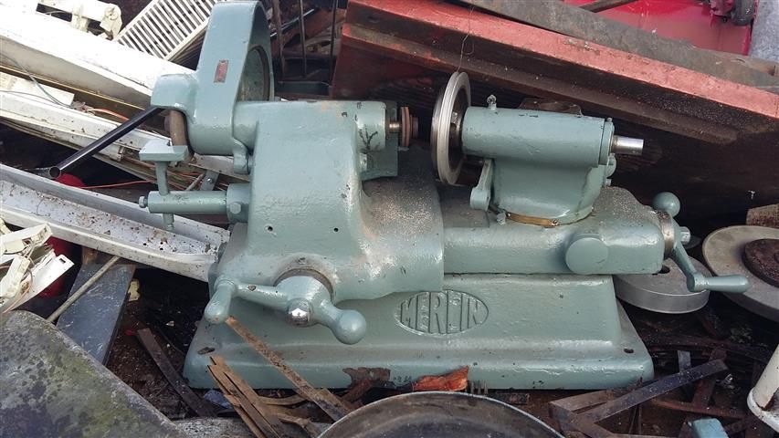

      Spotted this partly buried in a local scrap yard.
      I've searched the internet for information with no luck.
      Any ideas?
      Ian

          An interesting find, I know nothing about it but is it worth saving ?

            Looks like a valve grinder ? Garages used to have them

              hi ian it is a valve refacing grinder ,the collet holds the valve and is adjustable to different degrees the other end is for truing up the end , i have an american black and decker version which i have a modified fittining for sharpening drill bits , a very handy tool, i had one made by wolf years ago,but it may be old but it get used a lot , will

                Although it's in a remarkably clean condition, best walk away from it. It belongs to an age when things were repaired rather than skipped.
                When it costs £100 for a "Mechanic" to lift the car bonnet, just think how fast the pulse generator of an electronic cash register will be running when it comes to getting to the point of actually putting a spring comp– don't even go there.
                Think it's more likely to be a Diesel injector pintle grinder, Merlin made various machines for Injector and pump servicing.

                  No it's a valve re-facer.
                  Used to have one at the truck garage and a B&D one.
                  The motor is missing from this one.

                        To me, it looks like an excellent basis for a Tool & Cutter Grinder, and I would welcome it with open-arms.

                            michael thats what i have done i can now sharpen tools /drills /cutters with my modified h hall version made from his drawings and i still use it for valves on the old panther motorcycles that i repair i find it being used at least once a week , will

                              So it's a valve grinder then.Thanks to every body for your suggestions.

                                        Never abandon good machinery to the melting pot. Someone will find a home and a use for it. There looks to be a standard wheel and tool rest at the left hand side so maybe it’s not a valve surfacer after all. ?
