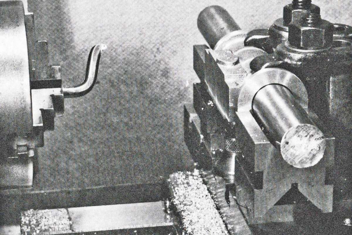

                Looking through TC’s Mary book, I think the only milling he calls for is for the cylinder port face.  This is his set setup:
                Mary portface skimming
                TC’s method for making Mary uses only a lathe and a drilling machine together with some hand filing.  If you are starting from absolute scratch then I would recommend purchasing a mill rather than a drill because the mill, even a very small one, will make some of the facing jobs easier and provides a drilling function with the added advantage of a coordinate table for accurate positioning.
                Rod
