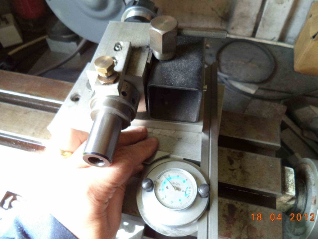

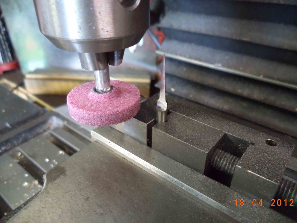

      Its usual to make Injector D bits from silver steel by machining the taper on the lathe then sectioning with a file or mill then to heat treat, whilst this method can produce a perfectly functional D bit there are a number of draw backs:- you need a razor sharp turning tool to machine the taper to avoid distortion like wise when it comes to sectioning and heat treating can be a bit hit and miss.
      This got me to wondering if it was possible to make some D bits from High Speed Tool Steel in a home workshop.
      The starting point was to buy some 5mm Dia HSS tool blanks these were 4" long so I cut them in half then using the hand drill I roughed them out on the bench grinder.

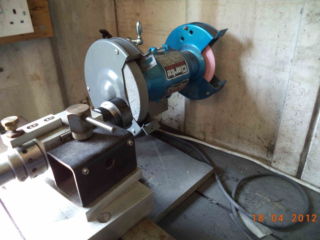

      I have a "home Brew" cutter grinder that I put together using commercially avaiable parts:- Grinder, an X,Y Table and a Myford vertical Milling attachment
      The first job was to dress the wheel up square to the table, using a diamond.
      I have a home made grinding attachment that uses a Er32 collet and an index plate for sharpening end mills by taking the pin out of the index plate I could rotate it by hand. The attachment was set over at the required angle
      And the D bit ground to the required angle

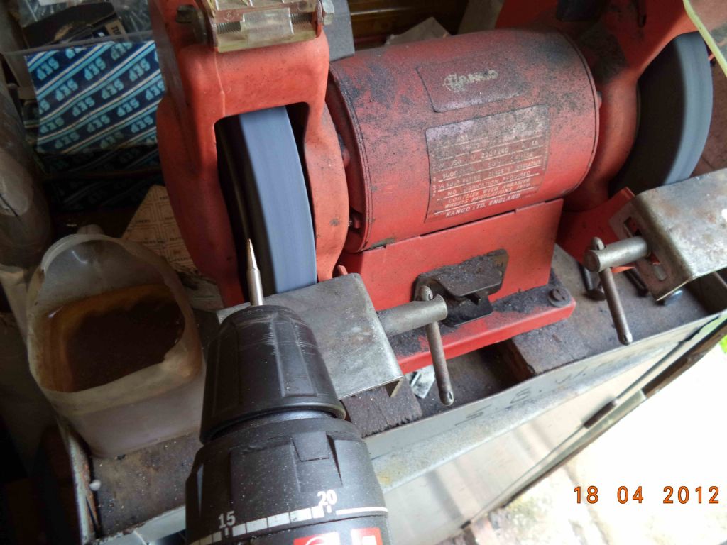

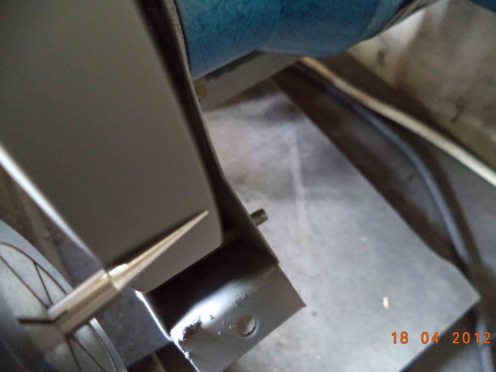

      To section the bits I first roughed them out on the bench grinder then with a grinding point in the mill set a max speed the Bits were sectioned off to size
      I've just used them to make some injector cones and they cut far better than the silver steel bits and it looks like they are keeping their edge well.
      Stew

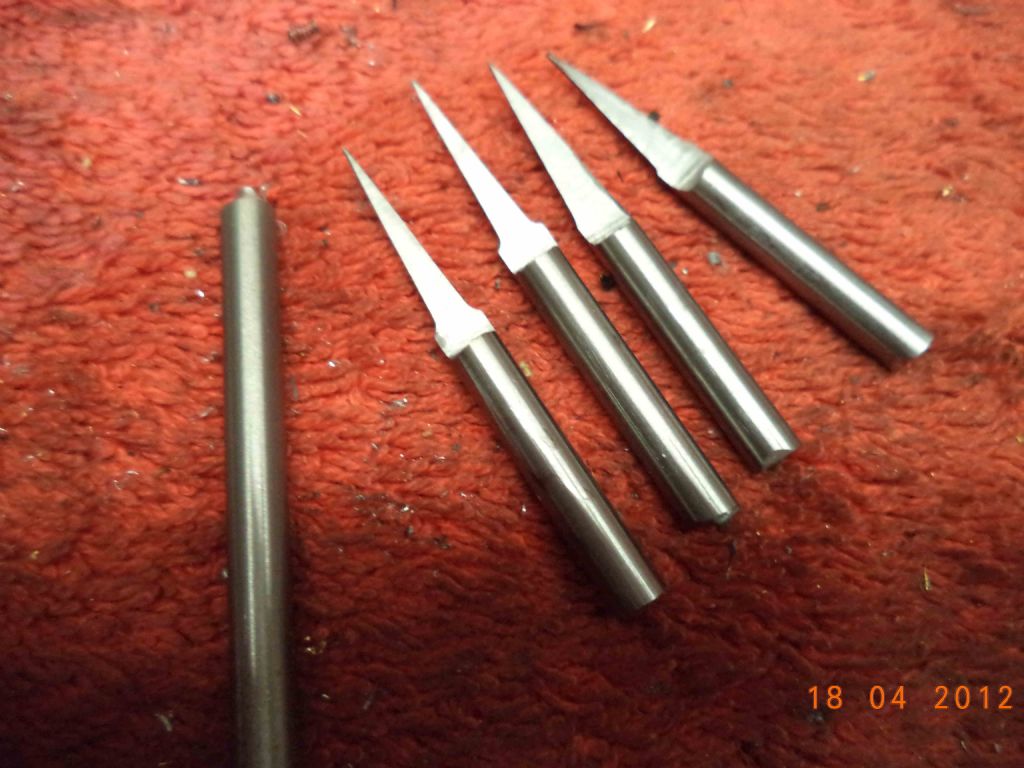

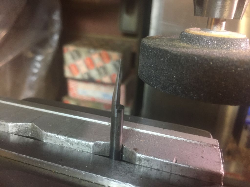

          Simon Collier
            @simoncollier74340
            I tried something similar a couple of months back69752a73-45e7-4dd1-890c-7a3c0b3b6fac.jpeg

                Here are some more pictures of the set up.
                The grinder it self was quite easy to put together Its just a Myford vertical slide with an ordinary bench grinder mounted on it you have to remove the base of the grinder and do a little rewiring to mount it securely and a X,Y table mine came from axminster but there are plenty of other suppliers of these tables out there. and it all mounted on a bit of ally plate but a friend made one and mounted his on a kitchen work top off cut.
                As well as the end mill grinding jig I've also made jig for sharpening slitling saw and lathe tools.
                Its far easier to put together than a Quorn cutter grinder or one of the other home built cutter grinders designs around.
                Stew

                            I do like that tool-grinder set-up.
                            Ideal for making D-bits and engraving-cutters, too.
                            Looks as if would not take much to adapt, by suitable interchangeable brackets etc, to a simple surface- and cylindrical- grinder.
                            One suggestion I'd make is using thin rubber sheet to make covers for the slide-ways. Garden pond liner off-cuts perhaps: having given my resident frogs a nice comfy home I used some of the surplus butyl liner for a cover to replace that missing from my (2nd-hand) Myford milling-machine.

                              I'm pleased you like my grinder set up Nigel.
                              I have covered the slide ways some time back, I used the lorry curtain side material its ideal for the job.
                              I've only ever used it for cutter grinding but yes it would be possible to adapt it for surface/cylindrical grinding but just how accurate it would be would be the ?.

                                      Hardening D-bit reamers usually resulted in banana-shaped curiosities for me. So having been inspired by an article about injectors by Basil Palmer, I ground some HSS injector reamers using his idea of triangular section. (Would be likely to give more even results in silver steel as the section is more uniform and symmetrical, so less prone to distort.)
                                      I mounted a Quorn head on my Boxford 280 to grind some HSS and it worked out quite well. Note that if you want a 9 degree included angle, you DON'T grind the faces with the top slide at 4.5 degrees but at about 2.2 degrees – it depends on the diameter of the grinding wheel.
                                      I made the mistake of grinding some Chinese-sourced HSS 6mm dia, only to find out when I tried to use one for reaming an injector cone that the stuff wasn't hardened. After trying it, the pointy end of the reamer came out looking like an oliver off a Showman's engine! I then dug out an old HSS tap and ground that instead. I did get a working injector, but it needs more time and attention than I have at present to get the working pressure range I want.
                                      Despite covering up all of the lathe I could with newspaper, it still took ages to clear up all the horrid mess after grinding – so take care!
