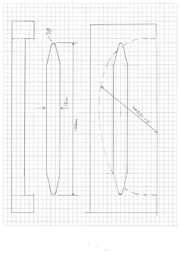

              Ok so here is the sketch apologies for my poor attempt to show what I am trying to achieve

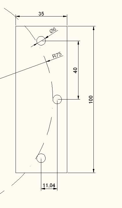

                If you can come up with an accurate slot shape it would be a simple job for CNC, the sketch as drawn does not have sufficient detail. Also if you could define what is being measured it may help.
                Martin C

                Hopper
                  @hopper
                  I think you could machine that radius with an end mill cutter and mount the job on a larger plate on top of your rotary table so you could achieve the 150mm radius. Or mill the whole thing out of a larger piece of plate that can be bolted to the rotary table with 150mm offset, then cut the plate down to size afterwards.
                  The slot would be straight forward slot milling for the main part then do the ends with a 6mm cutter to give your 3mm radius at the tip, again using rotary table to get the angle of the pointed part of the slot.
                  #608852

                        If the slot is 150mm long then does the radius not need to be 75mm rather than 150. in which case just about swingable with a boring head.
                        6062 available from most hobby suppliers such as M-machine
                        Edited By JasonB on 09/08/2022 11:44:56

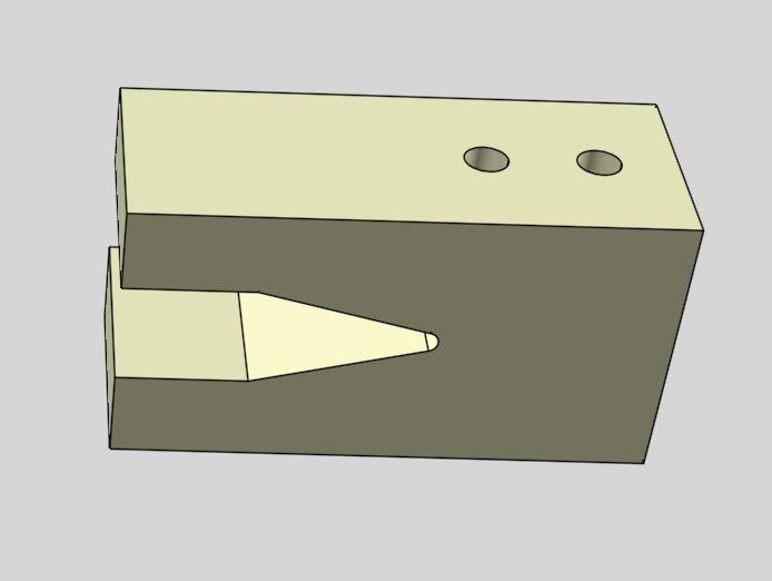

                              I would think a simple plate with a slot, as used in the post office for letters, would allow the profile to be checked easily. A simple plate with three dowels in it would allow checking of a radius/diameter. If all three dowels contact the part then the radius is correct, if the centre one does not touch the radius is too large, if one of the outer dowels does not contact the part the radius is too small. It does not need to be a huge plate, something like 75mm between the two outer pins would be enough.
                              Here is what I mean, it uses far less material than a large plate and is easy to produce.
                              Martin C
                              Edited By Martin Connelly on 09/08/2022 12:17:46

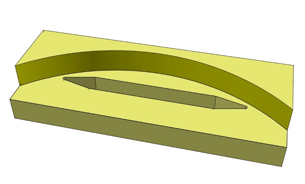

                                        As it's only a check guage could you not 3D print it. My Ender 3 will print up to 220x220mm, so would accommodate the jig. Tolerance is pretty good <0.5mm so it would likely be accurate enough.
                                        If it was OK you could knock off a few in case of accidents – they would come out a lot cheaper than Ali.
                                        Cura says 128g of filament  so about £3 worth but 22 Hours printing time, however you can leave it to it.
                                        Edited to add picture
                                        Edited By Peter Cook 6 on 09/08/2022 14:07:46

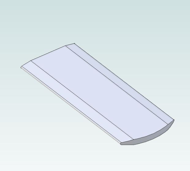

                                            a 150 radius would give a dagger that looked like this not like the photo?
                                            Also does it need to be a double thickness to rest against the side of the dagger or just like this offered up to the end
                                            Edited By JasonB on 09/08/2022 15:03:55

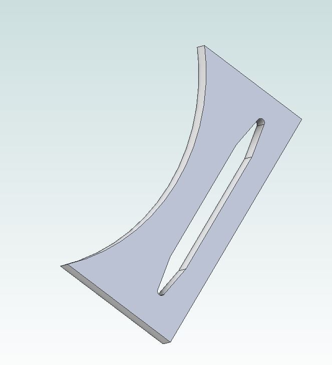

                                              Posted by Trevorh on 09/08/2022 13:44:17:
                                              oh its definately 150mm RAD
                                              Trevor, perhaps now is the time to grab one of the free CAD packages, or a 90day trial of one of the paid for, and have a go.
                                              Looking at the picture in post 7, the curve at the bottom looks very close to a semicircle. So either the board is 300mm wide and the slot in your drawing (post 4) should be 300mm long – in which case the simple print idea is not going to work, or the curve is 150mm diameter.
                                              If it is 300mm wide, you could still print the difficult bits – make 2 of these
                                              and bolt one at each end of a length of aluminium or steel bar
                                              Replies go there before I finished.
                                              Edited By Peter Cook 6 on 09/08/2022 15:37:53
                                              Edited By Peter Cook 6 on 09/08/2022 15:40:11

                                                It just needs to be offered up and then pass through the jig to check thickness and profile
                                                The photo was to get across the idea of what I needed to measure
                                                Thanks Jason
