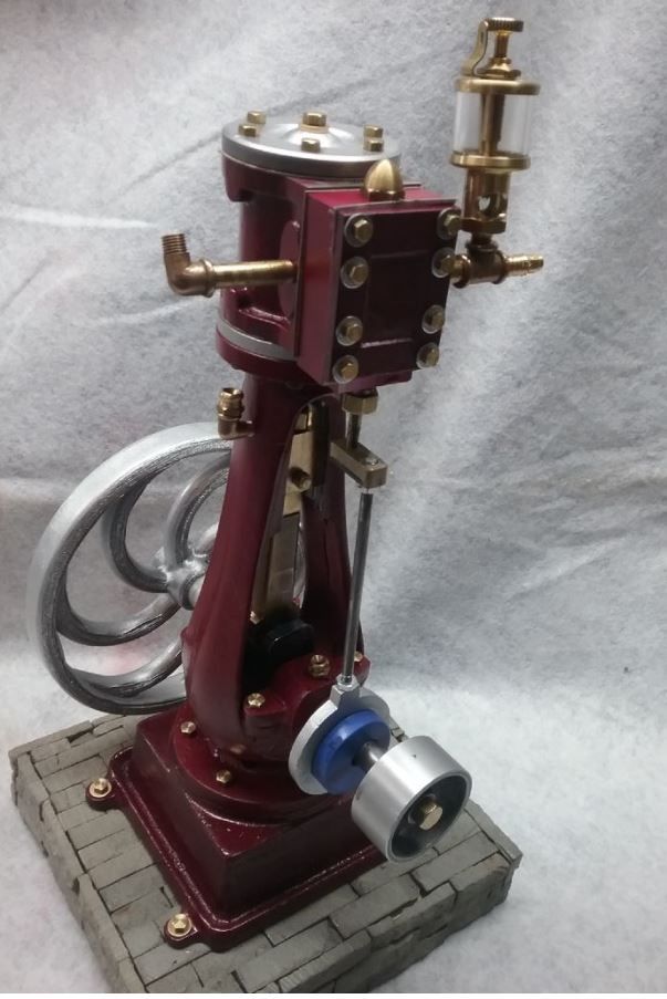

      Here is my completed Lil Mo engine with a 3D printed flywheel. Seems to run the same with either flywheel attached. Just waiting for the Oak mounting base from my brother in law's woodworking shop. Best holiday wishes to all!

        Ready for hardwood base

            How does that drip feed oiler work? air/steam pressure will want to blow back out of it and even if you had a non-return valve there would be no vacuum to open it.

              Displacement Lubricators
              A displacement lubricator is basically just a closed oil tank with a small pipe connecting it to the main steam pipe which feeds the cylinders.
              Steam from the main steam feed pipe enters the oil tank and condenses into water. Due to the difference in specific gravity between water and oil, the oil floats on top of the water. As the water level increases it displaces the oil which runs into the main steam pipe. The oil is then picked up by the steam flow where it is atomised and emulsified and carried to the cylinders. (Will only work with steam, not air as the oil has to float on the condenced water).
              The process is continuous, and repeats until all the oil is gone.
              A filler plug is fitted to permit filling with oil, and a small drain plug is fitted to the base of the oil reservoir for draining the condensed water.
              A needle shut off valve is sometimes provided in the oil feed pipe to regulate oil flow, and to prevent any steam under pressure in the piping escaping though an open filler.

                Well done.
                Is that a plastic eccentric and strap?
                Interesting to see the use of unconventional (perhaps better said as non-traditional) materials.

                  Paul, I know how displacement ones work but that lubricator is OPEN where you watch the drip

                          Its hard to see in the photo, but there should be a glass tube inside the brass opening so you can monitor the the number of drips of oil passing thru.
                          But on closer inspection, I could be wrong. It looks like a standard drip lubricator as used on bearings, not a displacement lubricator. Will be interested to find out.

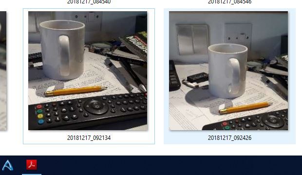

                                  It's because your phone records the orientation of the photo in its meta-data but doesn't actually rotate the image. Windows is able to read the orientation data and display the image the right way up. The forum software can't access this metadata so you have three choices:
                                  1. Open the photo in an editing program and make sure it is rotated to correct orientation and resave it.
                                  2. Insert into your post then immediately click 'edit post', once the editor opens right click the image and select 'rotate 90 degrees' in the appropriate direction and save the edited post. It is possible that some users can't access this editing option.
                                  3. Take photos using your phone in landscape mode
                                  Edited By Neil Wyatt on 16/12/2018 23:10:23

                                                As neil says you still need to hold it the right way up when taking landscape
                                                Here is one taken landscape with phone " shutter release" to the left. Uploaded straight from phone.
                                                And one with it on the right
                                                Some previous "upside down" photos in Robert's album would seem to suggest this is what he is doing. The only image of this engine the right way up is the one I edited and uploaded to Roberts album.
                                                This next screenshot from my PC also confirms that windows can read which way up the image should go as both are the right way up when I view the phone's content on my PC but the forum software can't tell the right way up.
                                                Edited By JasonB on 17/12/2018 09:36:10
