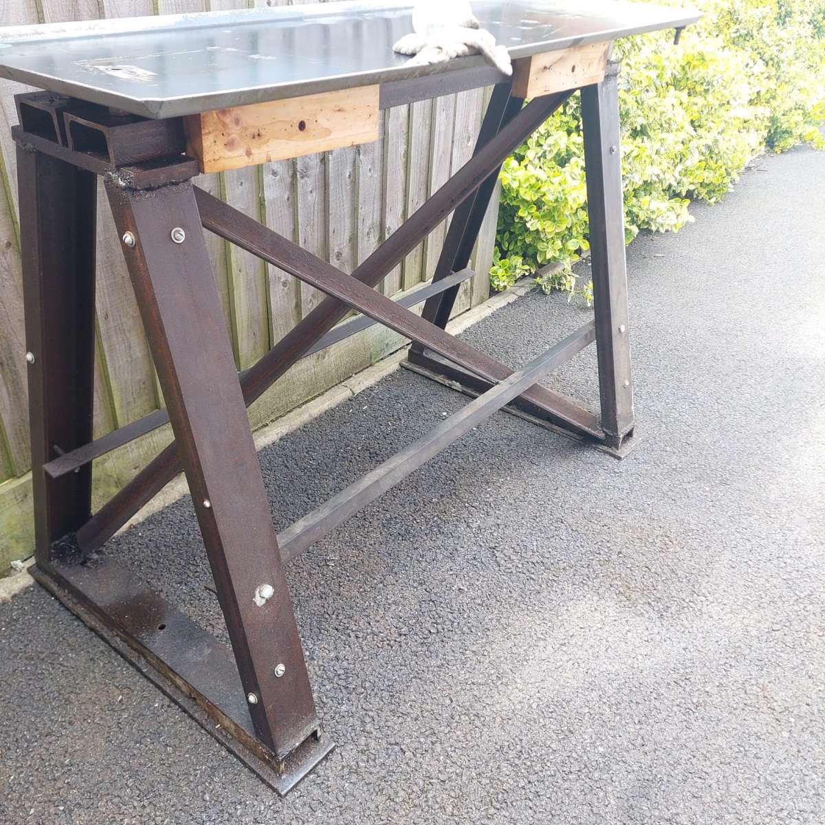

      I’ve just bought a Maxmat V10P and it came on this homemade stand.  The previous owner, who was a bit shorter than me had it lifted up by about 10cm. I want to be able to move it around from time to time – I intend to buy a mill for it and I also have a big taper attachment and they would use the same holes so if I want to swap between them I need to pull the thing away from the wall and do some serious surgery – whether I actually will or not is a different matter.
      Anyway…I can get 10cm castors that will raise the height by 13.5cm no probs but then what? I need to level it and stop it wandering. If I use feet they’re going to be very long – will they be rigid enough? Maybe I still use feet but much shorter ones and then blocks of wood underneath?
      Thoughts appreciated please.
      WhatsApp Image 2025-04-23 at 21.57.43_dfe40d7e

            I’m.not clear on what you are intending to do with the stand? It sounds like you intend to use the one frame and swap machines onto it, is that right?
            If so I’d just make another stand, much less trouble. If not why do you need to move the stand round, my major machines are all static.
            Also leveling a lathe is a bit of a misnomer, lathes on ships and submarines could never be level in the sense of a spirit level.
            But they are set up to turn parallel which is the most important thing for any lathe to achieve accurate results.

              Are you wheeling it over a cobbled street or nice smooth tarmac as per picture? Castors are a pain as they shift the actual support point all over the place.
              If you have a flat surface you only need to raise it half an inch. If the surface is not flat make it flat with a sheet of thick ply.
              You mostly only need the wheels, non castoring, at the headstock end and can lift the tailstock to move. By only lifting a small amount it is practical to have a way of lowering the wheels when needed. Note I do not suggest lowering feet although that might be seen as easier because you end up with the lathe in working position on the end of possibly loose threaded rods.
              For levelling you only need one adjustable foot, at the tailstock end.

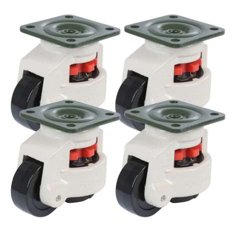

                This type of thing maybe, there’s lots of sources for the same, or similar, items
                image_2025-04-23_233140155
                Heavy Machine Levelling Foot Pad Wheels Castors 4PCs Set Flat

                    <p style=”text-align: center;”>That’s what I had in mind but they only have 10mm of travel and not as much overall luft to bring the lathe to wirking height. When the stand is in place after I finish painting it I will measure how much travel I need. I’m pretty sure it’s more then 10mm thiugh</p>

                          If you don’t want long wobbly adjustable feet then weld on some brackets that sit say 25mm above the bottom of the caster wheel and then the adjuster can be short and less likely to wobble.

                            I think it got lost in the noise. but I second bazyle’s suggestion of “lowering” the casters when you want to move it and leave it sitting on short adjustable feet when not.
                            If the floor is smooth then the casters can be mounted on a high cross bar so they only touch when the (short) adjusters are fully up. Screw up the adjusters to move. You could mount them on a lever operated mechanisim but it seems a bit over the top.
                            Whatever you do the casters should not be taking weight when the lathe is in use.

                                The stand whilst made of heavy material does not look very strong or stable, it’s bolted construction ? 100mm castors are available but I fear will only make things worse, even braked ones. As for setting the lathe to turn parallel, if it does it will be pure luck in this case !
                                I would start from scratch and build to the height you need. Bear in mind that the assembly will be VERY top heavy and moving it needs to be done with great care. Noel.

                                    The thin cross brace at the bottom is bolted, the diagonals are welded including welds to the bottom braces.
                                    The top piece is bolted with 4 bolts but I really was done up tight and the beams had bit into the tops of the base.
                                    I have no intention of leaving the lathe sitting on castors when it’s in use.
                                    I hear you re: top heavy – I will locate the castors right at the very corners of the base. Hopefully the U shaped beams aren’t exactly where I want to drill and tap holes for the castors.

                                          I use the castors that Peak 4 suggests This on a Myford stand for an MML10 Works superbly well. I often need to move the lathe and winding up the red adjusters puts the thing back onto the castor wheels.
                                          Levelling up the lathe is no problem. I use the adjustable feet if they are readily available otherwise just use the conventional method. It does not take long. People tend to think that levelling the lathe (removing bed twist) is a lengthy and complex task. Once you are familiar with the method it only takes me a few minutes I level it in the back to front direction and using an engineers level along the bed from headstock to tailstock any twist is easily seen and corrected.
                                          I suspect their will be howls of protest at this method, but I always check that the lathe turns parallel . So far it always has!
                                          Andrew.
