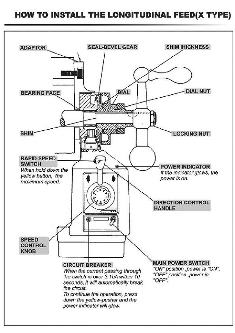

                  I've created an album, Align AL500.
                  There are several issues….How does the main unit attach to the table? I guess it is by using the holes in the unit and bolting to the bearing support on the end of the table?
                  Secondly, the bevel gear bore is smaller in diameter to that of the leadscrew( its metric not imp….) looks like the shaft is 16mm and the gear bore is 5/8… Not an insurmountable problem, just needs boring out, but the key and keyway are different too….
                  The bore diameter of the dial is bigger than the o/d of the bevel, needing a bush or sleeve.
                  I'd certainly appreciate any help you can offer in installing this
                  #263817
                  John Hinkley
                    @johnhinkley26699
                    John (Rudd),

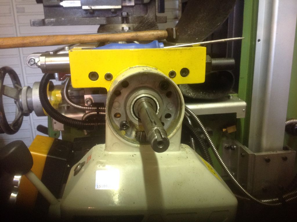

                    Just been out to the mill and stripped off the handle/dial/bevel gear. The machine is a metric one, but the shaft of the leadscrew measures 0.625 in Ø (5/8&quot or 15.8mm. So you takes you choice. The bore of the bevel gear fits perfectly on this. Be sure you aren't trying to fit it with the supplied casting – that's for a Bridgeport machine only.
                    Handle and bevel gear removed
                    Maybe if your bevel gear isn't the right bore, you've been sold the wrong power feed unit? If you will forgive me, you may have not measured the bore/shaft dimensions accurately enough. Have you tried fitting the bevel gear on to the shaft?

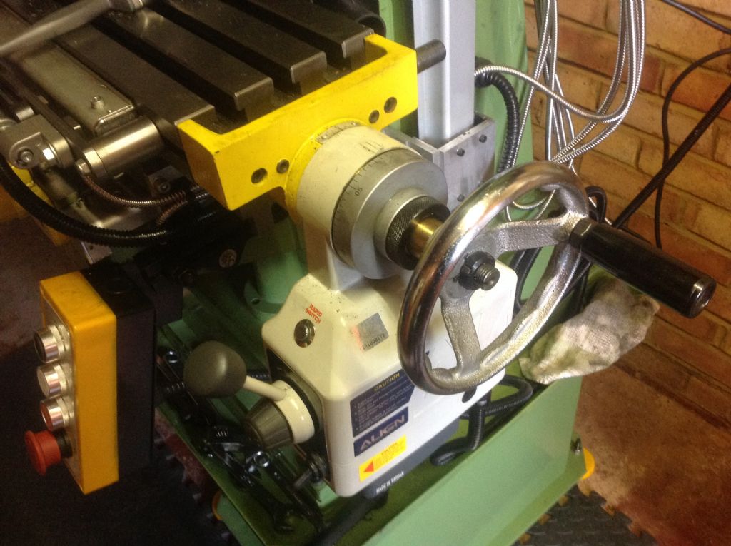

                    This what my installation looks like when complete:
                    power feed installed

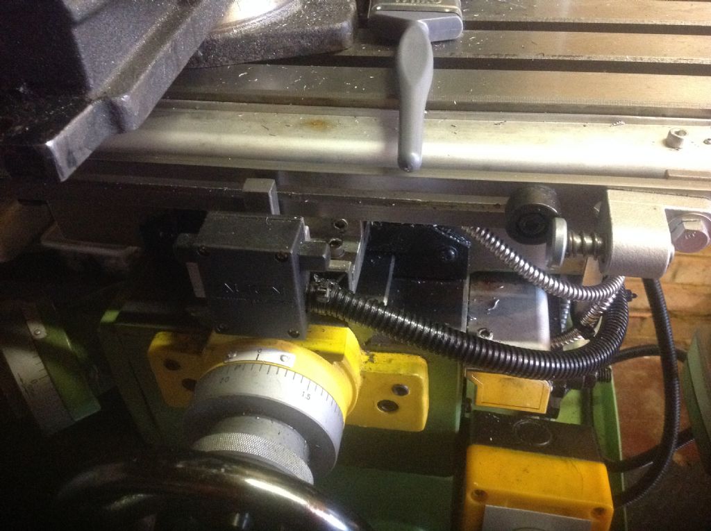

                    I found that the limit switch also needed slight modification. As supplied, the cable exits at the bottom; I needed to make a new exit on the side to clear the Y-axis feed mechanism:
                    limit switch
                    All these pictures and more are in my album "Warco VMC Mill". Here's the relevant page from the installation manual, though I assume that you've got this anyway.align power feed instruction manual page 3
