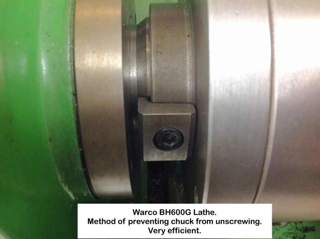

                          Warco BH600G:
                          As with MichaelT, the tailstock lock keeps coming loose, necessitating the need to squeeze hand between the ways to turn that lump of CI that's pulled up against the bed, locking it.
                          The Saddle lock that needs 3/4 turns, but modified to 1/4 turn.
                          The TOTAL lack of getting oil into the Apron gears as well as the power Feed Rod and associated gears at the rear, Subsequently fixed.
                          The slowest power feed speed, via the Gearbox to Saddle/Cross-slide, is way to fast to get any decent finish.
                          A fix being sorted.
                          On the positive side, however, the screw-on chucks are prevented from spinning of by way of two clamps as shown int the photo:
                          Warco BH600G Lathe
