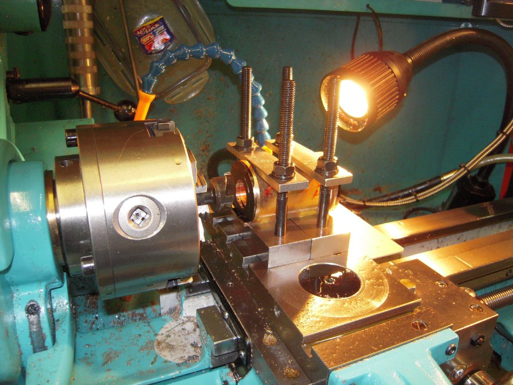

                                          Myford cross slide stiffness: the two steel blocks below the casting not only lifted it into the best position for the fly cutter but also allowed free and easy operation of the slide.
                                          Facing end of cylinder casting
                                          One minor niggle, not a weakness, about late Myfords is that to get to the oil nipple on the end of the back gear shaft the chuck has to be removed. Obviously the shaft only gets oiled between jobs. It has to be said Myford did like oil nipples. Every so often I wonder if I can afford ArcEuroTrade's oiling kit.
