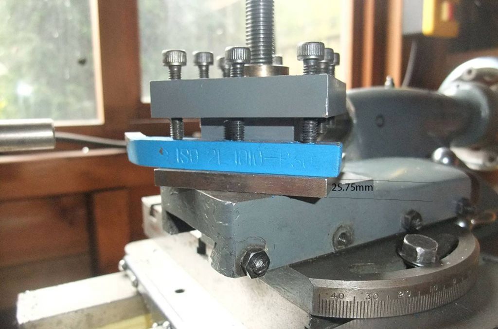

      Have a Myford ML7 and need to buy some decnt turning tools.
      Should I be buying HSS or Indexing, pross and cons?
      Also which size, the toolpost has a 25mm base on it

          I have a s7 with a 4 way toolpost similar to the one in your photo i find any tools above 3/8" square are two high above the centre line of the lathe ,
          Have you checked the blue one shown in you picture on the centre line
          Answer to you question depends what you intend turning myself for the home workshop i like HSS

            To get the blue one ctr I need a small bit of packing. Are you saying that if I measure the tool with the packing that,s the size I would need

                It looked to me that it bigger than 3/8" sorry . I have a tin full off packing ready for that same purpose.
                I may look into a quick change tool post . I have made tool bits to hold carbide tips

                        As Nobby says that 3/8 is suitable for a Myford I'd just get a 4 in length and make a different shape on each end. No need to get precious about special shapes as a basic knife tool (which is nothing like a knife) will both turn and face and chamfer so you only need to grind the other end when you find something you really can't do with what you've got.
                        The usual suppliers do simple parting tools. Don't get seduced by fancy inserted tip ones as they are so wide every cut costs a fiver in wasted metal these days.
                        There are a few websites with info on making tangential tool holders so as you have a milling machine you could consider that as a small learning project.
                        Find bits of aluminium for your packing. steel gets magnetised and grows swarf fur.

                            Your so right the tool is 10mm and the base is 5.75mm, dooh

                                              Don't use HSS bigger than you really need. 1/4 in should do for most ME jobs. Remember that the amount of material you need to grind away increases with the cube of the size so, for example a 3/8 tool will need more than three times the amount of material removed for a given shape than a 1/4 tool.
