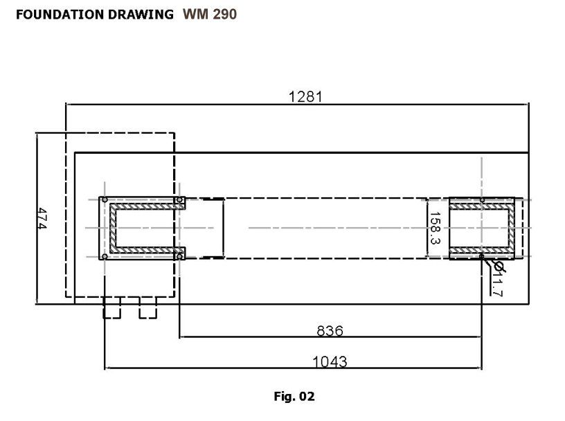

      Good Morning All,
      My name is Neil and I am very new to the hobby as I am approaching retirement, my main employment has been 40 years in heavy automotive and plant engineering and the last 10 in pumps and gearbox repairs.
      I have ordered a new Warco WM280V with stand, I am looking to cast a cement plinth for the lathe to stand on and be secured, my question is can anyone tell me the overhang of the tray on all four planes from the stand, I do not want to have the plinth coming out too far at the front (vertically challenged) and the rear chip guard is to be against the workshop wall.
      I would be grateful for any advice available.

          Hi Neil,
          Welcome to the forum. I have a 290 lathe so should be similar to yours. I didn't buy the stand but I have included the foundation drawing. May be that can give you some help.
          Thor

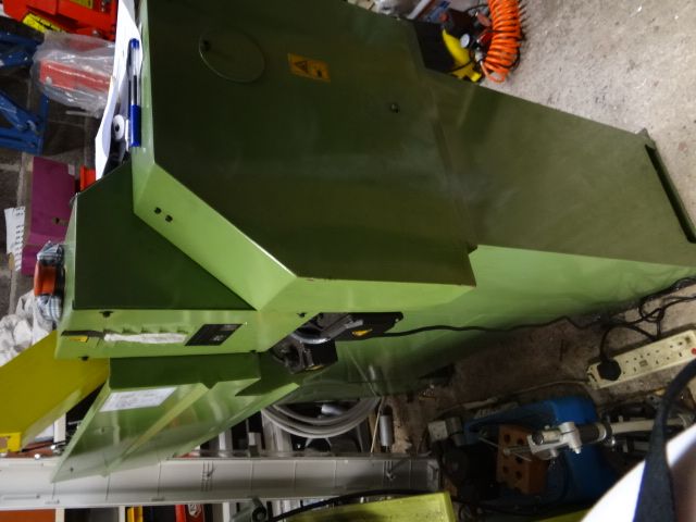

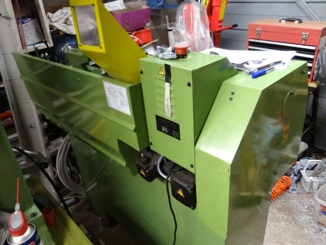

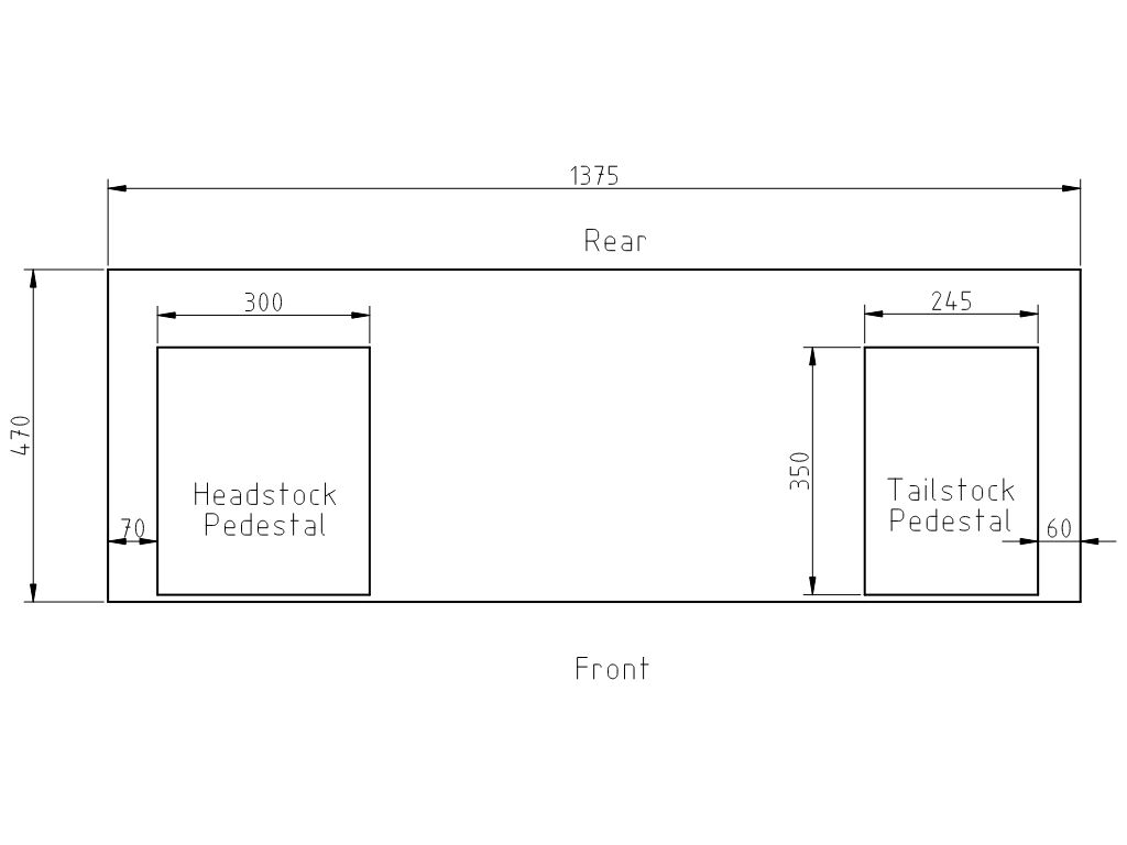

            #514811
              Nothing is ever easy – my tape measure and foot rule have run away together!
              Anyway, assuming my stand is the same as yours, drawing shows how far the tray and backplate overhang the pedestals:
              The backplate, control box, headstock cover and terminals overhang the pedestals by a considerable 110mm. As a picture is worth a thousand words!
              The rear protrudes more than might be expected!
              My plan was to put the lathe against the wall. On the day, due to my crane's turning circle being just too wide to swivel past stuff stored on the other wall, I positioned mine sideways on instead. A happy accident because sideways on gives full access to the rear of the lathe and the gear-change banjo, whilst also allowing longer rods to be fed through the spindle. (In my workshop! Your geometry is probably different!)
              The couple of times I've not had to move the lathe to get inside the control box reminded me how much bother it is to get behind a heavy machine. However, the big winner is being able to get at the banjo from any angle – much easier than when the headstock happens to snugged up into a corner, as I foolishly arranged my mini-lathe.

              #514831
              Neil Moore 1
                @neilmoore1
                Gents,
                Thank you all so much for your replies and advice, Dave's drawing and pictures have provided answers to my question and what I need to do to obtain the correct base dimensions for my lathe base, it has also brought some things to mind that I was not fully aware of, IE access to the control box, better now than later I must say,
                Once again thanks to all who took time to advise a raw beginner to the hobby.
