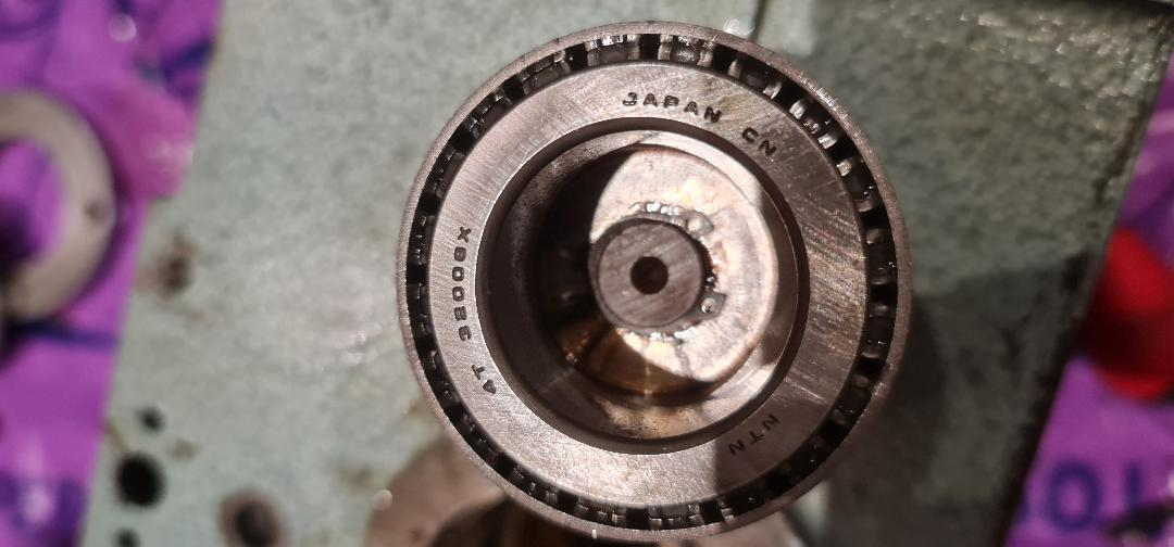

  • #801495
    Sonic Escape
      @sonicescape38234
      I removed the two spindle bearings from an Emcomat 7 lathe. They are tapered roller bearings. I want to buy new ones. The model is 4T 32006x and 4T 32007x. Tapered roller bearings have some kind of tolerance classes like C2, CN, C3 for the normal bearings? How can I select a good quality ones? I saw the price varies quite a lot for the same type from different manufacturer.

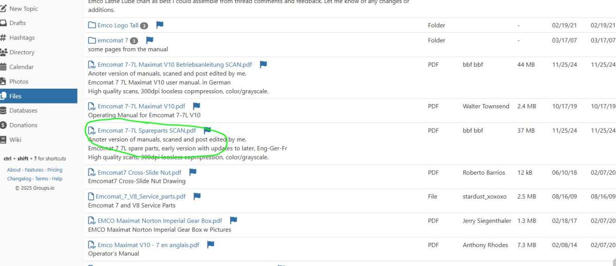

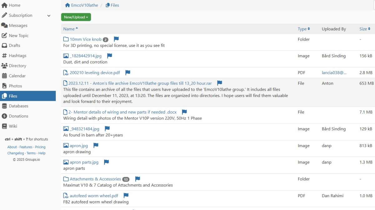

                            #801611
                              As I said go to the Files section. IT IS THERE and has been for 30 odd yesrs since I started using it as a Yahoo group. That is where I went yesterday to look up the bearing spec as XC P6. second or third page has th eparts list and diagram
                              files
                              #801613
                                files 2

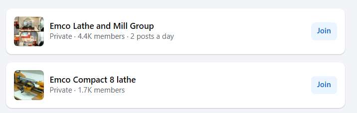

                                      peak4
                                        @peak4
                                        Regarding io groups, there’s also at least a couple of Emco groups on Facebook.
                                        I’ve not joined either, so can’t vouch for their content
