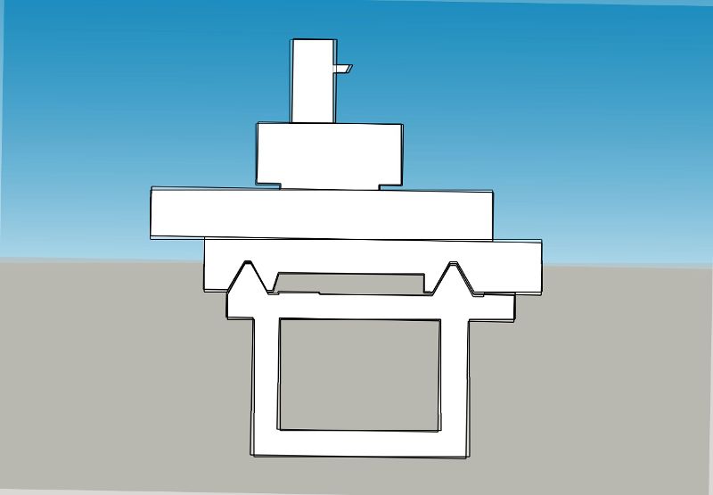

      By accident I came across a video about lathe levelling by means of an engineer's sensitive level. The person demonstrating it took great pains to clean the ways and then place packing on them to create a shelf with which to support the level. It occurred to me that I'd seen similar videos where the level was supported on packing blocks on the lathe ways. But why?
      Why not use the saddle to support the level? It's the saddle that guides the cutting tool, so why not use the level to see how the saddle itself leans because of twisted ways? Using the saddle as the support also allows observation at any point along the bed. Is my reasoning faulty?

          Because you want to "level" the bed itself and not the saddle. Saddle top surface may not necessarily be parallel to the parts that run on the ways. Also, bits of swarf or even oil between bed and saddle ways can give a false reading.
          It's all a bit academic anyway. The only way to be certain that your lathe is set up to turn parallel is to turn a test piece held in the chuck and with no tailstock centre in place and measure it. A level bed is not always a guarantee of parallel turning under load, particularly on a used/worn machine.

                      I think you have a good point here. Normally I would suggest the blocks were to get clear of the V bed ways. Now if the Vs are worn at one end and asymmetrically then levelling on the unworn flats would not actually get you very far. The saddle would be telling you what it was seeing and in the end that is what is really important.
                      Also if your bed is bent like a banana on its side levelling again is a waste of time and the turning test of ends of a bar only doesn't tell the whole story.

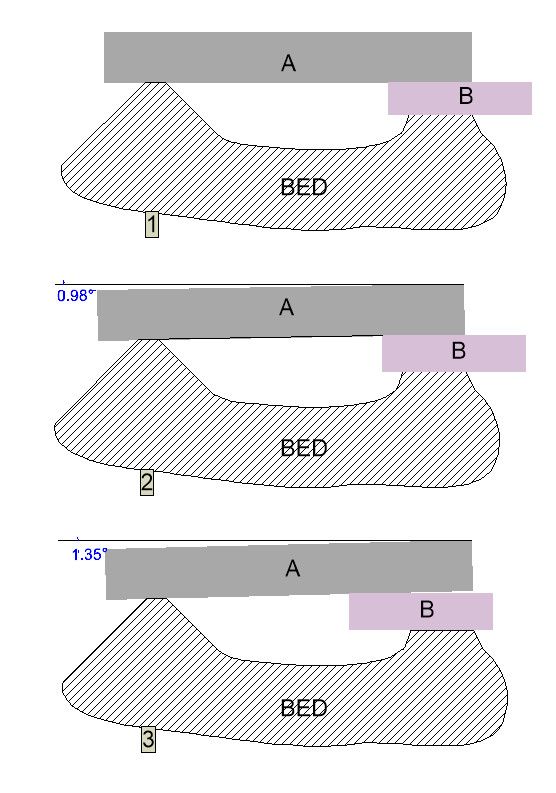

                          Gary, you put a sensitive level at each end of the bed to make sure not that they are 'level' but that they are level with each other. Any pedestal lathe sitting on the floor but not levelled will almost certainly have a twist in the bed. If it's on castors even more likely.
                          Hopefully this sketch will show why you would level a lathe.
                          I've knocked up the above image and laid one over the other but rotated 1 degree to simulate an exaggerated twist in the bed. The images depict the saddle at one end of the ways and then at the other. If you look at the tip of the tool you'll see that it's closer to the 'work' at one end than at the other because the twist has rotated the whole assembly clockwise. This would cause you to cut a taper in your work.

                              Yes, the tall stack but narrow bed lathes suffer the most from twist plus of course they tend to be less rigid in the first place.
                              I don't advocate putting a level on the top of the saddle simply because it will only give you the angle of the saddle, not the way. Anyone who has scraped in the underside ways of a saddle would know that the biggest wear on a saddle is on the front way nearest the chuck – the wear there is going to be more than the wear in the actual bed and it's normal for saddle ways to be worn both ends and 'high' in the middle causing them to rock.
                              For a badly worn lathe that is cutting a taper you might use inducing a bit of twist as a get-you-by mind – some manufacturers actually specify setting a twist to remove taper.
                              Where it REALLY gets complicated is for lathes like Colchesters which have adjustable headstocks via the rear-end jacking screws. You could get into a horrible situation where you adjusted the headstock to correct for cutting taper in a part when thee cause was actually the bed has a twist. Now you have adjusted the headstock out of axial alignment with the tailstock so you'll be drilling off-centre and causing reamers to cut on one side.
                              If you're going to work on your lathe alignment the first thing you do – the very first thing, is level the bed.

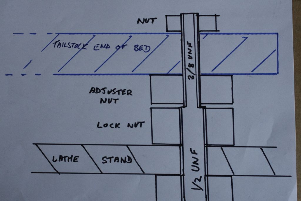

                                        I decided to make the levelling of the Atlas 12 X 24 user friendly at an early stage of its clean up and refurbishment. I had an unused block of aluminium 1 1/2" thick to fit under the headstock end which would give enough height to add adjustment to the tailstock end. This rough diagram shows what was done.

                                            I did the same thing as Old Mart with my ML7 when I had it. Made removing twist SO much easier. Used exactly the same method when the bigger ( BL12-24 ) machine arrived, co incidentally, using 1/2 UNF setscrews and nuts, at both Headstock and Tailstock ends.. Unlike the ML7, iIt did not need to be raised.
                                            Raglans made life so much easier, by only having one fixing at the Tailstock end

                                              Well, after reading the comments I'm convinced that I'm right. My original post was only about levelling the bed – not about headstock and tailstock alignment. The objective of bed levelling is to ensure that the position of the cutting tool tip relative to the lathe axis remains constant as the saddle moves along the ways.
                                              I really can't see why supporting a level on temporary blocks is more accurate than supporting it on a purpose-made block – ie. the saddle.
                                              The diagram shows a level, 'A', supported on a raised 'V' way and a block, 'B', resting on a flat way. If the height of block 'B' exactly matches the difference in height of the two ways (as in '1&#39 then fine, but rather unlikely. If it doesn't, then the horizontal position of block 'B' can have a noticeable effect on the orientation of 'A', as can be seen in the difference between diagrams '2' and '3'. Can you be certain of precisely positioning block 'B' for each measurement? I think not. But by using a purpose-made block (ie. the saddle), the uncertainty is completely eliminated.Once the best position of the level on the saddle has been found, then you just leave it there and wind the saddle along the ways to take the readings.
                                              It's how the saddle rides the ways that's important.

                                                If the Headstgock and Tailstock are not correctly aligned, turning between centres will produce a taper.
                                                (Deliberately offsetting the Tailstock centre is used as a means of turning a taper )
                                                If the Headstock is correctly aligned with the bed, work held in the chuck, but without Tailstock support should be turned parallell, AS LONG AS THE BED IS NOT TWISTED.
                                                If the bed is twisted, the Headstock and Tailstock are unlikely to be correctly aligned at all points along the bed. They may be centre to centre at the Headstock end, but a twisted bed will mean that they move out of alignment as the separation increases.
                                                If the bed is twisted, the position of the cutting tool will vary, in both planes, as the Saddle (Which you assume to be perfect ) progresses along the bed, to the detriment of parallelism and probably surface finish.
                                                If (1 ) is at the Headstock end, and (3 ) at the Tailstock end of the bed, your illustrations make the point very nicely.
                                                In particular, Myford, who started making lathes, originally based on the Drummond (dating from just after 1900 ) have only been making lathes for some 80 or 90 years, would not advise levelling the bed to eliminate twist, unless it was necessary.. They do not mention using the saddle as a datum.
                                                It does not matter if the level, and its supports, resting on the bed, are not horizontal, as long as unworn sections are used for consistency, (Immediately beneath the chuck, and behind the Tailstock are unlikely to be worn )
                                                What matters is that the level reading is the same at both ends, showing that the bed is not twisted.
                                                Working off the Saddle introduces further possible sources of inaccuracy, and error.
                                                Whether the bed is hogging or sagging is a different matter!.
