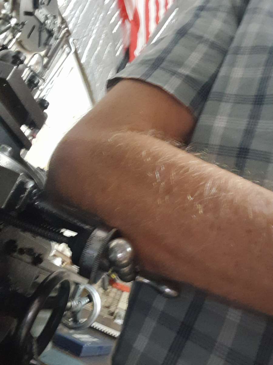

                          halfnut
                            @halfnut
                            What works for me. And by fortuitous good fortune, this height puts the lathe spindle centreline at exactly the distance where I hold my phone to read Bayzle”s excellent point in his  message above.
                            20250429_202405
                            In reality, there is only about a half inch difference between the aforementioned top of the cross slide and the centre of its handle/ screw. And under 2 inches difference between top of cross slide and spindle centreline, so much of a muchness really.
