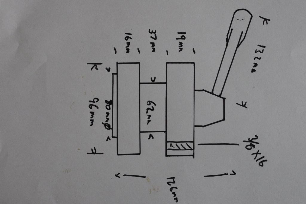

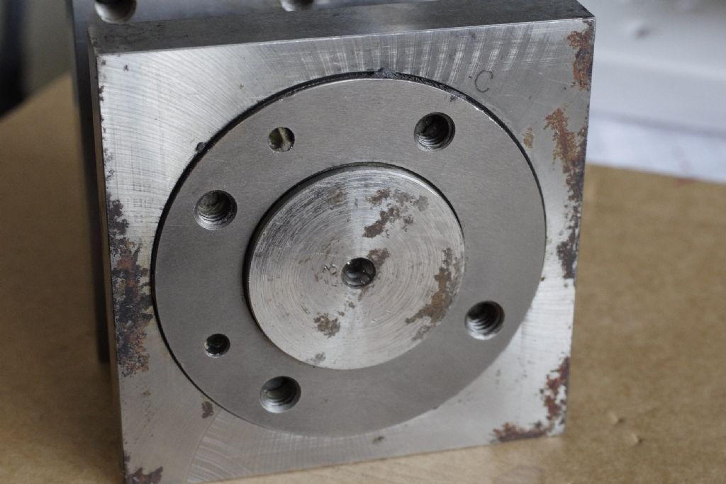

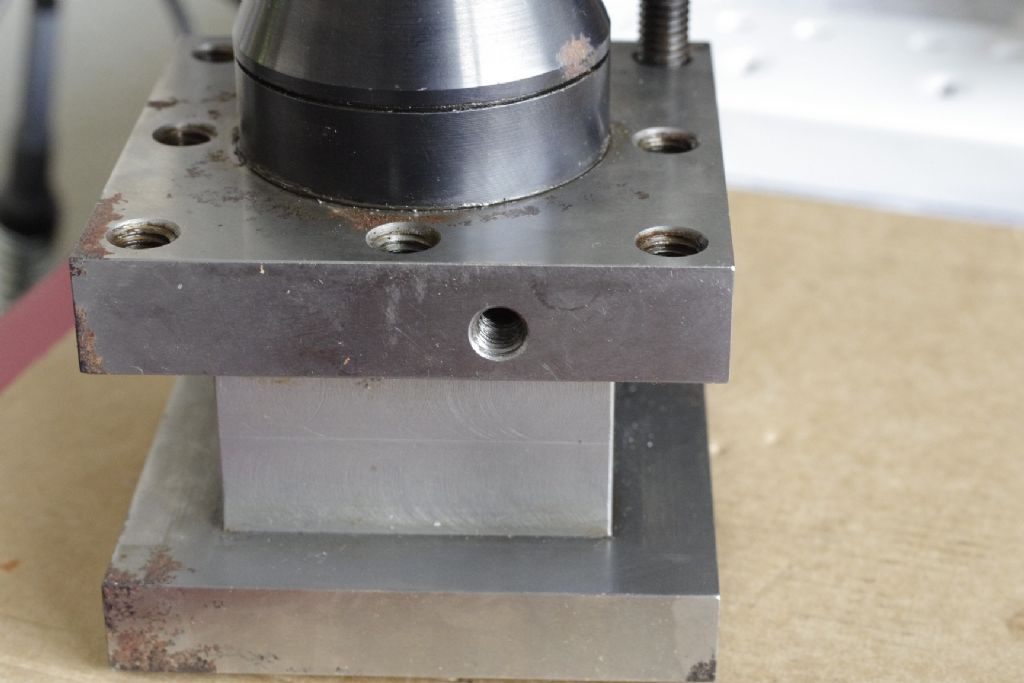

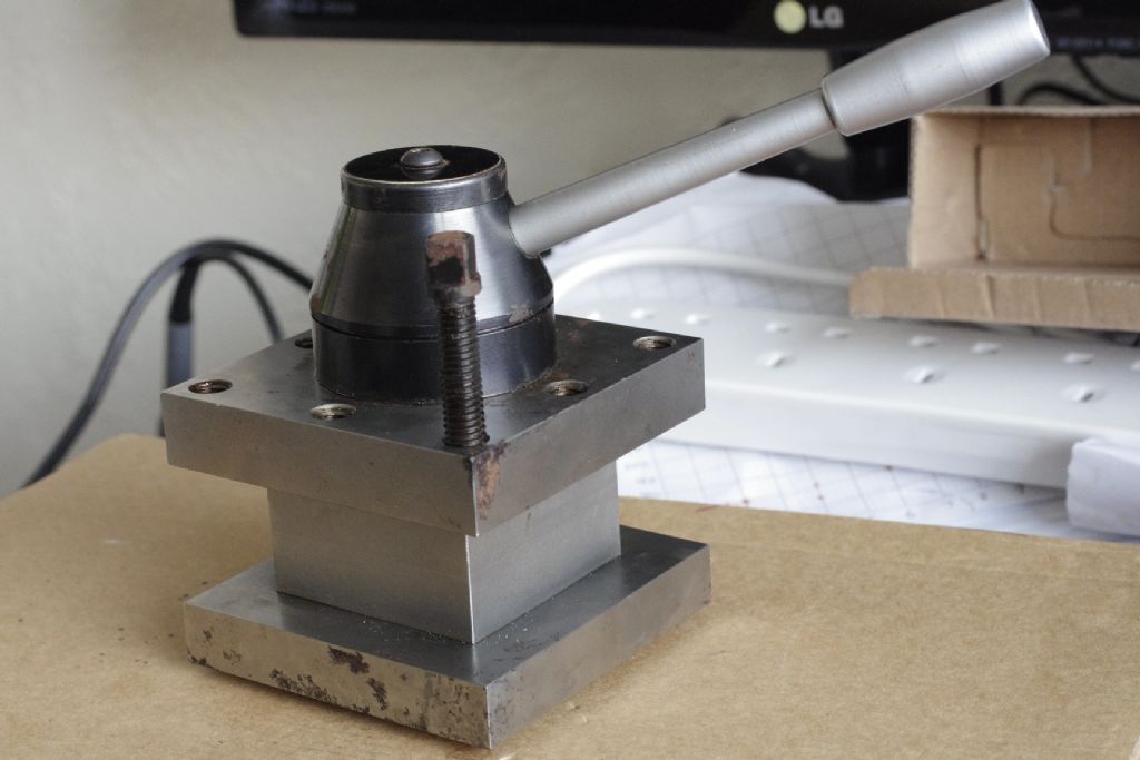

      _igp2585.jpg_igp2578.jpg_igp2577.jpgI bought a 4 way toolpost on ebay the other day, it turned out to be bigger than expected. There was very little information about the toolpost from the seller, and I thought I could tell the size. Fortunately, it went for a very low price and I am deciding if it can be used on the Smart & Brown model A at the museum. It could fit directly to the cross slide in place of the compound slide, to add stiffness, or as a rear toolpost to use with larger boring bars. A 20mm square tool fits easily, and 25mm size would as well. I haven't been able to take it to bits yet, maybe someone will know how to. The eight clamping bolts are 3/8" 16tpi, with 3/8" square tops. The four threads in the base are a bit of a mystery, too big for 1/4" and not big enough for 5/16", the only thread left would be 7mm which is rather rare.
      Here are some pics:

        #467013
        Howard Lewis
          @howardlewis46836
          Biased, but my choice would be as a rear toolpost.
          Howard

                Posted by old mart on 25/04/2020 15:45:42:
                … The eight clamping bolts are 3/8" 16tpi, with 3/8" square tops. The four threads in the base are a bit of a mystery, too big for 1/4" and not big enough for 5/16", the only thread left would be 7mm which is rather rare.
                Could they be 9/32nd BSF? (A little over 7mm, but imperial like the others.)
                #467439
                old mart
                  @oldmart
                  I have solved one part of the puzzle, the threads underneath are 5/16 UNC. I made an impression of the threads and found the pitch to be approximately 16 to 18 tpi. That definitely narrows it down to BSW or UNC. I had tried what was probably a BSW bolt without it screwing in, but today I had another search of the garage and found a bolt with the nuts on it. The nuts were too small for BSW so it is probably UNC. It is a tight fit, but screws right to the bottom of the hole. Not being able to get to the workshop at the museum because of lockdown is a handicap.

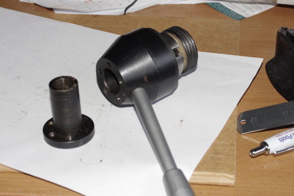

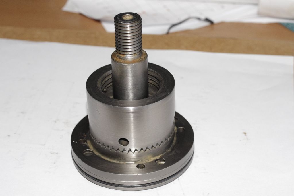

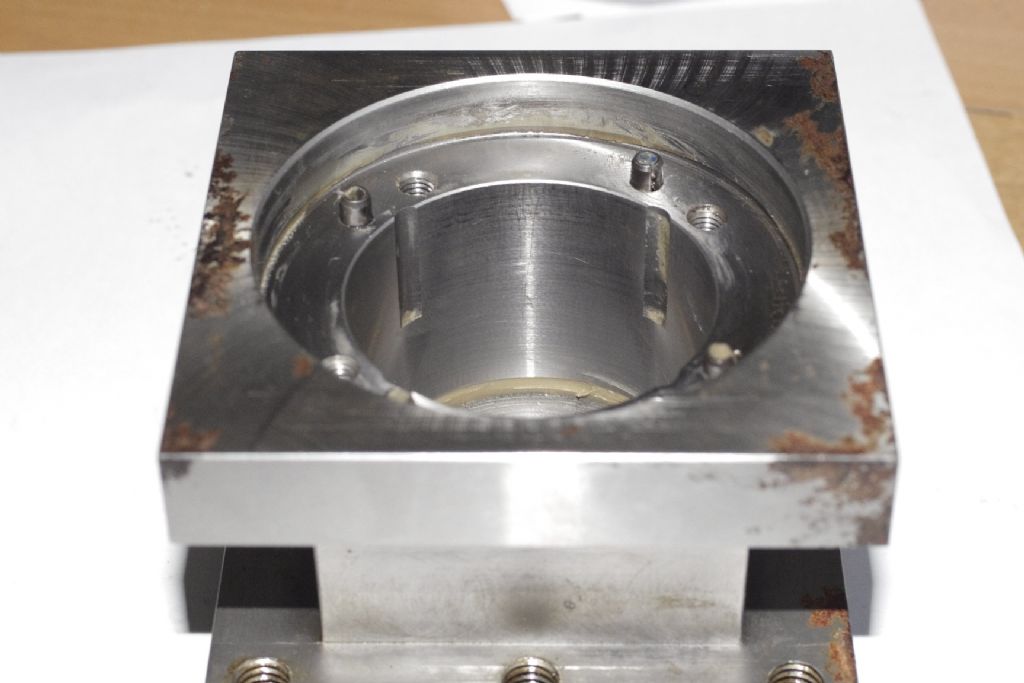

                    If anybody is interested, I have succeeded in getting the toolpost to bits, pictures of its guts here:
                    **LINK**
                    #467699
                      Posted by old mart on 28/04/2020 20:22:40:
                      **LINK**
                      I would be interested, but every image link there returns:
                      Invalid File Specified
                      … So presumably one needs to be a member
                      #467839
                      old mart
                        @oldmart

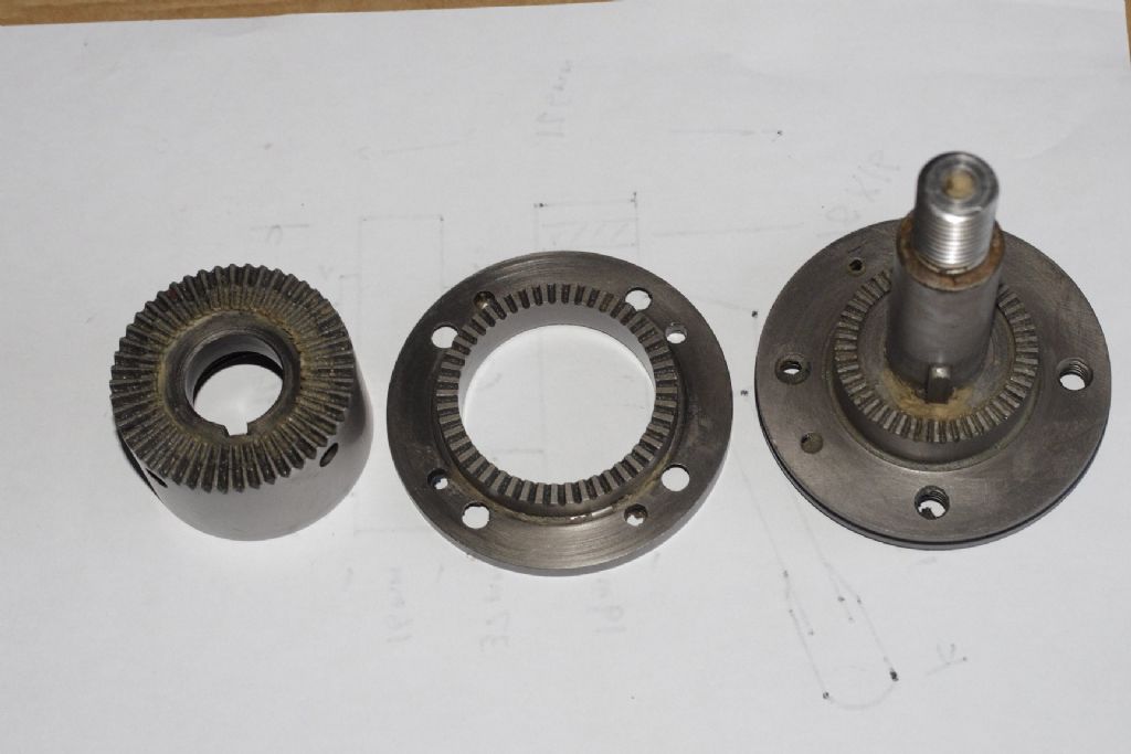

                        _igp2590.jpg_igp2589.jpg_igp2588.jpg_igp2587.jpgSorry, I forgot that their new format won't allow viewing unless logged in, I hope it can be remedied.
                        Here are the pics:
                        #467840
                        old mart
                          @oldmart
                          It is a clever design using a hurth coupling to align and spring loaded balls to hold the post while the coupling is being tightened down. I think the post can also be locked in any of the angles allowed by the number of coupling teeth. Differential threads in the central column and at the bottom of the toolpost lock and unlock the post. The internal parts which have to be realigned are marked as such.
