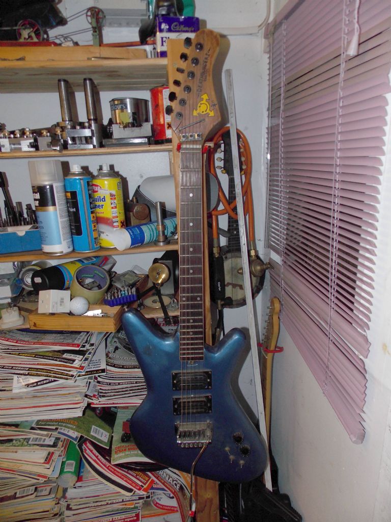

                      I know I'm going to regret this… my only defence is that, at the time I made this I didn't have a workshop of any kind
                      It is far too heavy and clumsy, the string clamp at the nut and the bridge are poorly set up. The body was hacked out of several layers of cheap ply, probably using a rasp, and the finish general appears to have been chewed by an arthritic dinosaur. The pickups could be better placed (nearer neck and bridge).
                      I found the neck in a skip, bought the pickups, knobs and tuners and my brother gave me the bridge and its ancillaries after removing them from one of his guitars. The no-name neck is the best part of the guitar!
                      On the back of the headstock it says "A tradition of fine craftsmanship since 1993. Steel reinforced body, recycled neck." The steel reinforcement is several big nails holding the layers of plywood together.
                      I have many lovely and beautiful musical instruments – this is not one of them.

                        If the neck is from a different guitar, is the scale length correct, how is the intonation, the distance from the nut to the 12th fret should be the same as from the 12th fret to the bridge.
                        the bridge pickup would be better about 1 1/2" in the mid point from the bridge and the neck perhaps about 4" from the bridge, but there is no specific dimension, its all a matter of how you like the sound, the closer to the bridge gives a brighter sound and closer to the neck a more mellow tone.
                        I think the better wood for bodies is hard maple which gives a good sustain.
                        Ron Mc

                          I made the body to suit the neck, and the scale length is 25" give or take, and the intonation is spot on – I can set up guitars, I'm just not very good with wood or paint!
                          If I find a better piece of wood (some lime/basswood perhaps, maple sounds like hard work), I'll carve out a new body and try again. I actually really like that shape, and the neck is surprisingly forgiving, so it COULD be the basis of a half-decent instrument.
                          I think if I revisit it I'll more or less copy the SG pickup positions. The big problem is that flashy micro-tuning bridge, the whole setup is meant to give accurate and stable tuning even when you use the tremelo arm. Actually it goes out of tune as soon as you look at it, my brother ended up jamming a block of wood behind it and using it as a fixed bridge before replacing it with a standard unit, if I recall correctly.
                          I suppose now I have some half-decent metal-mangling skills I realise I could make a fixed bridge – I have an SG style bridge retrofitted to another guitar than I can copy, I don't like the Tele-style bridges much (that's a Squier tele in the corner), or just fit a new fixed backplate to that bridge. Either way a new body could be a bit thinner, I like light guitars.
                          As well as a banjo elsewhere, that's a banjo mandolin awaiting a second restoration some thirty years after my first attempt hiding at the back.
                          So many projects, so little time…
