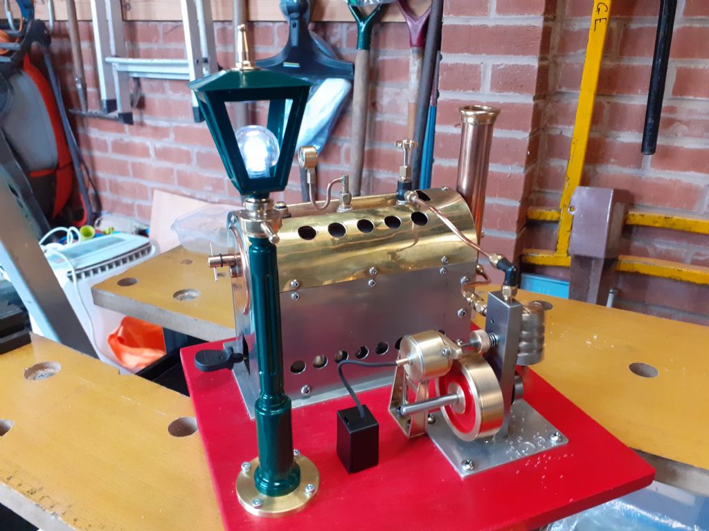

                    This is my version on lamp post steam powered lighting copied idea from Nigel. Had to find a reason to run wobbler engine.
                    David

                                  img_3841 (small).jpgimg_3840 (small).jpgWell I've got started. Here's the lantern. Many thanks to David George for supplying th generator and a press tool for the top. Got to find a better LED, all mine have a built in lens to the light goes primarily up, which isn't what you want. I suppose I could put an angled mirror inside, but then would only shine one direction.
                                  Anyone tried glazing the lantern? My mobile phone screen protector was advertised as 'tempered glass' which might be more scratch resistant than polycarbonate

                                    I used glass in the lantern, the glass came from old 35mm slides – there is a posh version of the slides where the film gets sandwiched between two thin pieces of glass.
                                    For the light I turned a perspex bulb that the LED goes into, you could add some silver paint inside at the top of the hole that the LED fits into.

                                      nearly there. I spotted a Stuart Williamson engine that I made over 30 years ago, too good to pass up. All I need to do now is find an LED that shines sideways all round, all mine have a 'beam' out of the end, so at present it's bent over and directed in one direction. The the dreaded painting.

                                        Duncan,
                                        Try dimpling the end of an LED with a drill point, thus forming a conical concave. It should spread the light sideways.
                                        I think Big Clive **LINK** mentions that they are available (in that form) over the counter. However, without wading through his many videos I can't say where.

                                            you could machine some perspex into a lightbulb shape, drill the centre to take an LED and leave the inner surface rough so that it diffuses the light from the LED
                                            Perspex bulb
                                            This is actually using a flickering LED – if you go on ebay these LED's are quite cheap and replicate a flame – used quite a lot in dioramas
