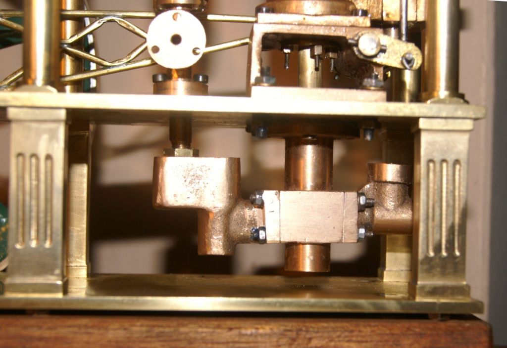

          john carruthers
            @johncarruthers46255
                 No worries Ian, how else will I learn
                 A few more fiddly jobs done today. Next step; the governor….
                 New side rods too, I wasn't happy with the first pair, a bit sloppy and the valve needs all the motion it can get.

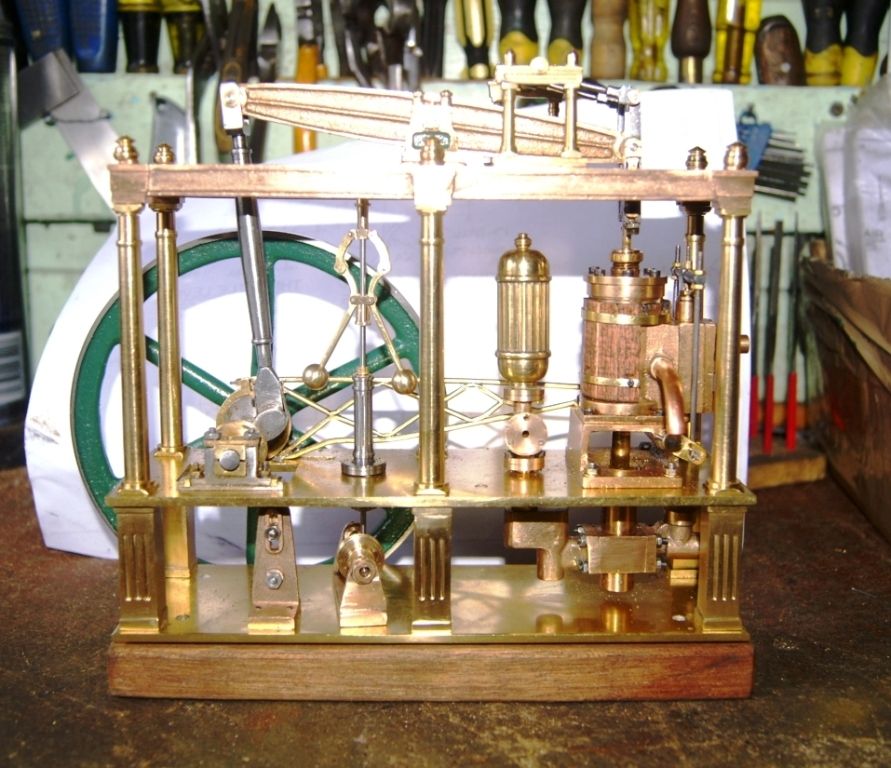

            john carruthers
              Every week a little further.
              I can't do much more until I make or buy some bevel gears.
              Got the governor pulleys and pedestal made, then lagged the cylinder.
              I may start the governor arms, the drawings call for 14BA threads but I shall use a 1mm tap and die I have already.

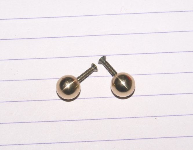

                    john carruthers
                      I looked at the price of 7/16" PB balls and decided to have a go myself.
                      I made up a radius tool some months ago and set it up this morning.
                      Everything worked as planned; almost, only had to throw two away.

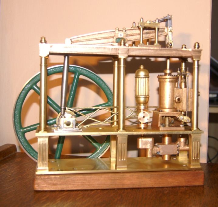

                      john carruthers
                        The governor is mostly done now, it still needs the bevel gears, a throttle and linkage.

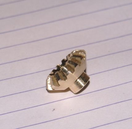

                        john carruthers
                          My first attempt at a bevel gear, 15T, 32DP.

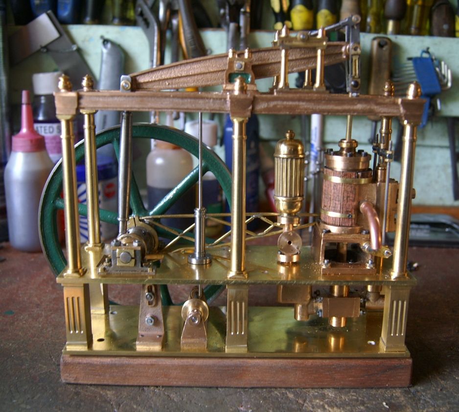

                            This week I put the flutes in the columns and cut out the side panels.
                            I still have the panels to decorate and a throttle to make. (and replace the rubber band with a better drive belt).

                                Here she is running, 95% completed, just the base to make and maybe engrave the side panels, we shall see.

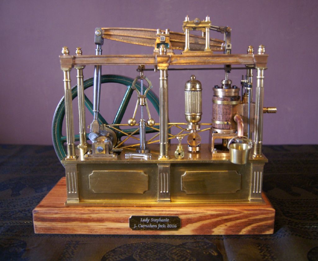

                                john carruthers
                                  Last one I promise.

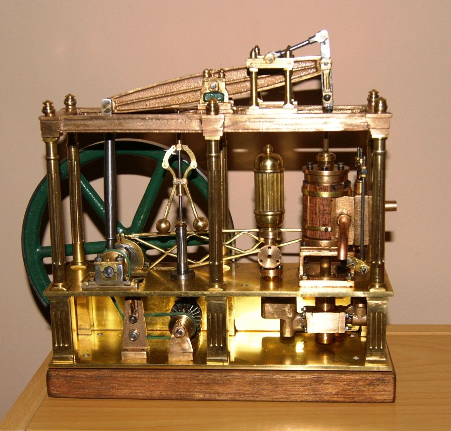

                                  Finally finished Lady Stephanie, (the spanner is engraved 'Snap-off Tools' ) laugh
                                  What next? a simple clock? a miniature lathe?….

                                          john carruthers
                                            Yes, I've seen some with a simple link, I was just sticking to the drawing this being my first 'real' engine.
                                            I went up to Kew to see the Dancers End engine it is loosely based on, excellent day out.
                                            I know what you mean about the polish, I have a thing for brass and wood.
