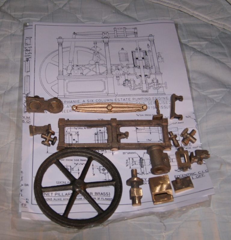

                      Thanks Bob, I saw your video when I was researching the project.

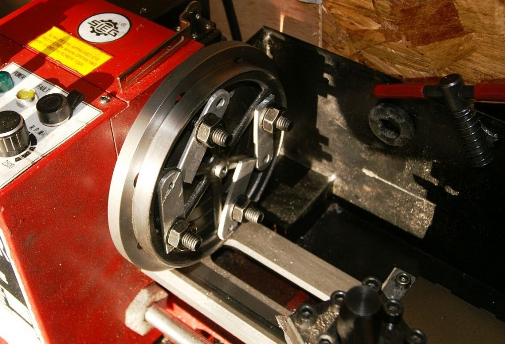

                      Progress so far; filed up and drilled the entablature and beam. I would like to centre the beam bosses on the holes. I can't swing it so I'll make a little annular cutter.
                      The flywheel had some horrible hard chills, sparks flying off in places. Still got to clean up the spokes, might get a carbide burr as even my best files won't touch them.

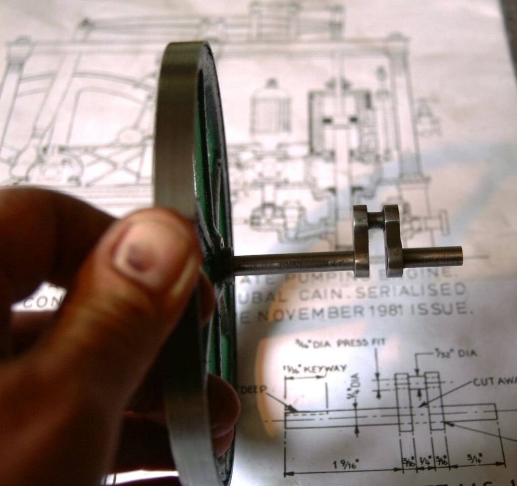

                                I've acquired a diamond file and tidied up the flywheel, just needs reaming now and a keyway cut.

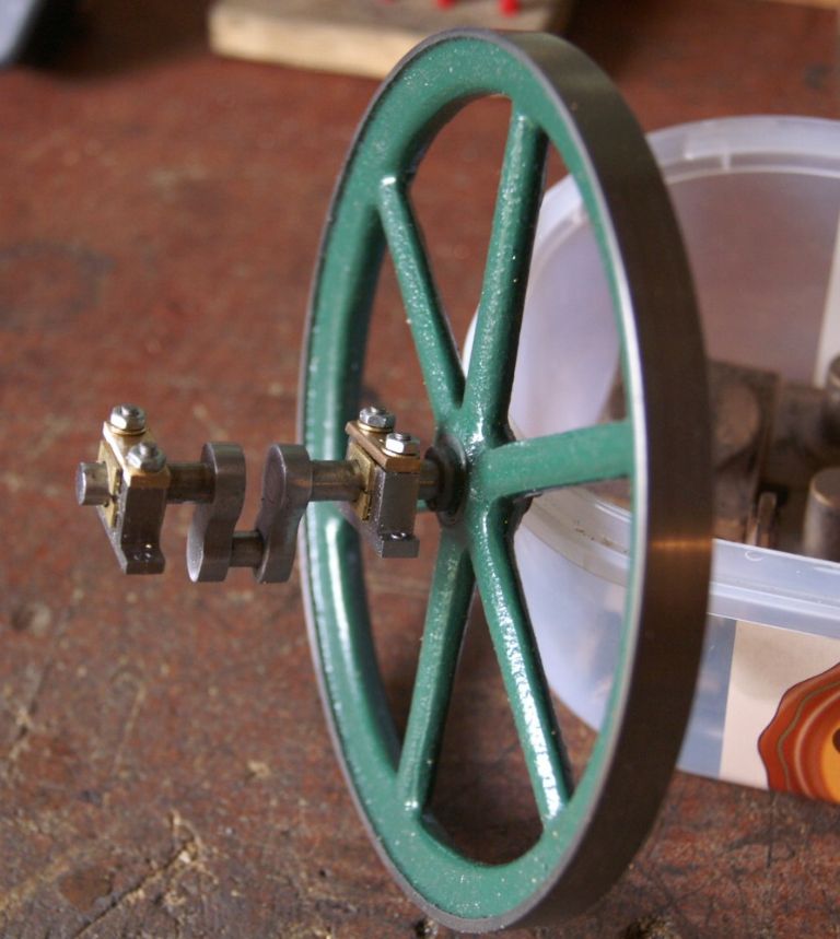

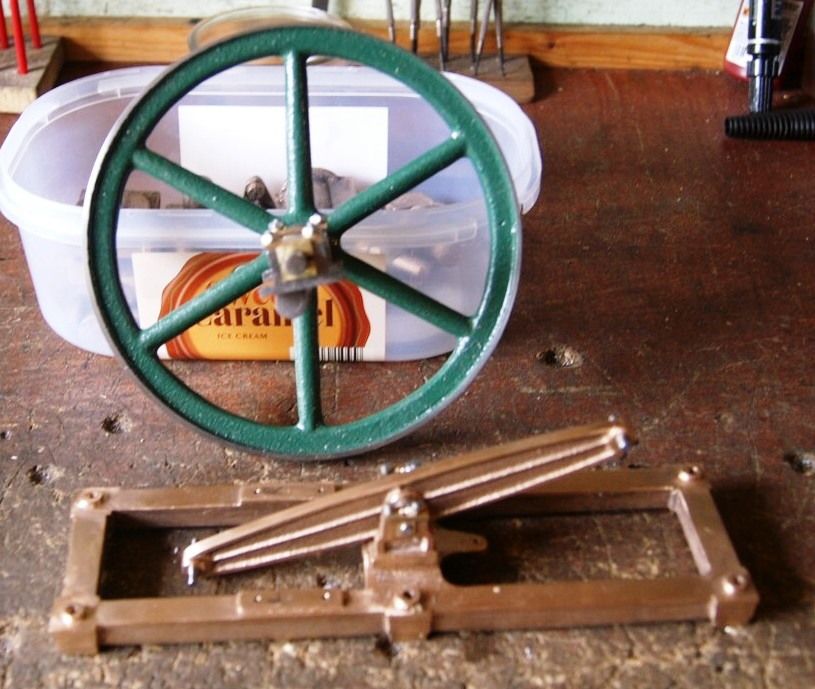

                                      Crank done (loctite and 1.5mm pins) and the flywheel.crank and flywheel

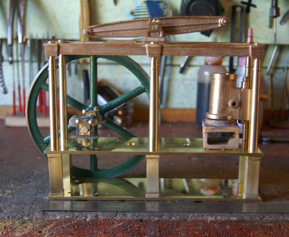

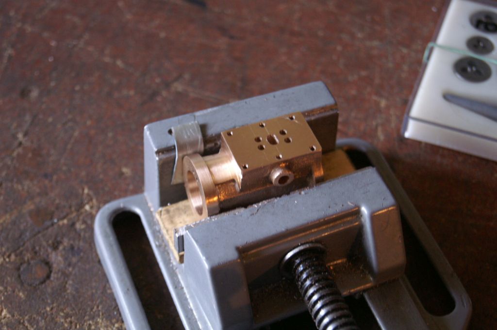

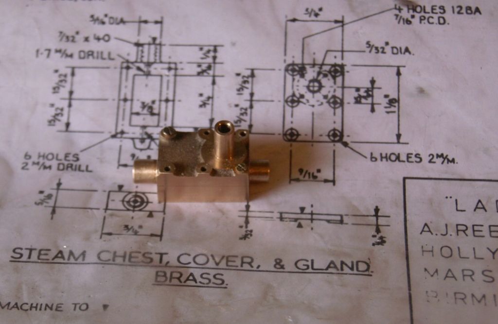

                                        crank bearingsbeam fittedGood progress today, made the beam pins and bearings, finished the crank bearings, machined the steam chest except the 4 flange holes – have to make a drill jig for them so all fit the same.
                                        steam chest

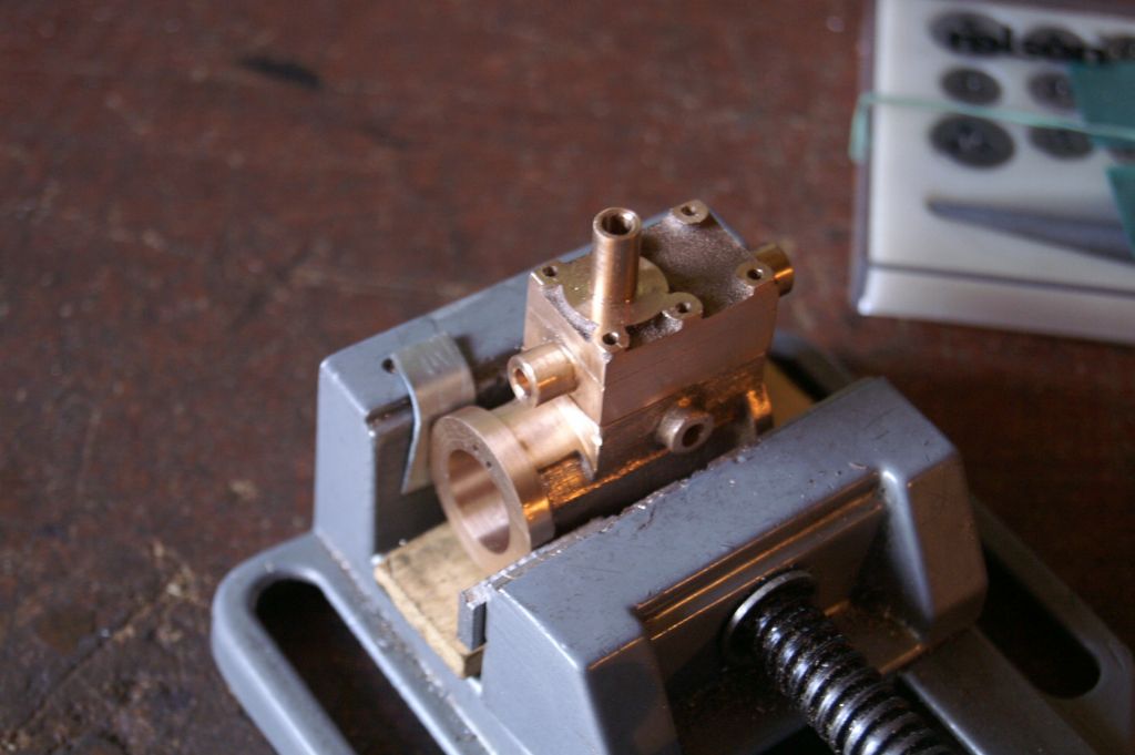

                                          cyl st chest.jpgGetting there, one piece at a time; cylinder bored a thou under size to allow for honing, and the steam passages drilled.

                                            Steady progress….
