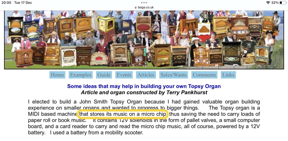

          I was amused to see this:
          IMG_0406
          In fact, the file opened almost instantaneously on the iPad
          Moore’s law is demonstrated !

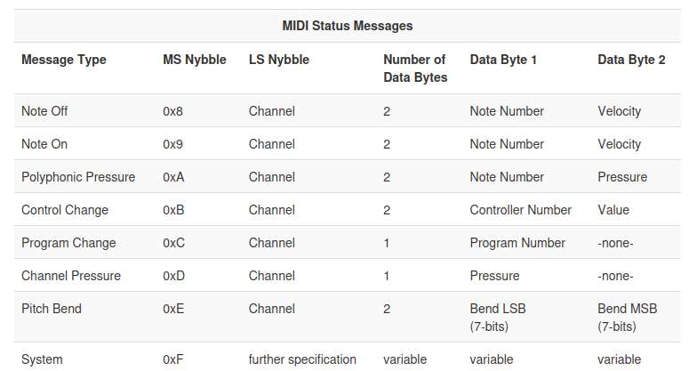

                    Michael’s link to the hobbytronics website is mildly interesting until at the end it includes another link to Sparkfun’s rather good technical description of what  MIDI is and how it works.
                    Briefly, MIDI is a serial protocol allowing messages to be sent from a digital device to a controller rather in the same way as CNC works with G-code. I think Sparkfun’s description is enough to allow an amateur to implement a MIDI controlled wotsit, not that I recommend that route except as a programming challenge or to do something special.
                    This table gives a flavour by listing MIDI status messages:
                    midi
                    A basic tune can be played merely by sending sequences of “Note On” and “Note Off” messages, and these alone might be enough to work a Topsy with a basic controller that ignores everything it doesn’t need that arrives in the MIDI message stream.    Thus a MIDI file containing complex sounds would still play, but without and bells or whistles!   A quick read suggests playing two or more notes together, as in a chord, is done by setting channel numbers, so a DIY Topsy controller should probably support these too.   Commercial MIDI works in the same way – anything the controller doesn’t understand is ignored, so don’t expect inexpensive controllers to do everything.
                    I guess Duncan needs a MIDI keyboard program on his PC, or – even better – a MIDI keyboard.  This allows tunes to be played by the musician.    Duncan also needs a MIDI decoder, that translates MIDI messages into a bank of ON/OFF switches.   My first thought was DIY Arduino, but the MTP-7 device identified by Duncan looks good to me.  All the hard programming is done, the electronics built, and, unlike an Arduino, which has low-power outputs, the MTP-7 can switch 35V at up to 500mA.   A midi keyboard could be plugged straight into it, no need for a computer, though playing via a MIDI program on a PC would allow tunes to be recorded and edited.   Only 32 outputs though – is that enough? If not the MTP-8 has 64 and the MTP-9 128 outputs.

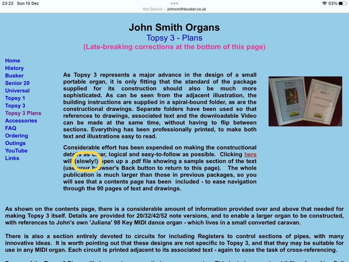

                                                Duncan having declined to provide a simple ‘black-box’ schematic of his Topsy Organ … I have been digging-around in the hope of actually being able to help.
                                                Imagine my surprise when I found this:
                                                IMG_0409
                                                [the yellow highlight is mine]
                                                This, if accurate, would appear to be a game-changer in the quest to find suitable software.

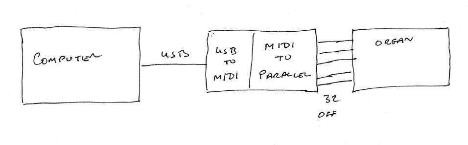

                                                    as it’s Xmas (well just after), and to keep Michael happy. here’s a schematic. I don’t see that it adds anything to my words of 14:00 16 Dec, or indeed my original post. Michaels link of 17 Dec is, at least in my case, wrong, the midi data is stored on the hard drive. I contacted Mel Wright, who arranges music for these little organs, he had no suggestion on software but pointed out that the pipe tuning scale given by John Smith in the construction book bears little relation to the Alan Pell scales which Melvyn uses, which explains why I’ve had issues finding music that will play, so I’ve got to retune half the pipes. I dug out my electronic tuning whizzbang only to find that I’d left the batteries in and they have rotted and taken the battery connectors with them, so I’ve had to dismantle it and solder on some fly leads. Then we had the chaos of Xmas. I’ve tried the Topsy Organ Forum, but it seems to be having a melt down and won’t let me log in. I also tried J-omega, but they had no suggestions. In the meantime I think I’ve found the answer to my original question, but can’t check till I sort the tuning. I’ll report back when I’ve done it.
                                                    Screenshot 2025-01-01 160812
                                                    #773913
                                                      Thanks for that clarification, Duncan
                                                      Clearly ‘Topsy’ came in more than one variant.
                                                      [ years ahead of her time ]
                                                      Am I now correct in assuming that the hard-drive to which you refer is part of the computer AND that the system as drawn is used in real time [i.e. your version of Topsy is just a MIDI device ?]
