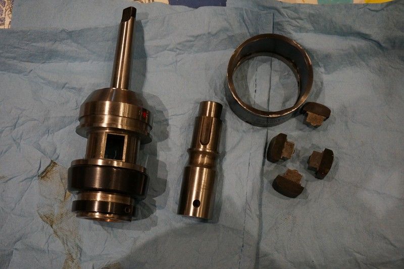

      Has anyone got one or any experience of using one?
      I bought a set off ebay its arrived and looks mint I would say its not been used
      However on first try a new presto 8mm tap broke which I was dissapointed with
      Putting a piece of mild steel into the holder and starting my drill press @40 rpm
      theres no way i can cause it to stop turning with a 12" set of stilsons on the shaft of the mild steel
      the adjustment is on minimum
      after looking at the rubber/neoprene buffers they appear solid not plient at all
      Is this whats wrong…the rubbers gone hard?

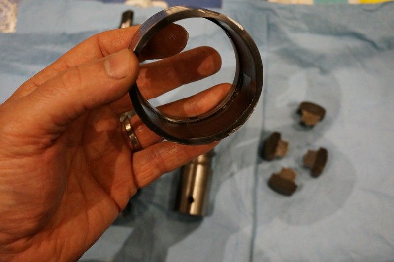

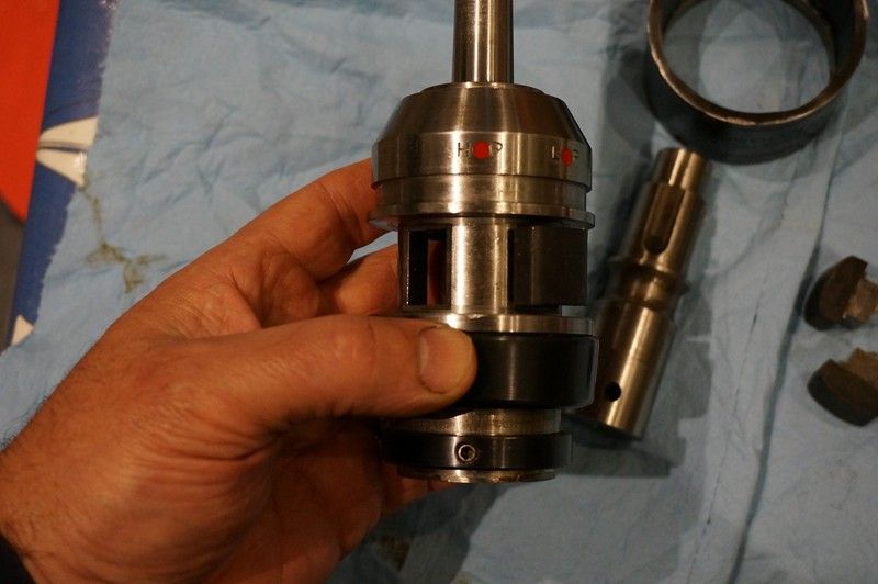

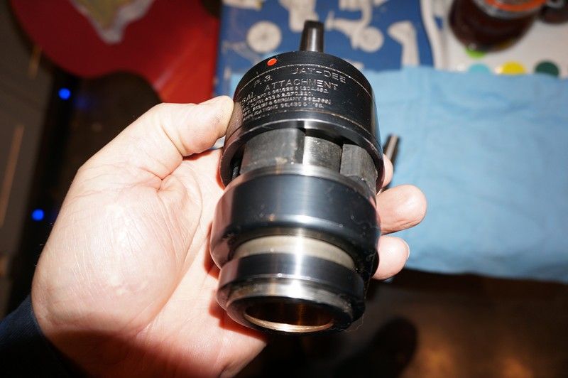

          Can anyone see anything wrong with these bits

            Found this reference to someone who had picked one up at an auction.
            **LINK**
            He says there is a direct drive insert for drilling without removing the tool and then torque limiting inserts for tapping. So the question is do you have the drilling insert with the drive dog on the end inserted?
