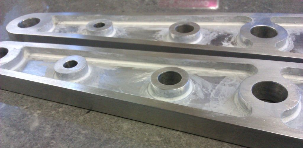

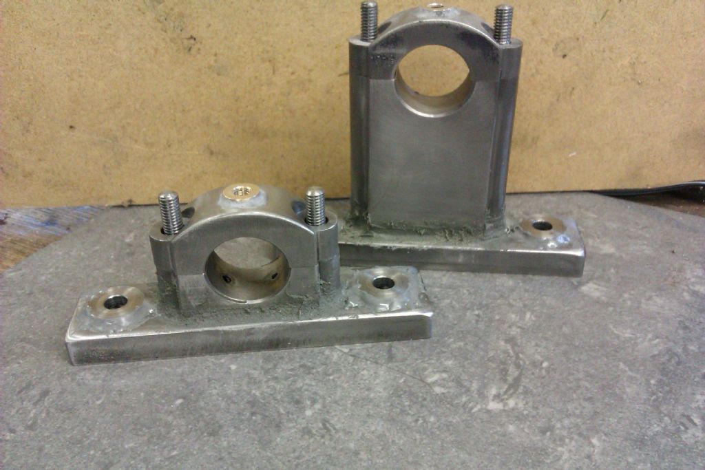

                                #105953
                                  If you don't need the high temp then you may be OK I don't know how the others set and if they are as machinable, never tried the others. Also the 24hr one has a 65% higher tensile strength so if bonding parts even if they do not get hot the 24hr will be stronger.
                                  Really depends on what you want to use it for as you could get away with a car body type filler or one of the putty types whic can be formed more into a fillet and need less work when set. These fillets were done with Milliput and needed no work once set but they are onlydecorative and not structural.
                                  I do find that if you are making large fillets the JBW can slump a bit and in that case I use something a bit thicker like plastic metal, you can se I have used it here to form the fillet around the main block but JBW for the smaller parts which were stuck with it and the fillet formed from the excess, the blocks are also screwed so the filler is only cosmetic.
                                  J
