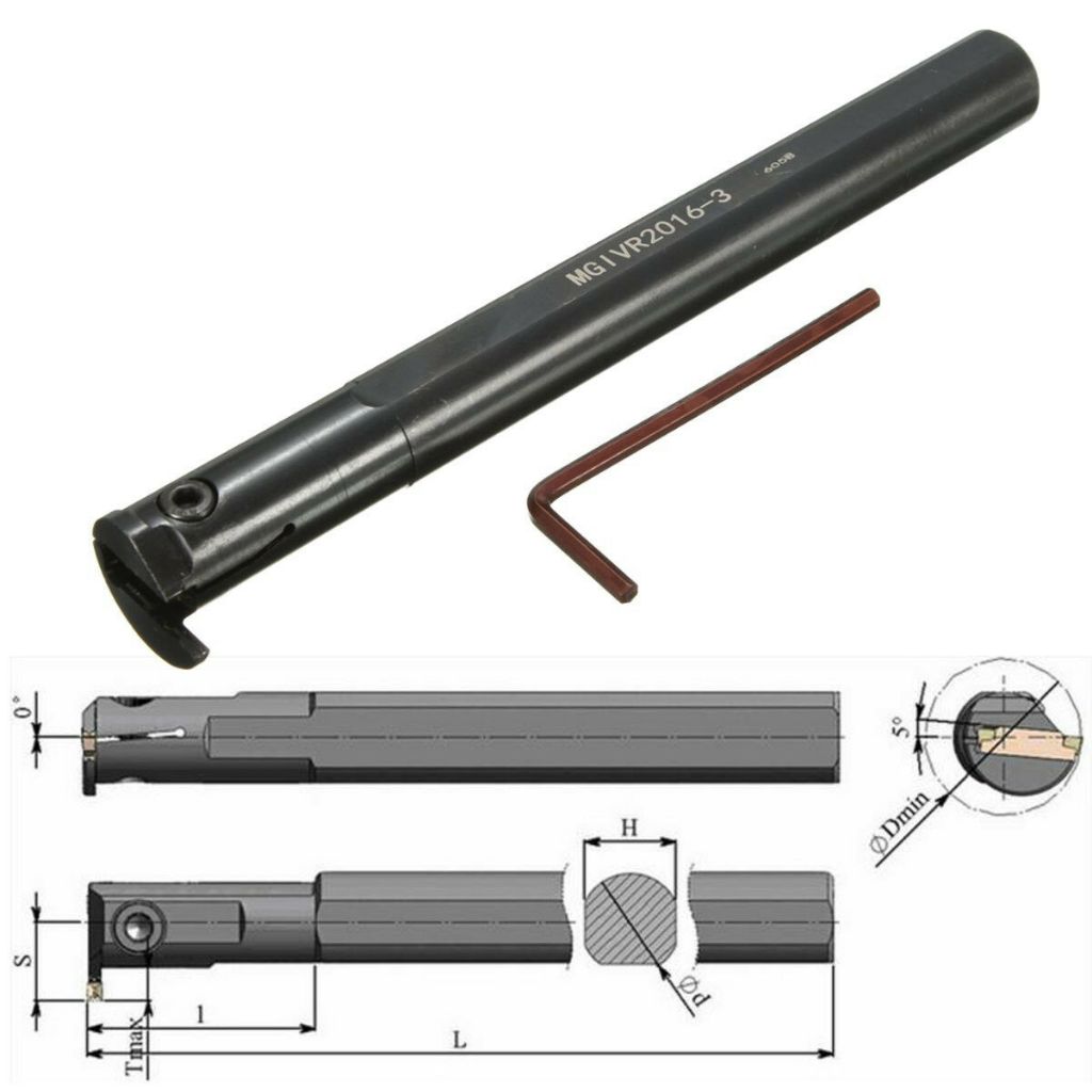

          Paul Lousick
            @paullousick59116
            What about one of these ? AU$15.94 on ebay.
            Paul

                    My first choice would be a tool similar to the one shown by Paul, and it can be in HSS: a standard boring tool. Ensure the face of the tool is parallel to the axis to give the groove equal depth along its width.

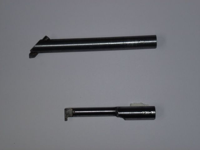

                        p1020542.jpg A couple of home-mades that can cut close to a blind end. One is made from 3/8" silver steel by offset turning in a 4-jaw independant chuck followed by filing and hardening. Silver steel nowadays seems a rather under-valued material for cutting tools but it's fine with proper use.
                        The other tool has a 3/16" dia toolbit. This is clamped by drilling the bar lengthways and inserting a clamping rod which is tightened by a grub-screw accessed from the mounting end of the bar. A G H Thomas design for his boring head IIRC.

                          You can also use they style shown by Jeff and myself that is drilled for most of it's length and has a grub screw at the "blunt end" that pushes a rod that in turn bears on the tool. This needs very little clearance at the end and is also said to damp vibration.
                          Or you can slit the end and use a screw that goes top to bottom to clamp the cutting bit.

                                The grooving insert holder in Pauls post is for MGMN inserts which are commonly available widths of
                                1.5, 2, 2.5, 3, 4 and 5mm. Each width has a dedicated holder, and the inserts also fit in left and right handed parting off tools. I believe the grooving tool shanks only go down to 16mm, limiting the minimum hole size and are too big for smaller lathes. The tips are commonly Chinese, but Korloy also make them. The inserts are double ended.
