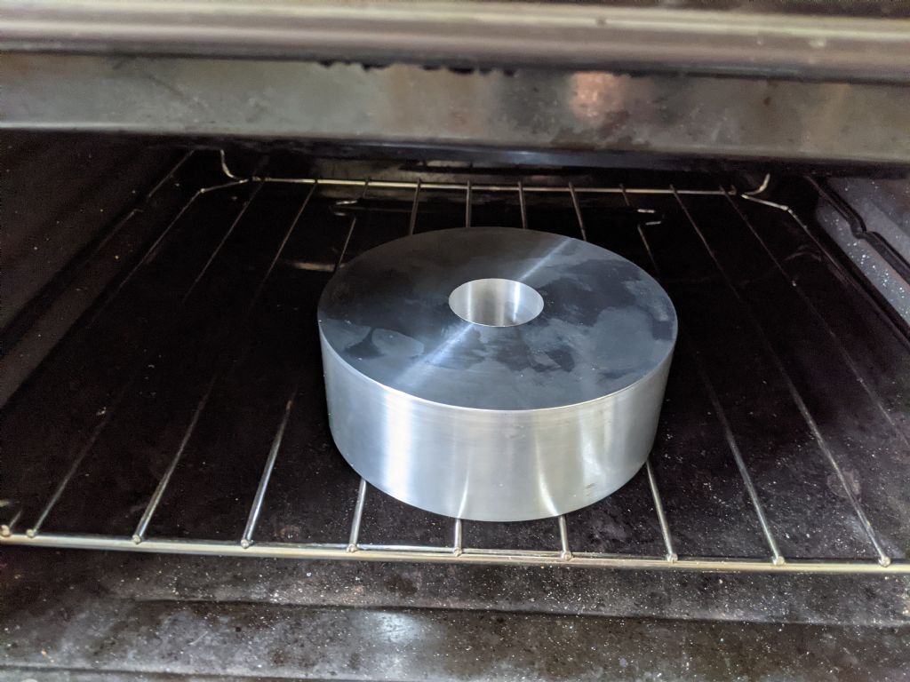

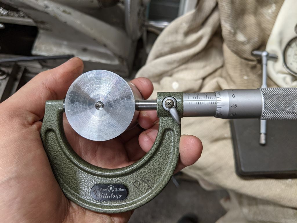

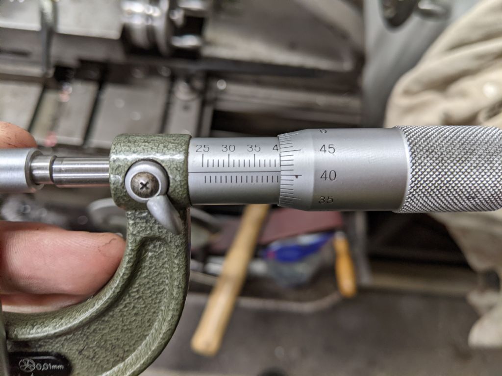

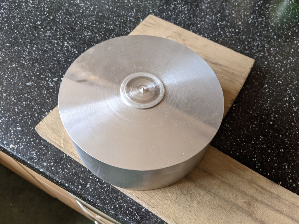

              Progress update, today I managed to turn the plug to size. It ended up at around 39.985mm.
              So I bored the hole out to 39.905mm, somehow it worked out perfectly.
              Then straight off into the oven, and the plug into the freezer. Left them both an hour. Then it slipped right in. Pretty much immediately wouldn't come back out. I left it to cool, then chucked it back up and faced each side. Then on the second face I drilled and bored to 24mm
              It's nice how the plug sort of disappeared when I faced it
              Thanks to everyone for their help so far.

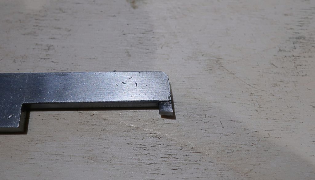

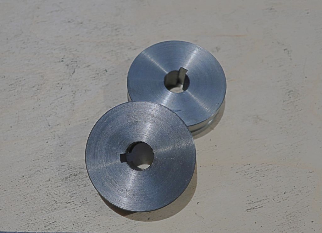

                      When I did the two 4mm keyways in the steel rollers below, I used gauge plate (Ground Flat Stock) simply because it can be milled & filed to an accurate slot 'cutter' shape before hardening with far greater control of the shape (esp. the corners) than can be achieved with HSS offhand on a bench grinder.. ..made for a crisper slot that didn't need any dressing..
                      The 'rake' on the front cutting edge was deliberately left steep to prevent 'digging in'..
                      I gave relief to all sides, only the cutting edge and a short distance above it was at finished dimension, final few licks with a stone after hardening.. ..looks a bit rough, but only the cutting edge on the front corner has to be 'good'..

                        I think 8mm is a bit wider than I would like to plane on the lathe all in one width, could probably do it with a tool like you used before say 3mm wide. Set it above ctr height and do one narrow keyway, then same distance below ctr to form as second and then take out the bit between with the tool on ctr height. Doing it in that order is more likely to give a parallel keyway as if you did the middle first the other two cuts would try to wander into the gap.
                        If you use a tool holder like a boring bar and a 3mm dia HSS bit ground like a parting tool but on it's side that will work. Similar to this just a square profile to the cutter.

                                    I think Jason's suggestion of making a 3mm wide tool, cutting two separate slots, and then clearing the central 'upstand' is a good one, and more likely to give you a straight-sided slot at the end of the job.. ..if you try to do two 4mm 'bites', the first will be okay, but the tool will want to wander into the 'open' side on the second pass..
                                    The depths of each cut should be shallow – try 0.02mm / .001" and see how it goes, I found the job went quicker taking shallow cuts and just turning the cross-slide round a division or so with one hand whilst racking the saddle with the other – a human approximation to a shaping machine..
                                    In any case you will be able to feel whether you can take a bit more or need to take a bit less, once you get started.
                                    You might be able to grind the necessary reliefs around the end of a small piece of HSS off-hand on a benchgrinder – only the cutting edge itself really has to be straight (-ish), as long as the rest of the tool 'body' has a little clearance so that it doesn't rub on the sides or base, it doesn't have to be particularly accurate or even in this manual operation – a Dremel might do it..
                                    Taking some care to make sure the cutting corner is 'sharp' pays dividends, it becomes tiresomely hard work with a dull cutter.

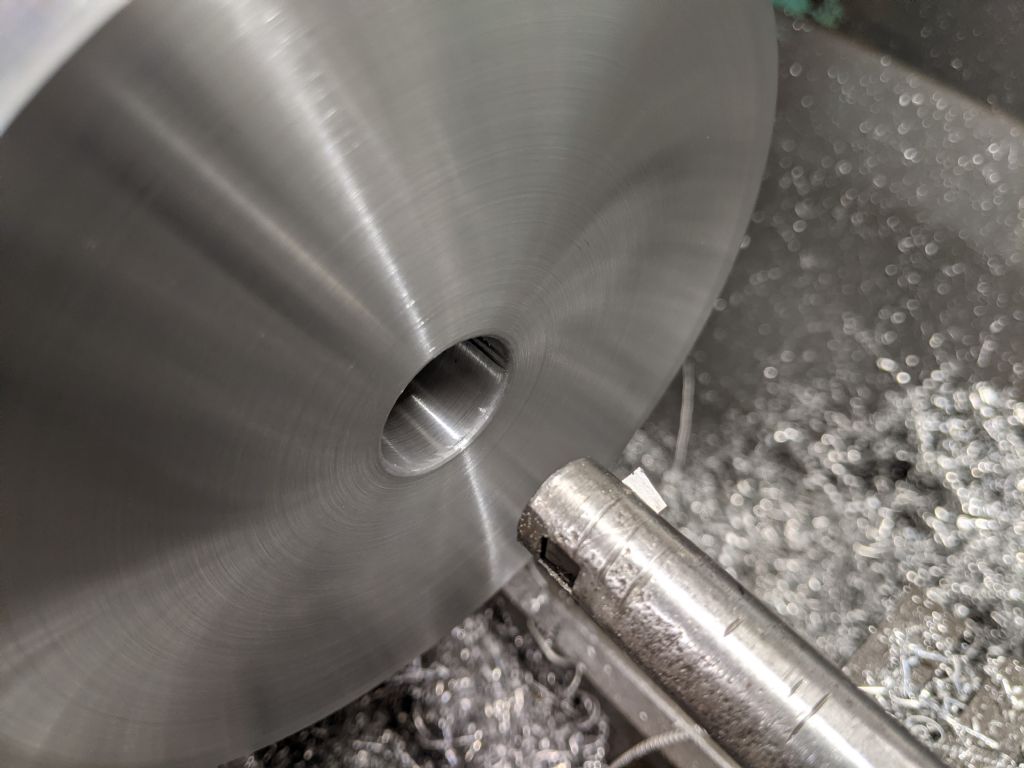

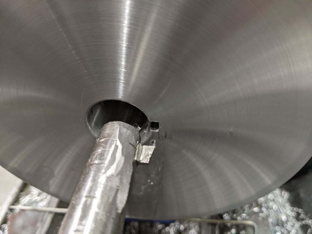

                                      Very tired today, but progress has been made and I am very happy once again.

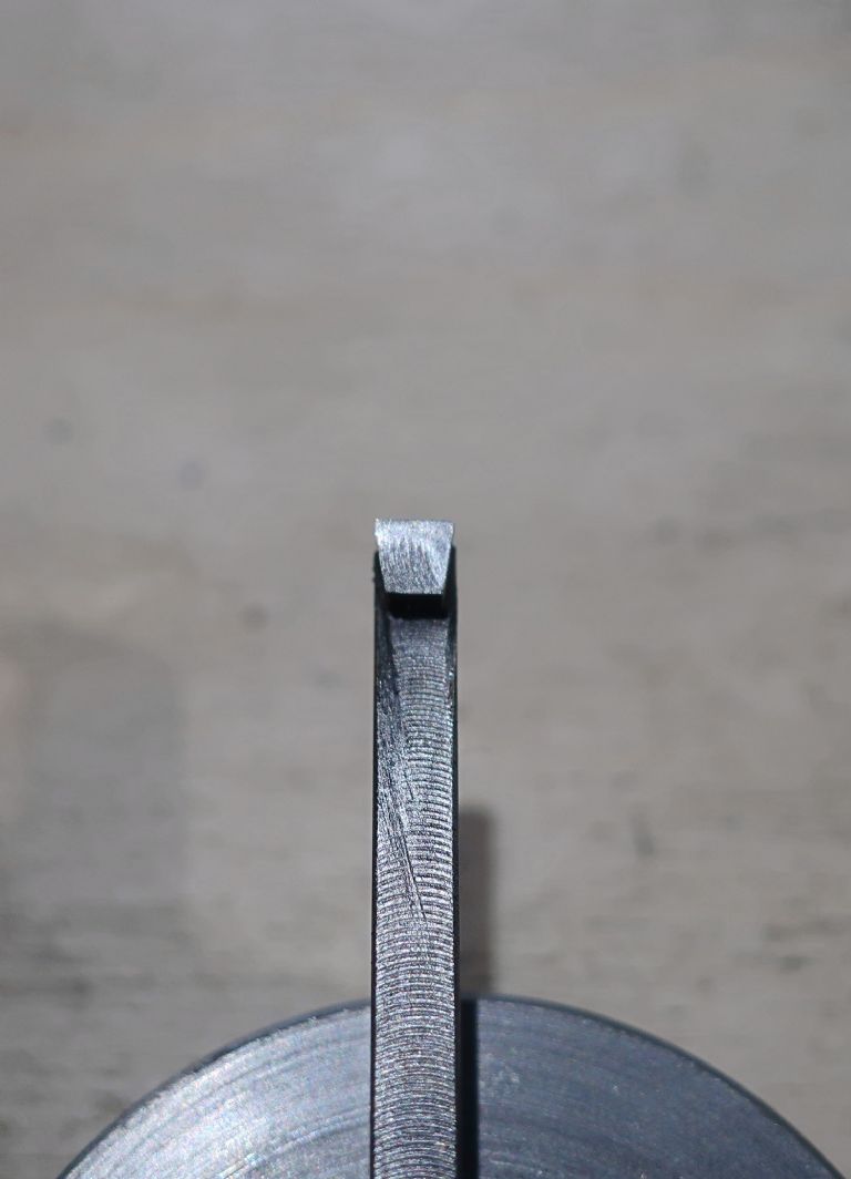

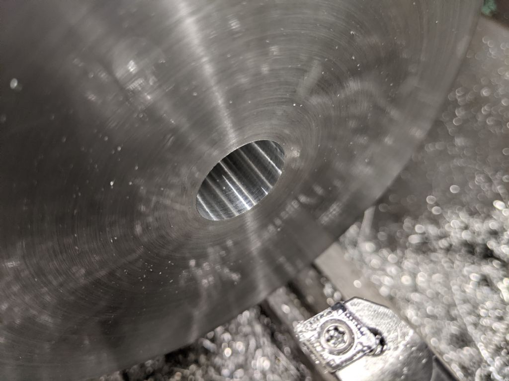

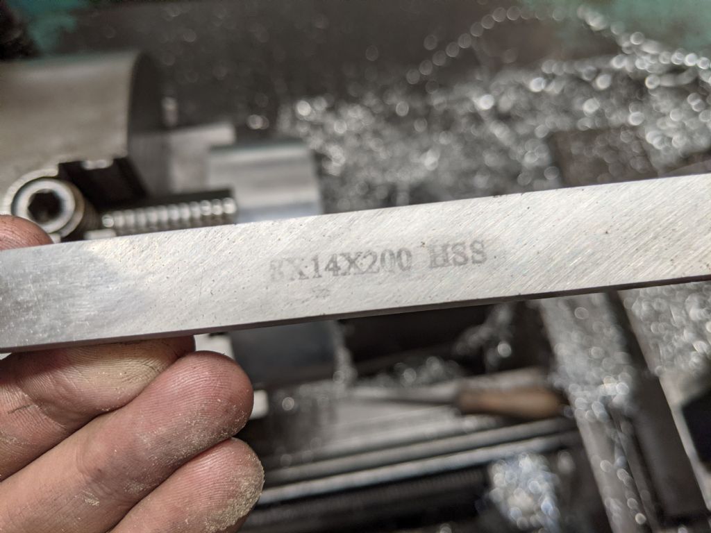

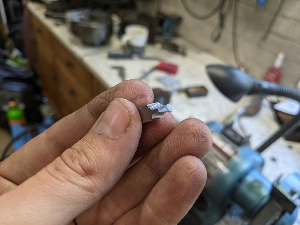

                                      I started off looking at what tools I had already for the lathe. There was a quarter-inch square boring bar/ keyway cutter that I purchased last summer in a job lot, which I had almost forgotten about. There was just enough HSS left to grind down the opposite end of the tool into the 3mm cutter I needed.
                                      I didn't bother grinding it to exactly 3mm as it was getting hot and I was getting impatient as it had taken a while. Then from the bench grinders fine wheel I took it to my tormek whetstone grinder and finished it off on there. I ended up with a 3.3mm cutter. Not the easiest to take pictures of, The camera makes it look rougher than it was. Most importantly, it was quite sharp and relieved on the front and sides.

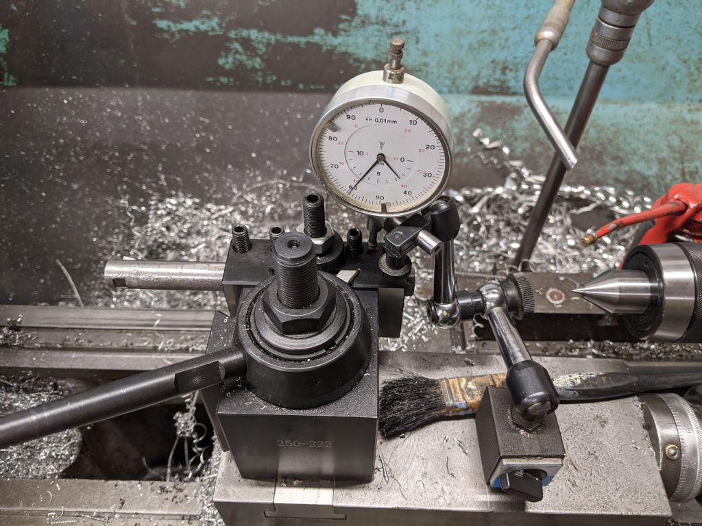

                                      Then I put the tool into a tool holder and set it to close enough to center. I did this by eye and looking at where the scratches were in the bore. Once the scratches were even I stopped.

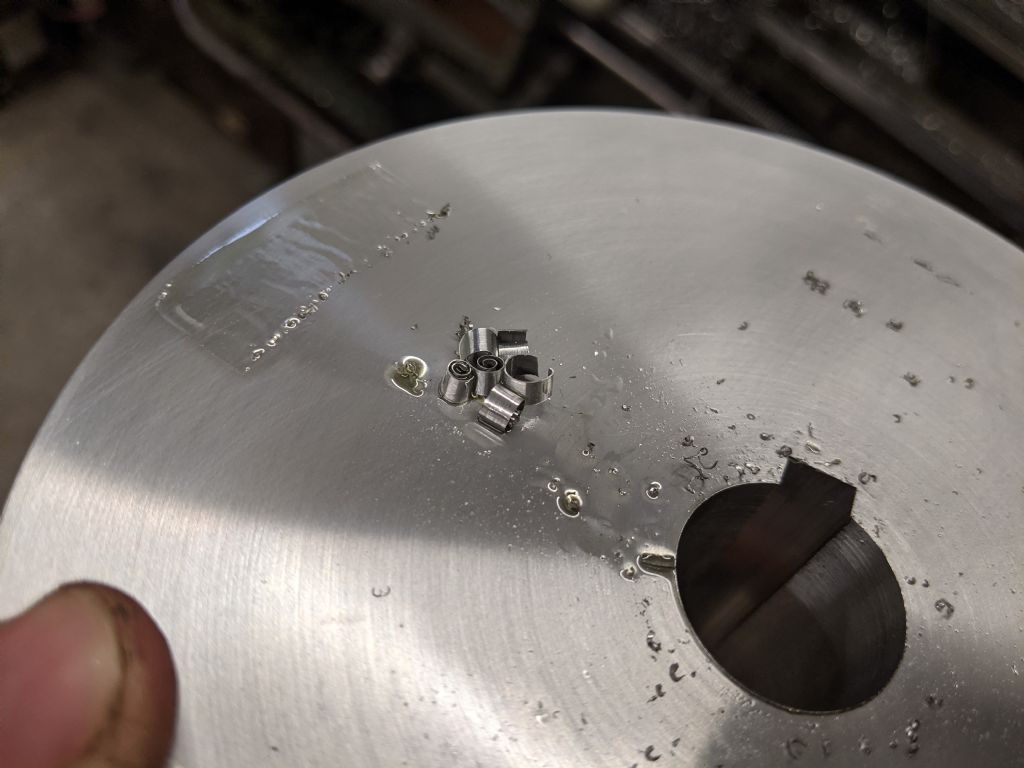

                                      I started off by taking smaller passes, especially since the full cutter was being used in the center pass. Starting with 1 thou depth of cut, although once I was a bit more confident I tried some larger cuts up to around 5 thou.
                                      I did find that I occasionally got a bit of deflection, so I did more than one pass on 1 depth to ensure it was cutting parallel to the bore, this seemed to work fine for me.
                                      Once the first slot was to depth, I used an indicator to move the tool up 2.4mm from the center. Then I cut another slot. This slot was smaller so I attempted a few heavier cuts of 7 thou or so, but generally, I tried to just do 2.5 thou cuts.
                                      I then lowered the tool and cut the other path. I found this to be easier than cutting two slots on either side and then taking out the middle. This way I started in the middle, just my preference.
                                      I can't imagine how much I would have struggled if I hadn't upgraded to a QCTP this summer. Thanks again to Phil for his help.
                                      I found this to be quite enjoyable. Definitely not as quick as broaching the hole, but much lower cost (zero in fact) and the satisfaction of doing it myself.
                                      I thought the chips pinged off quite nicely.

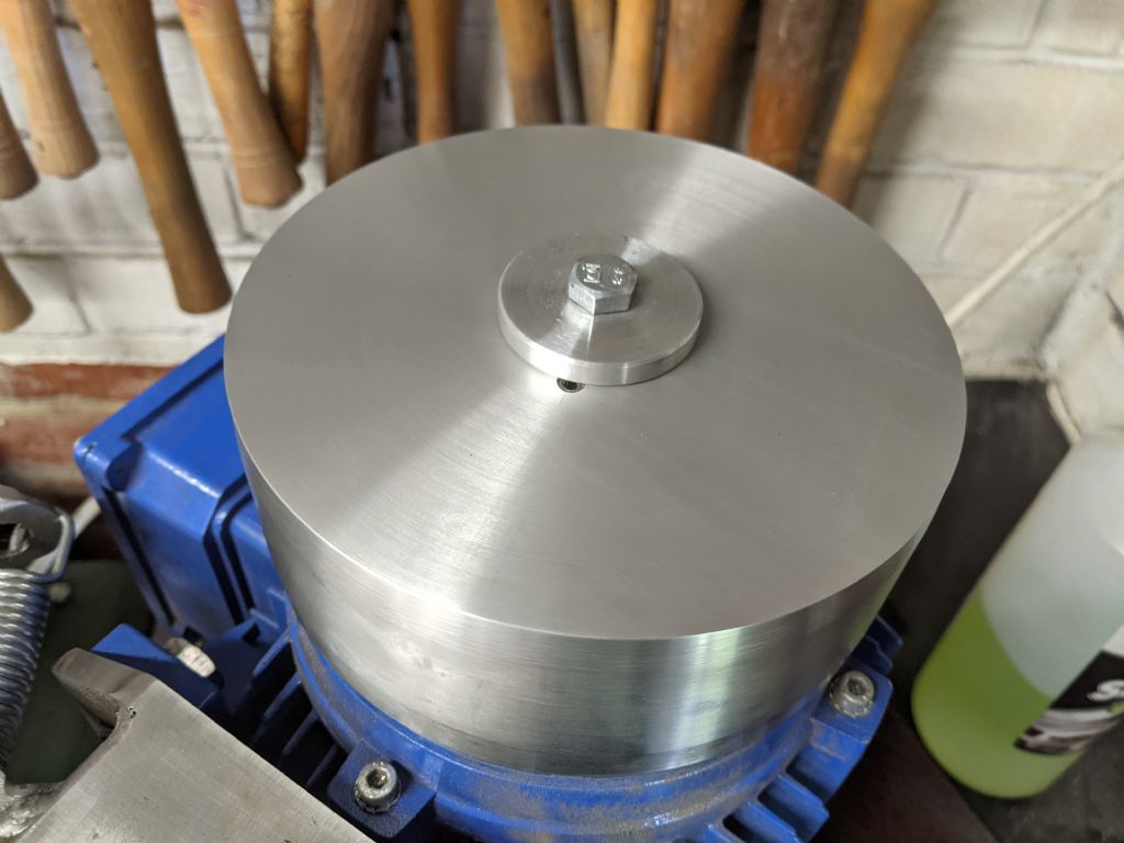

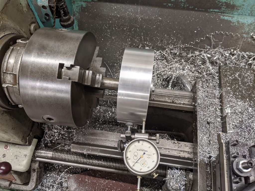

                                      I deburred everything with a file and deburring tool, then I attempted to fit the wheel. It fit perfectly!
                                      I stuck an indicator on the flat face(about where my thumb is in the picture above) and the runout is now 2 thou, a significant improvement compared to the 10-20 depending on shims before.
                                      The circular face is now 1.5 thou out of round, compared to the 10 thou before. Also a significant improvement.
                                      I turned on the motor and put it up to full speed, the vibration has gone. It's honestly like a new machine, it works a lot better. And the belt seems to wobble a lot less.

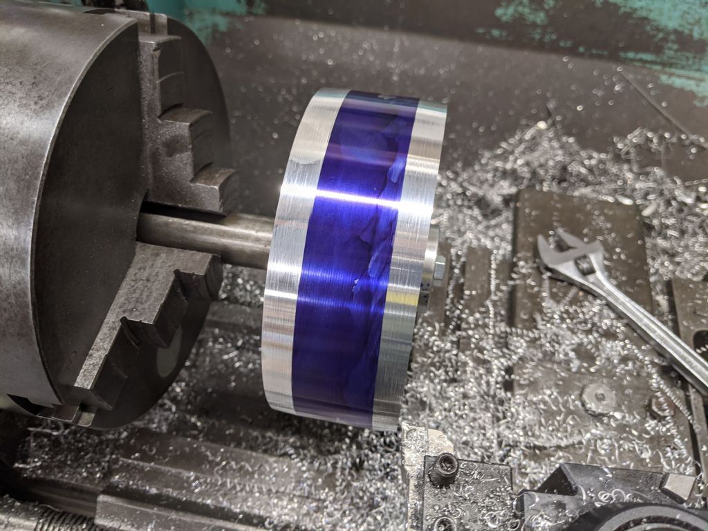

                                              Today's progress should finish the job completely (as far as the wheel is concerned. The belt sander still needs fixing up somehow, but that's a problem for another day and thread)
                                              The day commenced with turning a 24mm mandrel to remount the wheel onto. I make sure it was a very tight fit with no slop. Then I double-checked the runout on the outside to make sure it was the same runout that I'd seen on the motor shaft. This meant that it was accurate enough and taking a cut was likely to result in a better concentricity, so I decided to take the plunge and skim the outside.
                                              After skimming the outside I decided to put a tapered crown on the wheel to *hopefully* help the belt sander track a bit better. This went quite well, just like when I did the same thing to the tracking wheel.

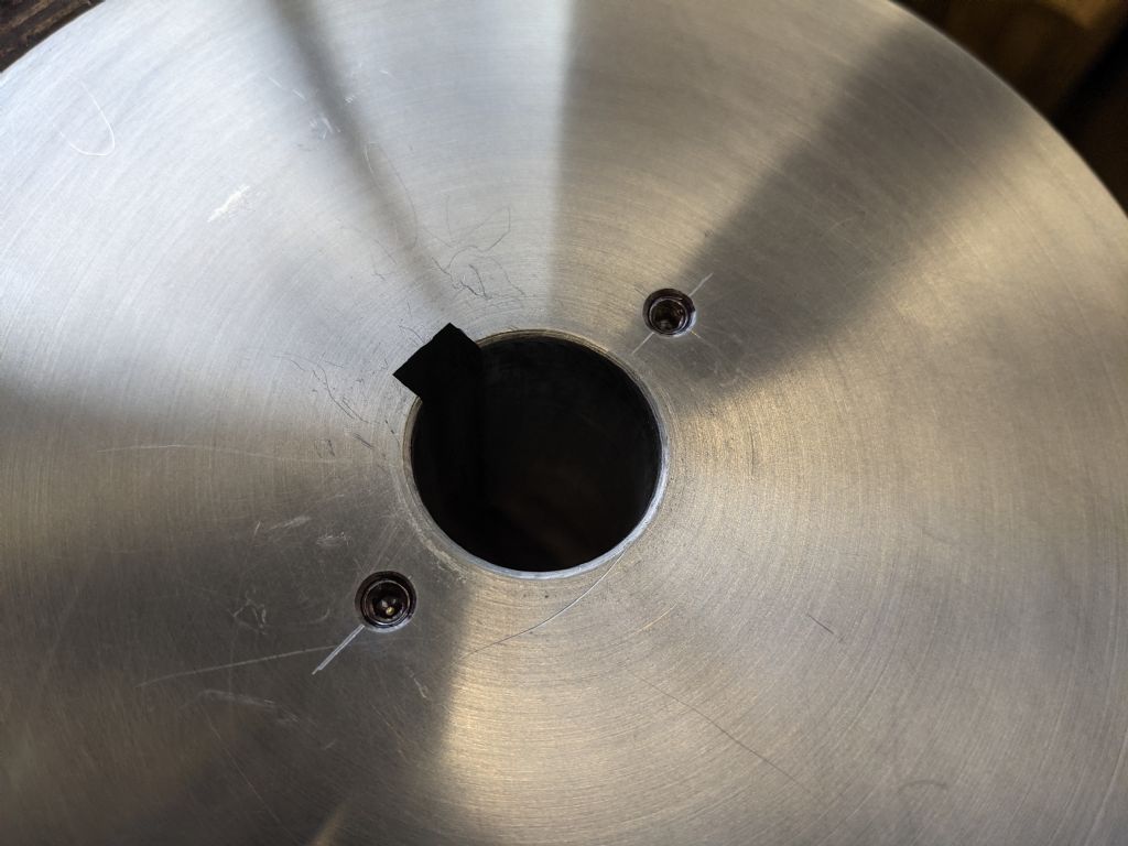

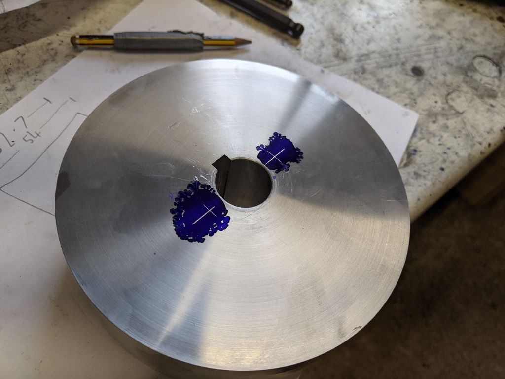

                                              Next step was to create the "dutch keys" for the 'braces' half. I put some layout fluid on the surface where I thought the holes needed to be, then I marked the holes and drilled to 4.2mm, ready to tap to M5.

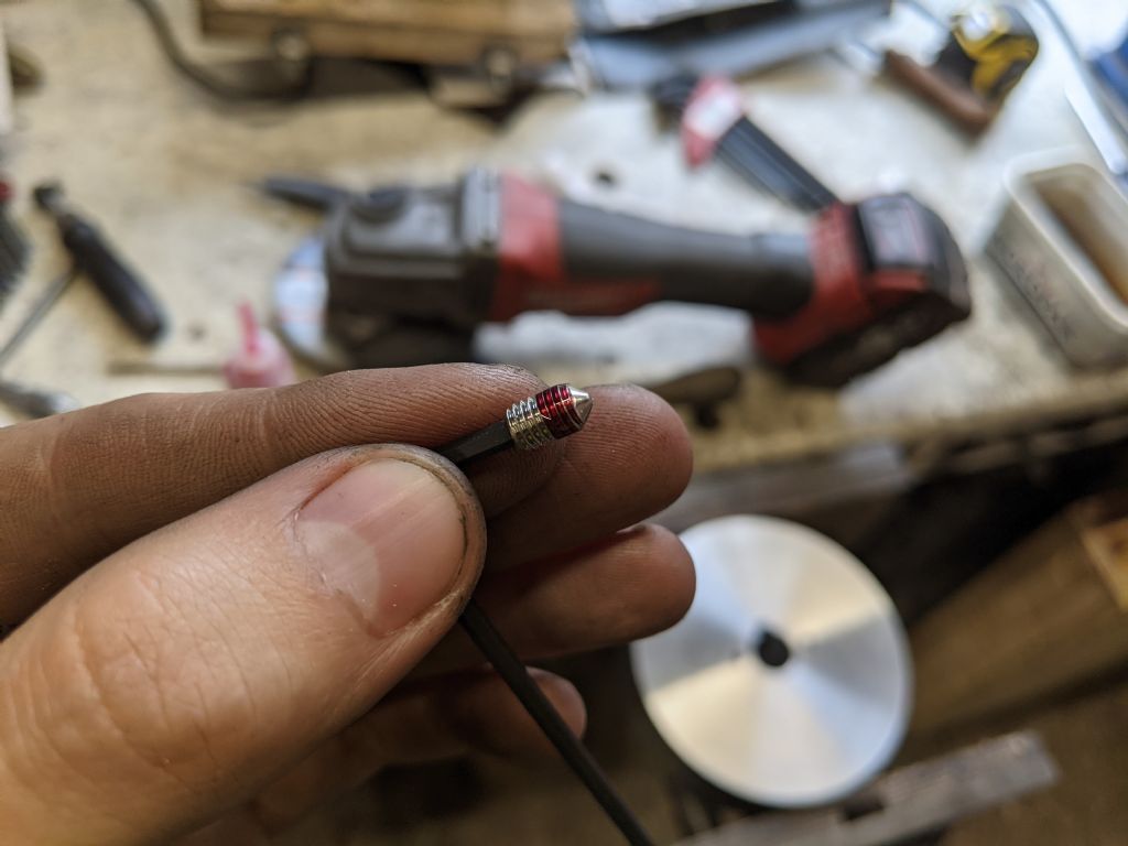

                                              Once tapped and deburred, I dropped a blob of locktite 271 onto each of the M5 grub screws then tightened them down.
                                              Howard, I understand you were saying to use long grubscrews or as long as the thickness of the wheel. I just used what I had lying around already, It's better than nothing. I just hope they're not needed at any point. The shrink-fit will hopefully do enough and the belt sander won't have a hard life anyway.
                                              With that completed, the wheel was remounted onto the motor. All finished.
                                              I checked the outside for the concentricity and it looked to be about 1.5 thou out. This may not be perfection, but it is significantly better than before. Plus, the vibration is practically gone, which is exactly what I wanted. No shims are required either…
