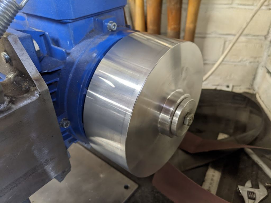

      Hello all, I could do with some help
      I have a wheel from a belt sander I've been rebuilding, however, the wheels bore is too large and not concentric with the outside surface so I get about 10 thou runout at best after I've shimmed it. Not great when it's spinning very fast.
      Video of runout
      I'd like to bore the center out, then plug it and rebore it properly so everything is concentric.
      I have a slug of around 40mm aluminium just the right size to do so, but before I jump in and start making chips I just want to ask about the fit. The motor shaft is 24mm so the hole will be reamed to that at the end.
      I've looked in the zeus book about what to do, but having never done it before I could do with a second, third or more opinions.
      If I want the plug to press in and never come out again, what sort of dimensions should I aim for?
      Would it be better to drill out the majority of the center of the plug as well?
      Will the center being removed after effect the fit?

          Just to get the ball rolling, in this situation Loctite is your friend.

            I agree, make the joint with 0.001 clearance degrease both halves and use Loctite 601, 638, 620 or the equivalent. Leave the joint 24 hours and you are good to go. If you ever need to disassemble the joint, heat the assembly to 300C to destroy the Loctite. A turned finish, not polished will give the best strength of joint.

              You may also want to bore the plug to fit rather than ream, the average reamer is usually H7 or H8 which is a plus size which may be OK for a running fit like a bearing but could be a little loose for your pully.

                  Is it a solid wheel? If so, shrink fitting should be easy as the coeff. of expansion of Aluminium is quite high.
                  I think the general mismatch in fit is about 2 thou per inch diameter (0.02mm/cm diameter). Has to be a quick fit, I expect.

                    Machined finish, degrease, and loctite. Bore hole to size, no reamer ! Noel

                                    I would be interested to know where the runout comes from in the first place. Maybe the bore is accurately concentric with the OD but a loose fit on the motor shaft also depending on how the pulley held on the shaft may throw it off centre (grubscrew/keyway). What does the bolt on the centreline do?
                                    If the pulley is a solid lump of ali I would be tempted to put a conical bore in it to accept an off the shelf 'taper-lock' bush.

                                        So, if the plug and hole will be around 38mm, then the plug must be about 0.08mm larger than the hole?

                                          Alternative suggestion – if the wheel fits well on the motor shaft and doesn't vibrate too badly as-is, then clamp the motor to the bed of your lathe, align carefully, spin it up and true the face and edge of the wheel as an assembly. Speed may not be ideal but you are only after a skim so proceed with caution and should be OK?

                                            The wheel was initially machined by a technician at the college I went to. I'm not even sure the college had a boring bar at the time so I think he just drilled it. The outside was turned on a mandrel but I believe the mandrel was not a tight fit in the hole, so the outside wasn't turned correctly. It really is just the center hole being oversized that has caused issues.
                                            The bolt on the centerline holds the wheel on the shaft. I'm sure a setscrew would be better, but I don't think I have the right set up to try and do that.
                                            The taper lock bush is also a good idea. It looks like the standard ones for 24mm motor shafts have a dia of 57mm so that could be a third option if the other two fail. Once again I don't have access to a milling machine so drilling the half holes may be troublesome.

                                              38mm is 3.8cm. 3.8*0.02 = 0.076mm, which is 0.08mm to two significant figures.
                                              Coeff. of exp. for Aluminium is given as 21*10^-6/K (but likely 10% higher) so a 100K delta would provide a very mild interference fit. You should be able to attain a delta T of 250K by heating the wheel and deep freezing the bush.
                                              It requires the parts to be machined parallel and fitted together quite quickly as the conductivity of Aluminium is nearly ten times that of steel.
                                              Never tried Aluminium myself, but have often shink-fitted steel parts.

                                                You were clear enough, it's that the reamer may leave a hole in the plug larger than ideal. With a 24mm hole in the plug you will be well advised to drill out to say 20mm and then bore to reaming size , this ensures the reamer follows a true path rather than the path of the drill which can wander.
                                                So may as well go the whole hog and bore the last little bit to finished exact size and save the cost of the reamer for something else.
                                                One other spanner to throw into the works is that the wheels on my belt sanders can get too hot to touch after prolonged use which could affect the fit if shrinking.

                                                    Okay right so I'll bore everything and forget about the reamer.
                                                    Yes, I suppose they should expand and contract together so that should be alright. I've never noticed the back wheel getting massively hot, but I don't tend to touch it much!
                                                    The only issue I can think of will be the difficulty of heating the wheel and cooling the plug at the same time, since I don't have a freezer in the workshop. I'll have to heat up the wheel, pop in the house and grab the plug from the freezer, then heat the wheel back up again, then press it in.
                                                    Another issue will be recutting the keyway! I'll worry about that later…
