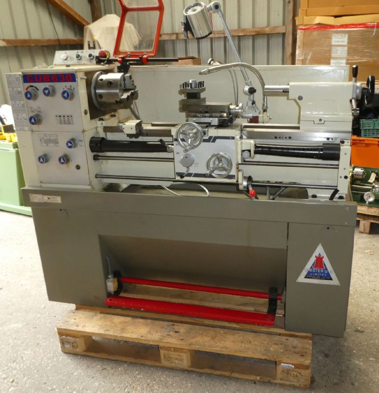

      After more hours poring over machinery adverts than I would care to admit, I have finally purchased one of these machines via Warco's used machines sales. It comes with very little equipment, sadly, but it is big enough to be bigger than I can imagine needing for my purposes – and so with any luck hopefully big enough! It has come from a school and has I am told sat pretty much untouched for most of its life so far. Little of the standard equipment – steadies, chucks, etc, seem to have migrated with it. There may not even be a chuck key.
      I'll have in the fullness of time lots of questions to ask, beginning with getting it in place, but first, some useful info/links. The machine is a Chester Cub 630; I am not sure how old it is, but Chester deny all knowledge of it, from what Google tells me. Apparently Warco sold a GH750 which was essentially the same machine – at the moment, I don't know what "essentially" means. The lathe was manufactured in three sizes, 500, 750, and 1000mm between centres. Note that it's a quite different machine to the present Warco GH600.
      TPH have a copy of the specifications here:
      https://www.tphmachinetools.co.uk/products/1410-new-chester-cub630
      300mm swing, 750mm between centres, 38mm spindle bore, D1-5(!) camlock, MT3 tailstock, overall length 1650mm, width 680mm, height 1200mm. Overall weight: 500kg. Three phase.
      I have a copy of the GH750 manual (thanks Gavin!) which is not hugely helpful, particularly in regard to particulars of oiling and maintenance, but the wiring diagrams and so forth are worth having.
      And here is how it looks: 2355.jpg

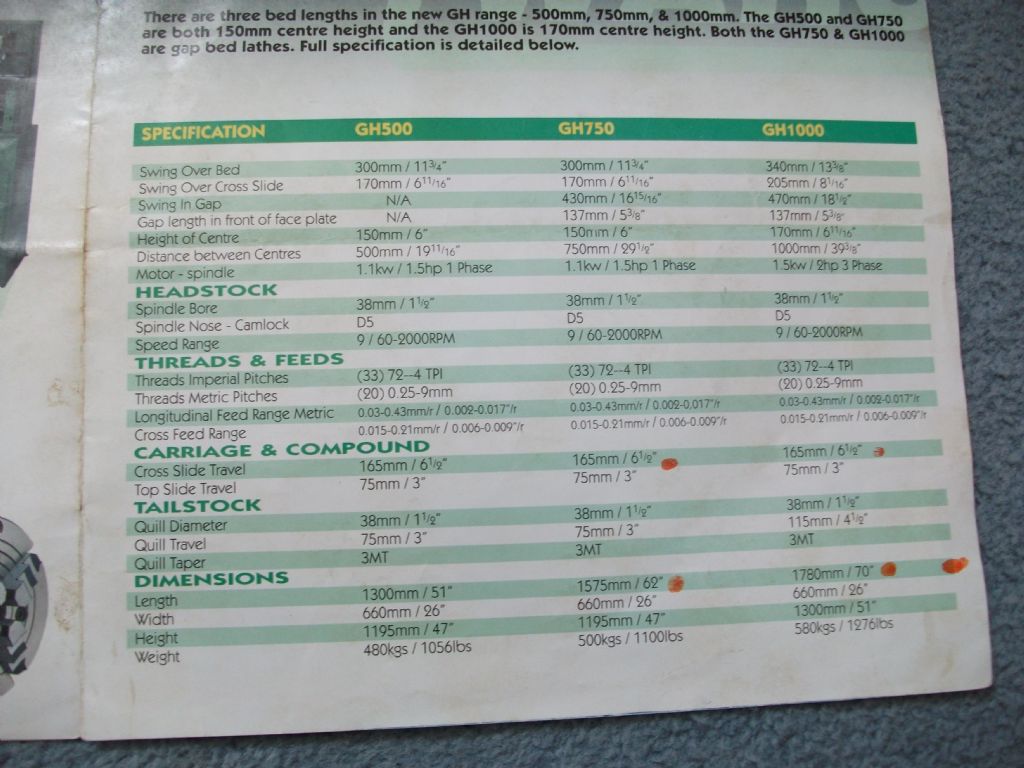

          Hi Calum, the scan below is from Chester Machine Tools catalogue 2012, hope this helps.
          Regards Nick.

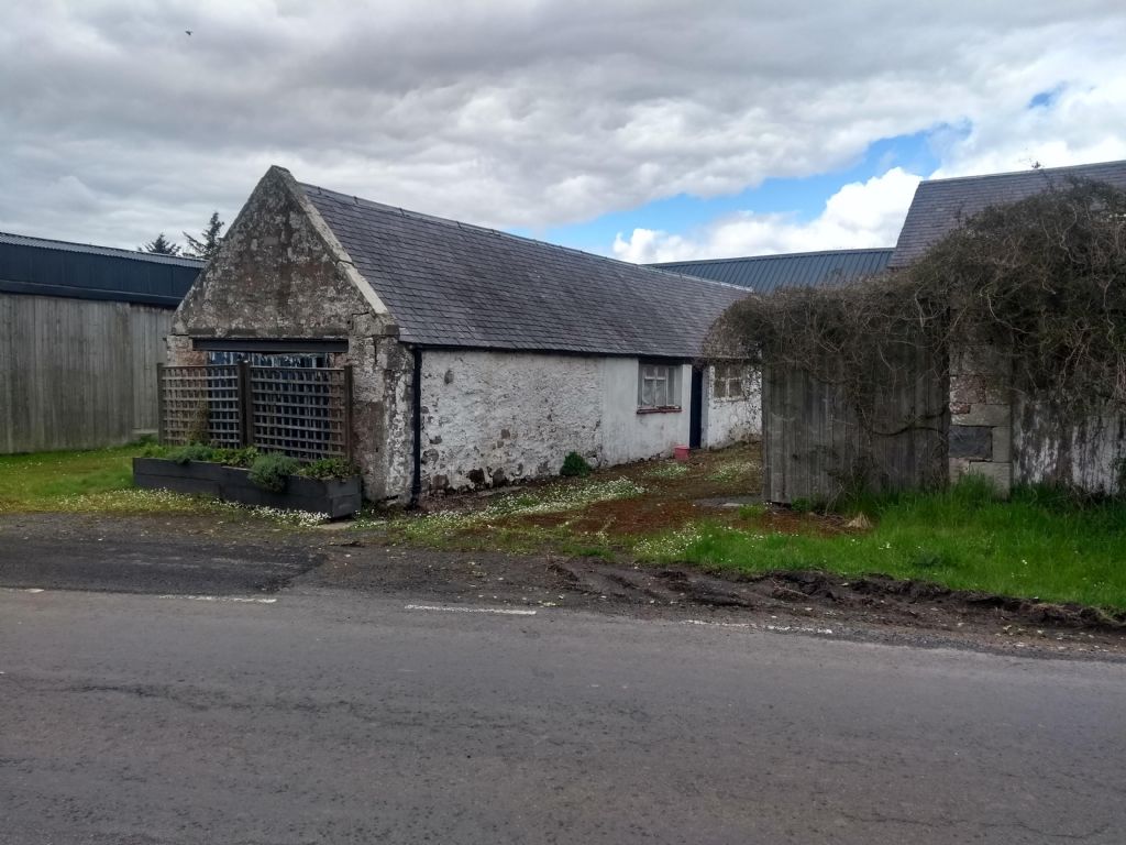

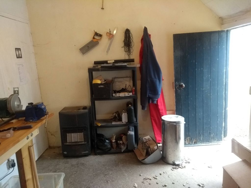

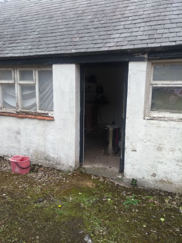

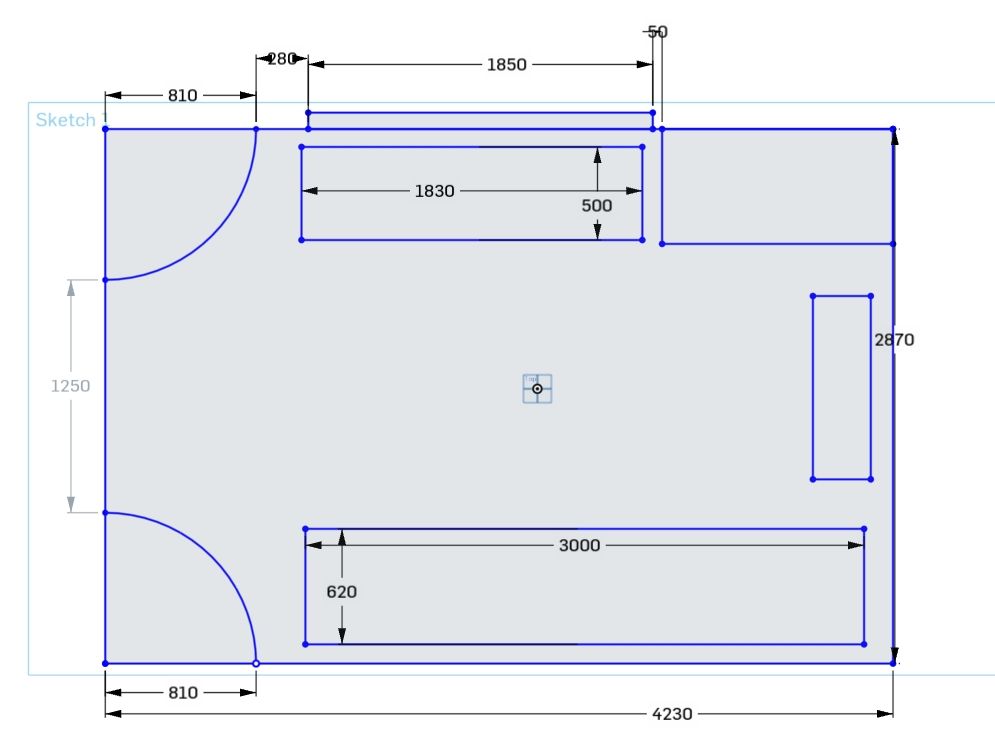

            So my first problem is getting it in place. It is being delivered by Palletline, so there's no telling how helpful the driver will (be able to) be. This is the entrance to my workshop:
            and this is the view from the road:
            There is a large area of hard standing to the left, not pictured. Palletline normally only guarantee a pallet jack on delivery, and while it is possible to get over the ground to the door – it's concrete underneath the moss, and we've done it before – I'm a bit leary about doing so with a 500 kilo lathe balanced on a Euro pallet. At the same time, I really don't fancy rolling it on scaffold poles over that ground.

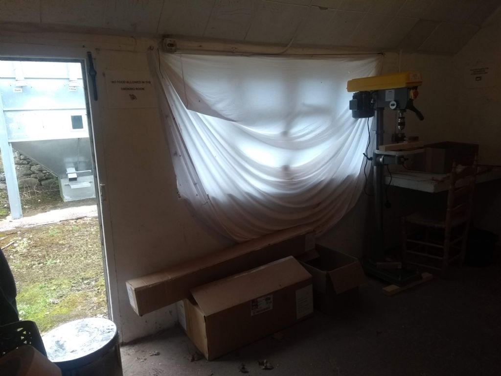

            Then the next problem is getting it through the door. I've measured: the gap in the door is 690mm with the door on; if I took it off, it's about 740mm. I don't want to take it off, but, 5mm clearance (width is 680mm) is hardly generous! Finally, once I am inside, I have a space that looks like this:
            The external door is at the top left hand corner and the lathe is to go in front of the window (the 1830 dimension is for a previous lathe I didn't go ahead with). The rectangle at the top right is a concrete shelf, the 3000mm is my bench and the smaller rectangle is my wood lathe:
            At the moment, I am thinking: I need to get it on wheels to cover the ground outside, BUT ideally those wheels don't protrude out the sides to make it possible to get through the door. In addition, my turning space inside the workshop is limited.
            Would it be sensible therefore to consider getting the lathe up on some dollies:
            I am thinking that something like that, though higher weight capacity than this! Is it safe/feasible to do something like this? Would it be wise to bolt the lathe to the platform? Amazon have a 400kg dolly L590 x W290 x H140mm
            Then, getting it off the pallet onto the dollies: Presumably I can get the lathe lifted up with blocks, wedges and a pry bar enough to get a round bar under it to roll it onto a dolly. Is there anything I should be careful about here?
            Any and all other thoughts and suggestions very welcome!

                Some points to note:
                1. Lathes are top heavy, and if they fall off a pallet truck or trolley you're not going to stop them. If the driver can't, or won't, deliver to the door then there are a couple of choices. One, use scaffold poles and plenty of them. Two, looks like a farming area so can you borrow a JCB or similar? My comparable size lathe has a threaded hole in one of the bed cross members for a screw in eye for lifting.
                2. Can you take the splashback off to get through the door without needing major surgery?
                3. Once in the workshop you can inch it round using a pry bar and then small rollers to move into place. I've moved a 2 ton mill around in my workshop with a pry bar and short lengths of 3/4" aluminium rod.

                  Hi Calum, I've also found it in a 2002 catalogue same spec's but no DRO fitted, but it came with a faceplate as well as all the other standard accessories, but the cabinet is shown as been painted white and the chuck guard doesn't show any windows and was also painted white but the lamp is shown as the same style as the one in your photo, so it may give you a clue on it's age. Oh, and another difference is the leadscrew doesn't have the same guards, it just has one folded steel one fixed onto the tailstock side of the saddle, by the looks of it.
                  Regards Nick.
                  P.S. looking through some other catalogues,  the DRO was first fitted in 2008, which should narrow down the date of yours, and the cabinet is painted the same colour as yours in the catalogue previous to 2008.

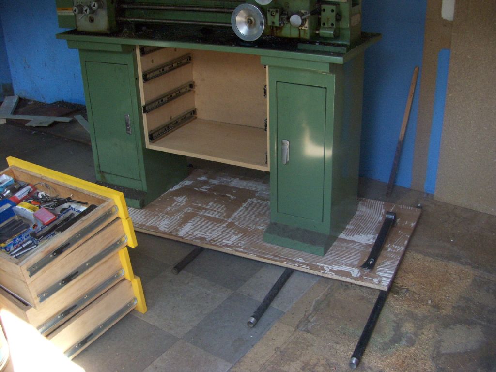

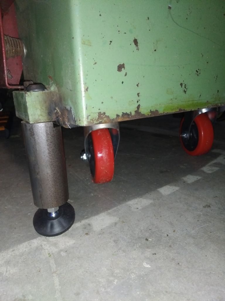

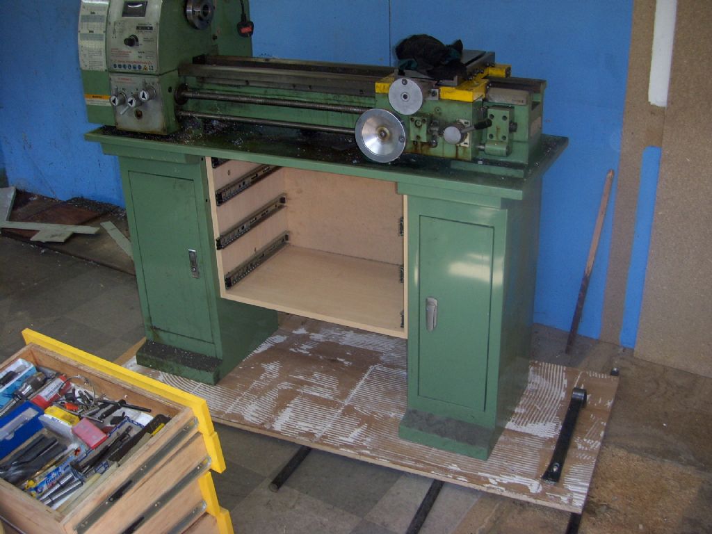

                    When my similar size lathe arrived, I welded some pre made plates of 6mm steel with castors to bottom, and used some 40mm steel bar tapped m12 each end, to make four feet with adjustable swivel soles which bolt to the original reinforced area of the frame, I think the wheels are 100mm, solves the problem permanently, it can be moved around with similar effort to pushing a shopping trolley.
                    Boxford 11.30 feet
                      I like the look of that, it makes a lot of sense. I'll have quite a bit of time once it arrives and I get it in, as I need an electrician to run a 3 phase spur (I'm lucky enough to have three phase on site, which came as a pleasant surprise) and replace the wiring in the rest of the workshop.

                        Howard Lewis
                          @howardlewis46836
                          Welcome Callum.
                          FWIW, this is my advice. Interrupted by tea time! )
                          First, strap the lathe to the pallet. so that is less likely to fall off.
                          Gently lever it up onto some short lengths of scaffold poles. A you will need at least three.
                          If you use dollies, make sure that they can take the load, Two may be a good idea, rather than trying to balance everything on a dolly that is shorter than the pallet.
                          Roll the pallet and machine forward, replacing each roller with a spare just before the pallet comes off. You can steer things by gentle slewing on the rollers.
                          To go over soft ground, it would make make life MUCH easier to be able to roll over boards or steel plates, even if you can manage only two and have to keep "stepping" up the one just left behind. At least the rollers won't sink into the grass!
                          Once on hard standing, a pry bar can be used to adjust the direction of travel and position.
                          %mm clearance each side w through the door will be tight.
                          Any chance you could rig a block and tackle so that everything can be slowly winched through the door way?
                          Once inside, the prybar can be used to steer things to where you want them.
                          Ideally, the cabinet should be bolted to the floor. but it may be better to make / fit adjustable feet to bring the lathe l somewhere near level. The first job may be using the lathe to make the adjustable feet!
                          Once in place, it will be worth adjusting the feet to take nay twist out of the bed.
                          This will mean that the lathe should cut parallel and not tapered.
                          You can either use a very sensitive level, or use the method that Myford and Ian Bradley advocate in his book "The Amateur's Workshop" , turning a test piece, and adjusting at the Tailstock end until the bed is free from twist.. Unless you you intend to use flood coolant the level from Headstock to Tailstock is less important, but twist across the bed is a No No if you want be sure of turning parallel..
                          Once set up you can start making accessories to aid its use, and finding accessories to expand it's abilities.
                          I would suggest making a Centre Height Gauge, as a useful tool, and then a Mandrel Handle , and possibly a liitle later,,a Saddle stop..
                          All these will make you more familiar with the machine and be useful items
                          HTH
                          Howard
                          Edited By Howard Lewis on 22/05/2021 19:43:34

                              I have a Warco GH1000 lathe they are the same as the Chester cub range there are some differences
                              mostly the layout and position of the apron handwheel and auto feed lever ,i would have thought that it
                              would fit through the gap of the existing door frame with the door on at the sizes you have indicated.
                              There would be little to be gained in removing the splashback as the electrical box mounted behind the
                              headstock protrudes 2 inches further out and the splashback follows the same line as the
                              stands and tray ,if you need to reduce the width both the apron handwheel and the crosslide
                              handwheel can easily be removed ,the crosslide bracket fits with two cap bolts and can then be
                              unscrewed from the crosslide as a complete assembly . Both of these project out most of all and
                              make up the width of 680 mm with them removed it would be about 580 mm .

                                Scaffold poles is definitely one option but my worry is what's going on underneath the footbrake
                                I wouldn't even think about using scaffold poles under the footbrake. Instead I'd use at least two poles under each end. It will be time consuming moving them frequently. But a darn sight less time than that wasted if the lathe is damaged because a shortcut was tried.
                                The very first thing I'd do is move the lathe off the pallet. The pallet just gets in the way and makes things less stable, and they have a habit of breaking at an awkward time.
                                Andrew
                                #546451
                                  If you are worried about the foot brake then get two half sheets of ply laid ontop of your rollers and get the lathe onto that then the ply will bridge the gap, 3/4" "gas Barrel" also makes handy rollers. I could push my lathe about with a couple of finger swhen setup like this
                                  Alternative is to put the poles in the direction you want the lathe to move and it will skid across the tops of the poles quite easily, they don't have to be used as rollers
                                  Take the tailstock, topslide and chuck off and wind the carriage to the tailstock end before you start moving it as it will help reduce the top heavy nature a bit. Plus remove handles from the handwheels so they don't get snapped off
                                  Edited By JasonB on 23/05/2021 07:33:41

                                      Thanks all for your replies, some really helpful ideas, and my apologies for not responding to them all individually. I've just a couple of quick questions arising:
                                      John, Raymond: can you tell me roughly what size tube/rod the lifting holes can take? Scaffold tube is a smidge under 50mm, which to me looks awfully tight from the photos. Also, can you get at the inside of the stand from the sides?
                                      I've been out and walked the ground again and the more I look at it, the less keen I am on trying to roll it on poles; the ground is uneven enough than I can see the poles getting stuck very easily, and there is the odd dip/pothole, in particular a gutter runs in front of the door. While I hope to have some useful bodies on hand to assist, it may potentially be just me.
                                      I am thinking back to my plan A. These dollies:
                                      look like the two cabinet feet should sit on them pretty solidly, and handily, they are just under the pallet size, so it should be easy enough to block, wedge and prybar them onto the dollies, pull out the pallet, then put one end up on blocks to get most of the dolly under it, and repeat at the other end. Then bolt or clamp them to the lathe, and then very carefully steer it to its new home. And as Jason and John say, getting the tailstock and other gubbins off will hopefully make it a little less easy to tip. I did ride horses for many years which have similar problems, so the issue isn't entirely new to me…

                                          Those dollies are only any use on a flat and solid surface. They may be ok once you get the lathe into the workshop but not on the ground outside.
                                          This is what I would do:
                                          I would strap the lathe to the pallet , lay some boards or planks on the ground and use some round bars as rollers to sit the pallet onto. If the delivery is via palletways the driver should be able to lift the pallet up so you can get boards and rollers under it and then lower it onto them. Probably put some strengthening timbers between the top and bottom boards of the pallet. Then you should be able to easily roll the lathe on its pallet, moving the boards in front of it as required.
                                          When you get it to the workshop use a bar to pry it round through 90 degrees still on the pallet on top of a board level with the workshop floor . Jack up each end the lathe in turn and put some blocks under each end of the lathe. Remove the pallet and jack the lathe down onto rollers and push it into the workshop making sure to keep the rollers under each part of the stand.
                                          When I was at work, we moved transformers weighing a few tons and switchgear using this method.
                                          Stuart

                                            Hi Calum, personally I would not use those dollies because the castors are not far enough apart, the centre of the wheels when pointed towards each other, should be at the very minimum the same width as your lathe and would be much safer and stable if they were completely outside the width. Believe me I've seen it happen where someone has put a similar size object on a similar trolley and with castors turning inwards, over the whole thing goes with the slightest push. You would be better to get a decent size board and castors and set them as far apart as possible. If you remove the lathe from the cabinet, it would be more reasonable as the centre of gravity would be very much lower.

                                                I think you will find the lifting holes are 1 in as it is made for the American market. I would first of all get some allthread to go through those holes to attach an anti-tip framework or at least an outrigger so that when it falls over it doesn't land on the cross slide handle.
                                                Perhaps get it off the pallet onto two 2×6 lengthways bolted on with the foot holes will give a better runnning surface for scaffold poles and scaff planks on the ground will sort that surface out. Worth getting new planks as the timber can be used for benches etc after. If you make the pieces under the lathe mentioned above over long you can bolt anti-tip bars to them.
                                                A farmer with a telehandler might loan it in exchange for a repair job – farmers always need something repaired.

                                                  Ideally when Palletline deliver, ask if the lathe can be lifted clear of the pallet to insert a 15 mm or thicker board under it, before strapping to the pallet.
                                                  When you come to move the lathe, strapped to the pallet, over the grassed area, lay down boards for the rollers to run on. You will need at least three rollers. 50 mm scaffold pole will make movement quite easy over boards or level concrete. (Once had a Colchester try to run away from me on scaffold poles on a level floor when I pushed too hard! )
                                                  Two sturdy boards, 15 mm thick, minimum, will allow you to move the machine easily, as long as the uphill gradient is not too steep. Once off the first board, it can overtake the second, and so on, until the machine reaches hardstanding.
                                                  Apply the push or pull as low down as possible. The higher the forces, the greater risk of toppling over!.
                                                  Better to be longer doing the job than spending time trying to get it upright again to inspect the damage to machine or human!
                                                  Once in the workshop, and close to the intended position, I would suggest pushing the lathe, on the board, off the pallet , endways. A prybar should aid skidding sideways to put the machine into position.
                                                  Once that is done, you can start setting the machine level so that the bed is free of twist.

                                                      Then the other topic, which I haven't yet planned in detail, is levelling the machine. Unfortunately, the concrete floor is anything but flat. A rough measurement suggests the floor is 2" lower on the left than on the right. This is big enough that I'm thinking maybe the best thing to do is install a concrete pad for it to sit on so the two cabinet feet are both sitting on a flat surface.
                                                      When it comes to levelling itself, what do I need in terms of measuring level? A Starret 4" level is £90; but the quoted accuracy is 4-5 minutes of arc, not much better than a digital box that can resolve 0.1 degree. Or there are the Chinese made ones that claim 0.02mm over 200mm, which is less than a hundredth of a degree – hmm!
