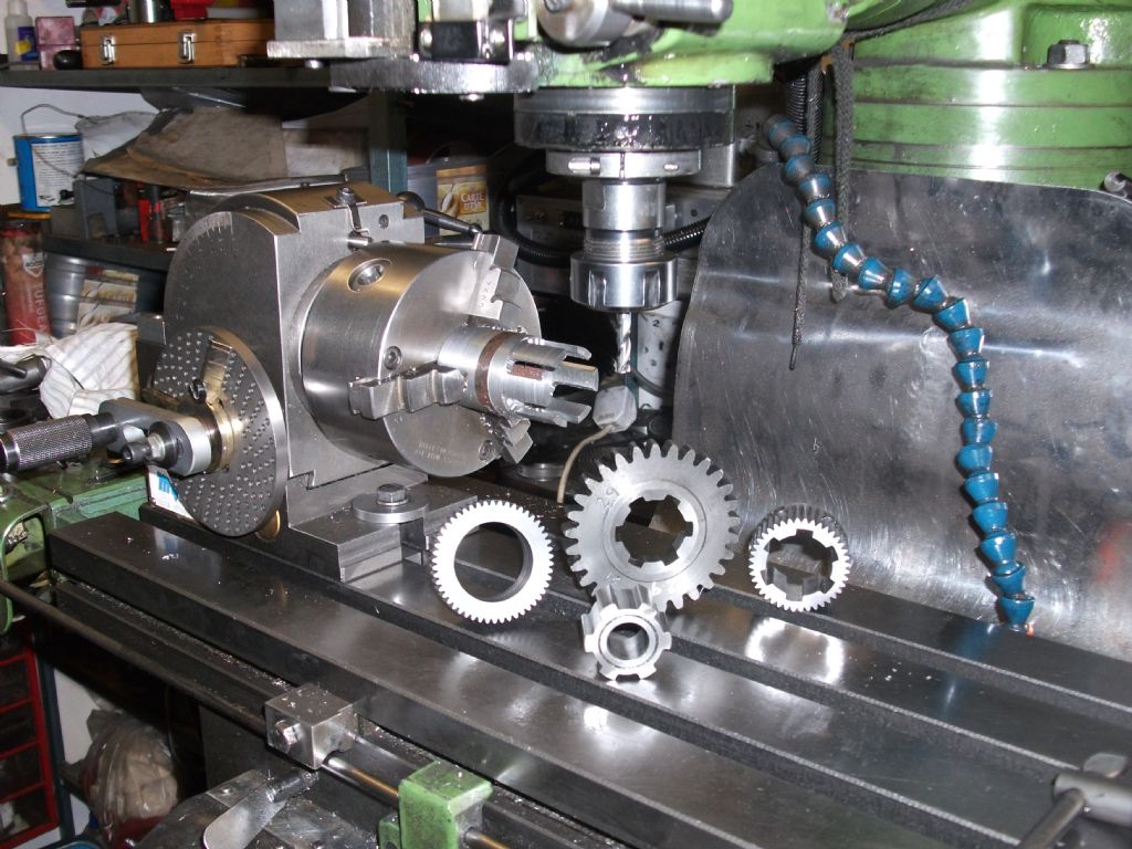

      The change wheels are 2.5 module at 20 deg PA and it is unlikely that you will find another
      machine that uses these sizes at only 10mm wide.
      The real problem if you have to make them is if the Chester variant of this machine is the
      same as the Warco is the Six spline hub used for the mounting , see the photo in the
      last post i made on the 26/06/2021 10:40:54 .

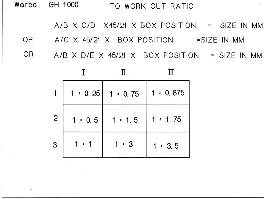

      The machine has not got a Norton gearbox ,the feed change gearbox has 9 speeds ,the
      diagram here shows the output for 1 revolution input as you may see in position 3 and III
      is 3.5 revolutions output.
      The calculation using the change wheels , outputs the size in mm = pitch for 1 revolution
      of the chuck.

      If you look at the 3rd panel down on the change wheel chart 8 columns along mm per rev
      you will see the listing 2,4,8 and above A36 B27 D28 E30 ,these are the only screw cutting
      pitches that you can do with the change wheels that you have.
      You can not change to imperial thread cutting as Howard suggests by fitting a 127 tooth and
      complementary gear ,on this machine it just will not work at the lead screw end of the
      gearbox when changing the drive from the feed screw shaft to the lead screw ,the change
      in position engages a 45 tooth to 21 tooth gear which ruins any calculation.The machine
      however with the full change wheel set can do a fair number of imperial pitches with
      a very small error on a 10 tpi pitch the error on 10 inches of thread is
      only 0.00027 inches.

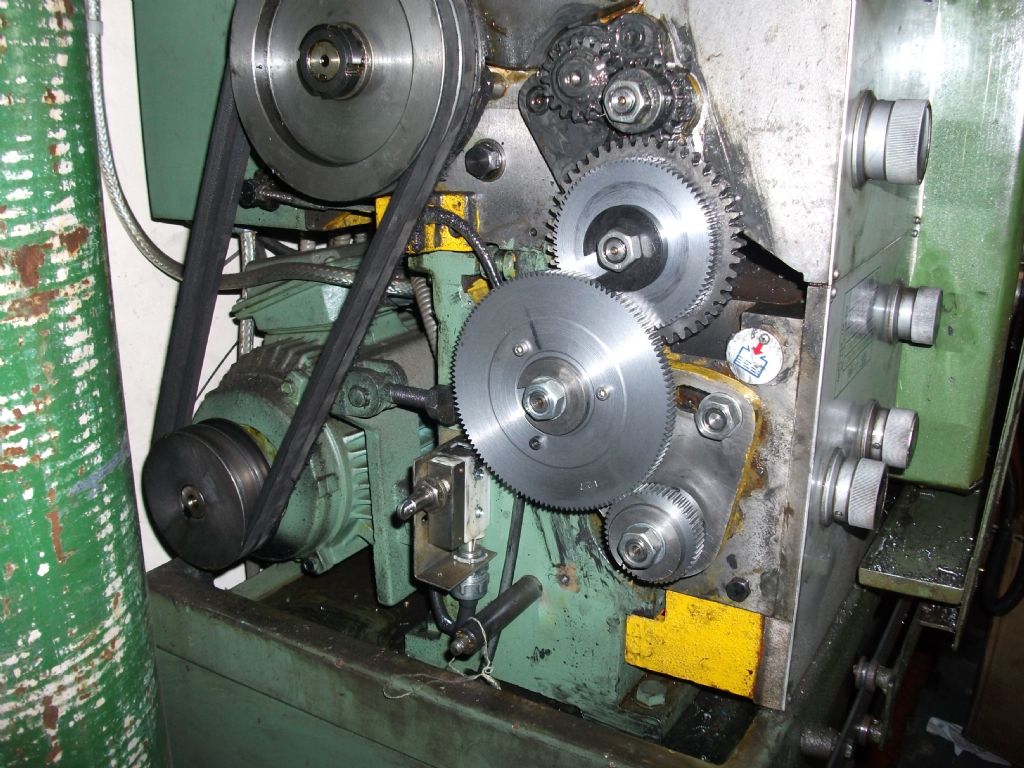

      The photo here shows the gears.

            My machine is similar in that the splined hubs revolve on the plain shafts and as
            such could be replaced as in your situation where that you do not have a full set
            of change wheels, you will have to remake or modify the hub that is the A gear
            stud this links the 45 tooth 2.25 module gear that provides the drive from
            the lathe spindle via the 2 17 tooth gears . The 45 tooth gear
            is also mounted on this same splined hub as the A gear.
            The drive out from the machine here is at 1/4 spindle speed and i expect
            that is why the change wheel gears are 2.5 module as the speed drops
            so the load goes up in the same proportion. The bonus here is the
            change wheels are very quiet in operation as even at top spindle speed
            at 2000 rpm the change wheels are at only 500 rpm.
            It would still be worth trying to get the missing change wheels to avoid
            a lot of extra work.

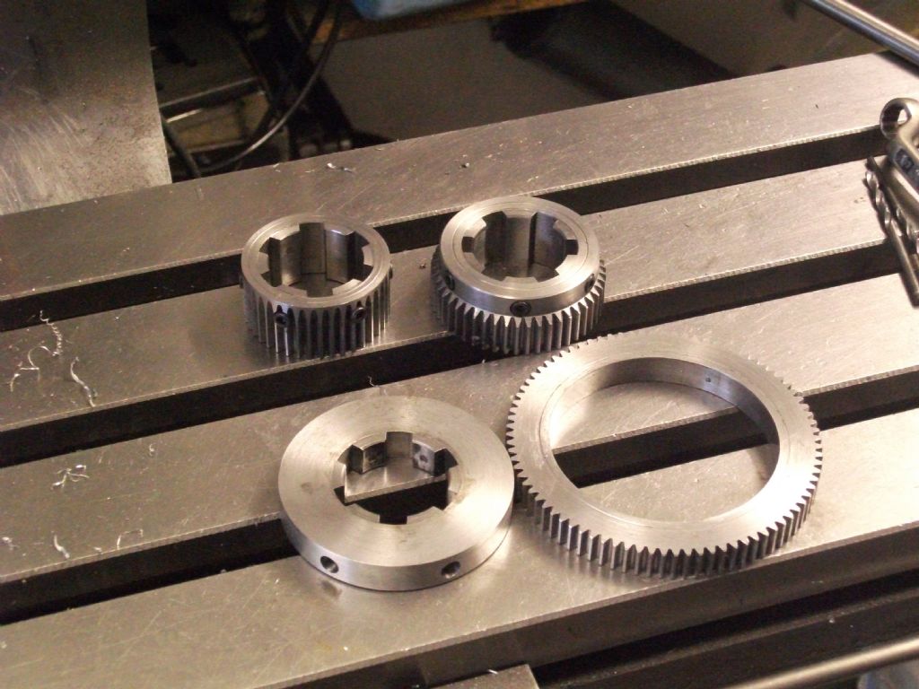

            It is well to note the outer diameter of the splined hubs are the reference diameter
            for the gears to run on ,so if you were to make the internal splines in the
            gear blanks this diameter needs to be concentric with the gear teeth.
            I faced a similar problem when i made some of the gears for the 127 gear
            metric /imperial conversion , i made a fabricated spline as seen here in
            the photo the inner part is milled and the hub can be used as a gauge ,an
            outer ring is fitted over and loctited in place with a keeper in place
            to hold the parts until the loctite sets ,then 6 m3 screws are drilled and
            tapped into each spline segment before parting off ,the gear is pre-made.
            Providing care is taken to get the parts sized properly and the inner ring
            bored and turned at the same setting a perfectly good fitting splined gear
            will result , a little tedious to do but probably easier than cutting an
            internal spline .

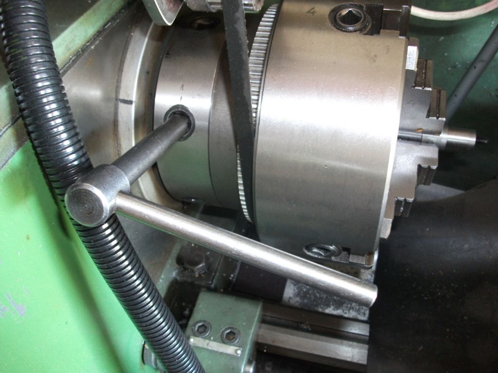

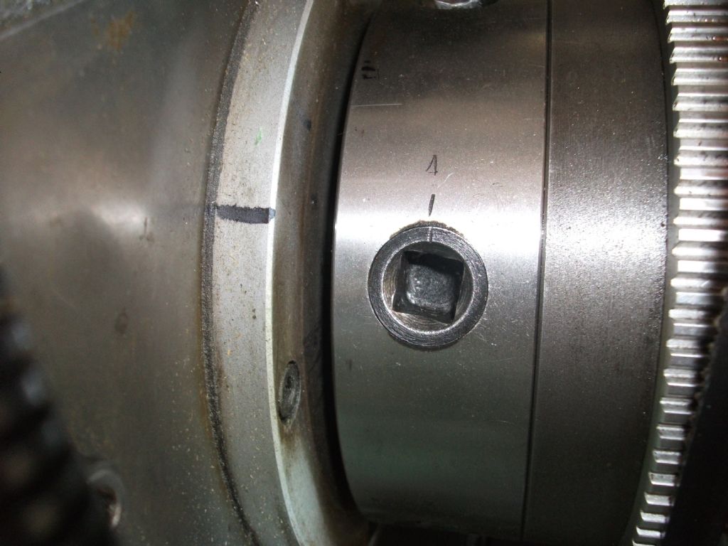

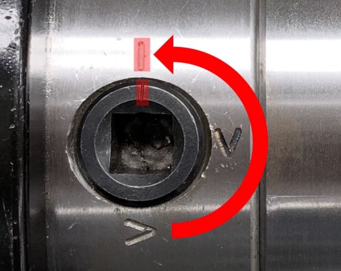

                  So, today's query. Not urgent but will definitely need to work out a fix at some point: the (D1-5) camlock pins are stuck absolutely solid. I balked at the idea of paying £14 for a proper 11mm key, so instead did the sensible thing of spending all day making one, as well as buying a drilling vice to complete the project – make your own things, they said, save money, they said…
                  Anyway, the camlock sockets are the normal type, with v-indicators at three o'clock and six o'clock, and the socket arrow pointing somewhere in between them. All six sockets look like they're in the right place, I don't think there's any funny business going on like being tightened the wrong way, etc. It's either rust or the chuck was installed by the incredible hulk. I had a go with a helper bar, and bent the tommy bar, which is 8mm EN1A rod.
                  What should my next steps be? I assume a bit of WD40 won't do any harm, but otherwise I'm at a bit of a loss, and google doesn't seem to know much about it either.

                    Oil and wait is always good, also which is the correct direction to loosen them?

                      I have the two V indicators similar to this pic (not my lathe):
                      I don't have the I indicator at the top, but the socket itself is pointing between the Vs so I am fairly sure I should be turning anti-clockwise to vertical:
                      I've got WD40 on hand, though I've seen suggestions that more powerful alternatives might be better – but I've no idea what they might be!

                        Here is the D15 socket on my Warco lathe ,the only makings here are
                        as you can see ,when the two marks align the stud is unlocked.
                        The photo that you have shown is a more normal representation
                        for a D mount arrangement the two > < indicate the position
                        of the mark on the spindle flange providing the socket line is within the
                        two marks the chuck is locked.
                        I would guess that your chuck has been tightened for some time
                        and the studs seem over time to grip quite strongly ,as you have said
                        from the open position at the 12 o'clock the socket is rotated
                        clockwise to stop at about 5 o'clock in the locked position.
                        Is there any reason that they should be rusty ,is there any rust showing
                        around the chuck or anywhere else.
                        The key shown here has a lever shaft of 10 mm dia and a bit tougher
                        than mild steel.

                          Thanks John, that does make sense. I don't have any particular reason to suspect rust ingress – the likely explanation is simply that the chuck has probably never been removed since it was mounted ~20 years ago. That's interesting what you say about the connection getting tighter over time. Certainly sounds a better plan than having it shake itself loose!
                          I'll give it the WD40 and see if I can apply a bit more welly to it. I'm a bit wary about going full hulk on things like this because I can put a bit more weight into it than the designers may have had in mind!

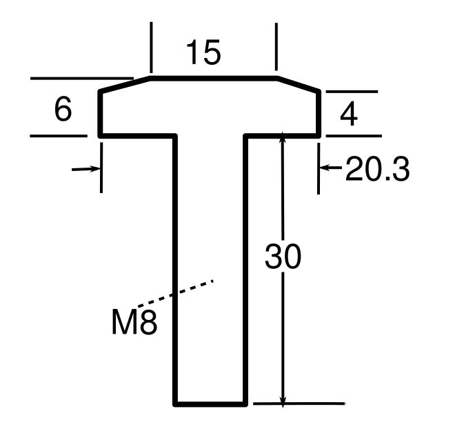

                              For various reasons I've been meaning to take the cross-slide off and have a look, so though I would add a note about my experience here. Removing it is simple enough:
                              • Compound off
                              • Unscrew the mounting bolts for the leadscrew
                              • Remove the leadscrew
                              • Remove the two machine screws holding the cross-slide nut in place
                              • Undo the plate at the front covering the gib adjuster
                              • Unscrew and remove the gib strip
                              • Slide the cross slide towards you – you have to lift it slightly for clearance (note that the brass cross-slide lock is loose and will fall out easily if you tilt the slide when carrying it)
                              I say simple – I may be omitting one or two steps that turned out to be unnecessary!
                              The large hole at the bottom locates the compound, the slightly smaller hole above is to access the T-nuts that run in the circular T-slot to hold the compound (of which more anon). The very top hole is for oil, as are the two on the bearing surface. Then the remaining three are for the cross-slide nut.
                              The cross-slide nut itself is two blocks of brass (or bronze) pinned together with a wedge on which a grub screw in the small hole bears. This can (I have now learnt after googling!) be used to reduce backlash: tighten up one machine screw, adjust the set screw on the wedge until backlash is eliminated, then tighten up the other screw.
                              I successfully got the T-nuts out through the access hole. One of the threads is stripped so I need to make or find replacements – I have had a quick google and can't see anything that looks like a standard part, but fortunately I have a lathe(!)

                                I've been working today on my fixture plate in this thread:
                                https://www.model-engineer.co.uk/forums/postings.asp?th=177296
                                which I will update separately, but as I also managed to install my replacement t-nuts today, I thought I'd add a note about them. I'm not sure if the lathe came with a stripped thread or if I managed to damage it very early on, but it's always been loose enough that the nut could be tightened so that it "jumped" over the thread, so I couldn't lock one side of the compound down properly.
                                Originals in black – you can see the stripped thread! As you can see the threads are not an especially tidy job – my order of operations was not optimal. I copied the original dimensions except for making the overall length just a few mm longer. I'd like to say it was skill but it was more like sheer luck that the end result sits pretty neatly:
                                I'll add a quick sketch with dimensions just in case anyone ever finds it useful.
                                  The dimension across the flats is 13.5 (all in mm).
                                  The original nuts had a 30mm shank; I made mine 33mm and they fitted neatly.
                                  The only noteworthy thing about making them, perhaps, was the small taper which provides clearance to install the nut – this is an awkward angle to cut with the compound, so I swung it round the other way and ran the lathe in reverse with a tool held like a boring bar. That and a healthy workout with the file to make the flats!

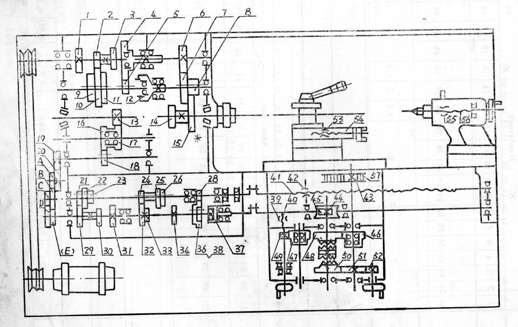

                                    I'd like to have a go at making gears to make up the missing changewheels that I have – I think I'll do a separate thread about them as it may be of more general interest but I'm just trying to understand the gear train of my lathe:
                                    Beginning with the spindle, wheels 13,17,16,18, 19 and 20 have 45, 45, 45, 68, 17 and 45 teeth, so for one turn of the spindle A will be turned 45/68*17/45 times = 1/4 which is what John P wrote last year…so far so good!
                                    Q. Where/how is the reverse in this diagram? Physically on the lathe it's somewhere round the wheels labelled 17-18 but unless the reverse mechanism is not drawn I don't see how it works.
                                    In the quickchange box, 21/22/23 mesh with 29/30/31, giving ratios of 20/40, 40/20, 30/30 which corresponds with the 1/2/3 knob. Like wise the second knob, 24/25/26 mesh with 32/33/34 giving 20/40, 42/24, 36/24 (1/2, 7/4,3/2).
                                    Finally, if the leadscrew is selected the drive is fed through wheels 36 to 28, which are 45/21.
                                    Q. Am I right in thinking the manual states it is a 4mm pitch leadscrew? Slightly alarmingly it gives "module no. or pitch" as '4 or 1/6" '. Now 4mm is close to 1/6" but it's not that close!
                                    Putting all this together, If I choose to cut a 4mm thread, I take A,B,C,D=36,27,28,30 teeth from the front chart and select 2,II (30/30, 36/24). One spindle revolution then gives:
                                    1/4 * 36/27 * 28/30 * 30/30 * 36/24 * 45/21 = 1 turn of the leadscrew, so if it is a 4mm leadscrew we've got a 4mm pitch. Phew.
                                    When the feed is selected, the 45/21 drops out and the feed rod turns.
                                    Q. What is happening at 44/45? Clearly this is where torque is being taken off the feed. Then (assuming carriage feed engaged) 48 drives 46 which drives the wheel engaging the rack? But what are 50/51/52 doing?
                                    Similar for the cross-feed I assume 47 engages 48, in turn driving 49.
                                    I'll add the manual pages for the gear list to my lathe album should anyone feel inclined to try and make sense of it!

                                      Posted by Calum Galleitch 10/04/2022 17:22:06
                                      which are 45/21.
                                      Hi Calum
                                      The gear chart is depicted as a diagram and as such lacks the detail
                                      needed,the reverse feed is the 16 and 17 cluster gear ,in reality
                                      the gear 13 directly meshes with gear 18 ,i think the gear 18 slides along
                                      a spline and sits in the gap between gear 16 and 17 for neutral
                                      and connects to gear 13 via 17 and 16 to 18 to reverse the rotation.
                                      It is some while since i have had the lid off so this is from memory.
                                      Gear 44 is a worm that engages with the slot on the feedscrew that drives
                                      wormwheel 45 and is the input drive to the apron.
                                      The auto feed clutch dog either drives the apron along the bed through
                                      gear 50 to 51 ,51 is connected to gear 43 which drives along the rack
                                      57 under the bedway.
                                      When the auto feed clutch is in the other position (it is quite poorly drawn)
                                      gear 48 drives gear 47 through gear 46 to gear 48 which is part of the
                                      crosslide leadscrew.
                                      There may be some differences from the 750 machine that you have and the
                                      GH 1000 i have as if you look at the photo's the handwheels are in different
                                      positions ,this may not affect the operation but the gears may not be the same.
                                      Edited By John P on 10/04/2022 22:50:03
                                      Edited By John P on 10/04/2022 22:52:48

                                      John P
                                        @johnp77052
                                        Posted by John P 10/04/2022 22:49:12
                                        This should have been,
                                        gear 48 drives gear 47 to gear 46 to gear 49 which is part of the
                                        49 is not listed as a gear but is the crosslide leadscrew at the top of
                                        the page 6 of the manual and is part of item 40.

                                          Thanks John, that certainly all makes sense and I'll just have to do a little testing to make sure it matches up with what we expect!
                                          I didn't realise until I'd posted that the next page of the manual lists the full transmission ratios for the various systems, so that will help in tracing what goes where.

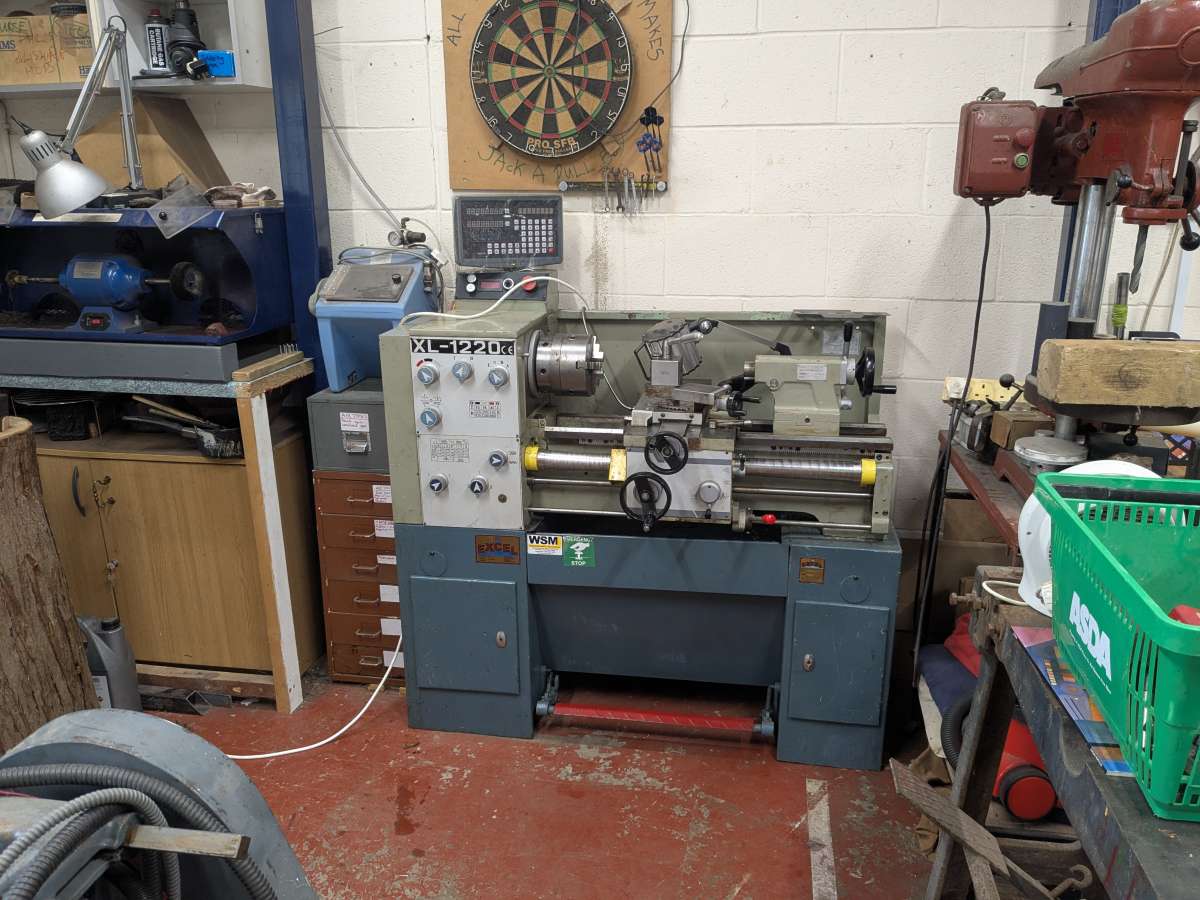

                                            <p style=”text-align: left;”>Hi Calum,</p>
                                            Having just picked up an Excel XL 1220 (which looks almost identical to your lathe) I’ve enjoyed reading this this post.
                                            Do you have a copy of the manual that you might be able to share please? I don’t have any documentation with mine at all.

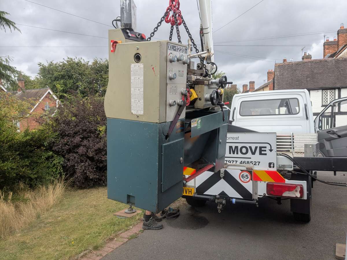

                                            Having read your post about moving the machine, I’m grateful mine was relatively easy! I definitely made the right call in hiring a guy with a Hiab, but then we had a bit of fun in my workshop with a pump truck and sack barrow trying to get it into place 😂
                                            PXL_20250814_085909246PXL_20250814_115830929
                                            #813292
                                            Charles Lamont
                                              @charleslamont71117
                                              ISO 32 will be a plain hydraulic oil. (Begrudging the price charged by model engineering suppliers for 1 litre, which is all I really needed, yesterday I bought a 4-litre can of Morris Liquimatic No4 for £20 at TFM, our local agricultural store.)
                                              Looking at the shed, also for your shopping list, a dehumidifier?

                                                If the picture is to be believed I would not be impressed at lifting with chains on the bed or any other part of the machine. That’s what rope or nylon strops are for, or if fitted lifting rings or eyes. Noel.
                                                #813301
                                                John Hinkley
                                                  @johnhinkley26699
                                                  If you enlarge the photo, it reveals that the chains hook into strops passing through holes in the machine stand. Though they appear to be possibly putting a strain on the knobs on the panel on the left front of the lathe, that maybe parallax error.
                                                  #813391
                                                  noel shelley
                                                    @noelshelley55608
                                                    AH, yes I see, partial forgiveness then. Noel.
