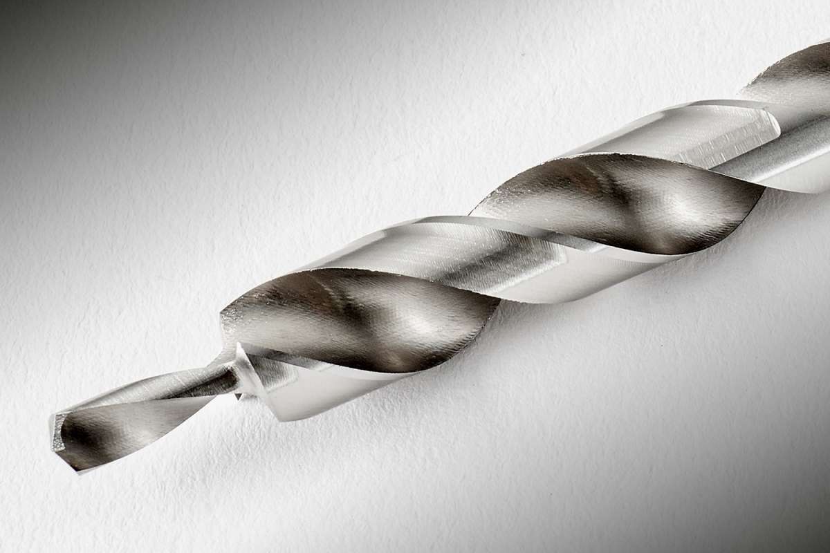

            In my experience counterbores produce aesthetically over size looking holes for my liking. As a result I’ve made a number of them from silver steel.
            Another way is to make a combined drill bit/counterbore by grinding a long “pilot” on a suitable size HSS drill bit.
            This commercially available Pocket Hole bit shows the sort of thing. Easy enough to make with a battery drill and a bench grinder.

              Our Tool-Makers used to grind their own, by modifying a drill-bit
              Edit: __ Like wot Vic illustrates !

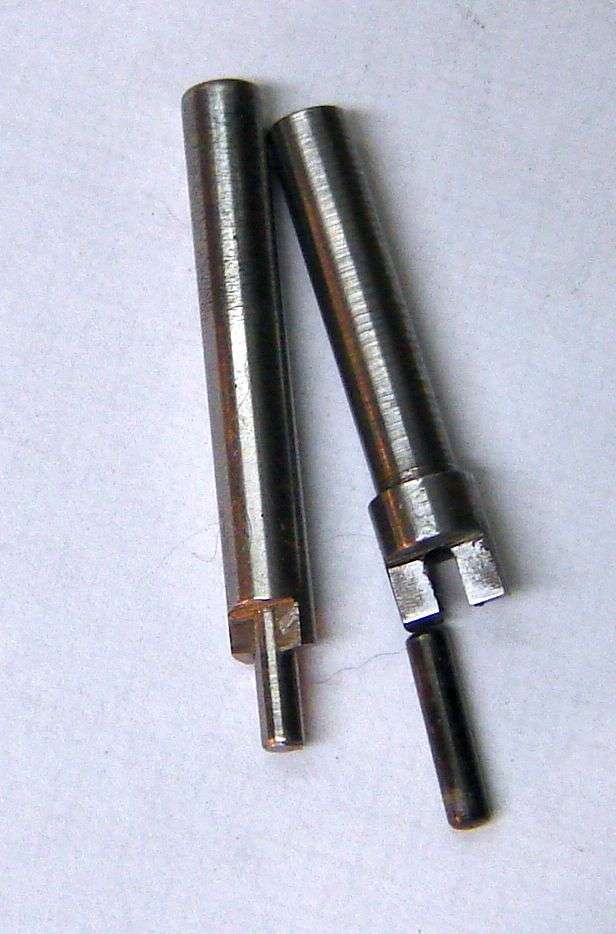

                    Paul Lousick
                      @paullousick59116
                      Make your own custom size counterbore from silver steel.  These are easy to make and sharpen and suitable for occasional use.
                      https://gadgetbuilder.com/CounterBore.html

                      bernard towers
                        @bernardtowers37738
                        Couldnt agree more with Paul, you can then make them with the clearance you are happy with. I have a set of comm metric ones they never get used as the clearance is huge.

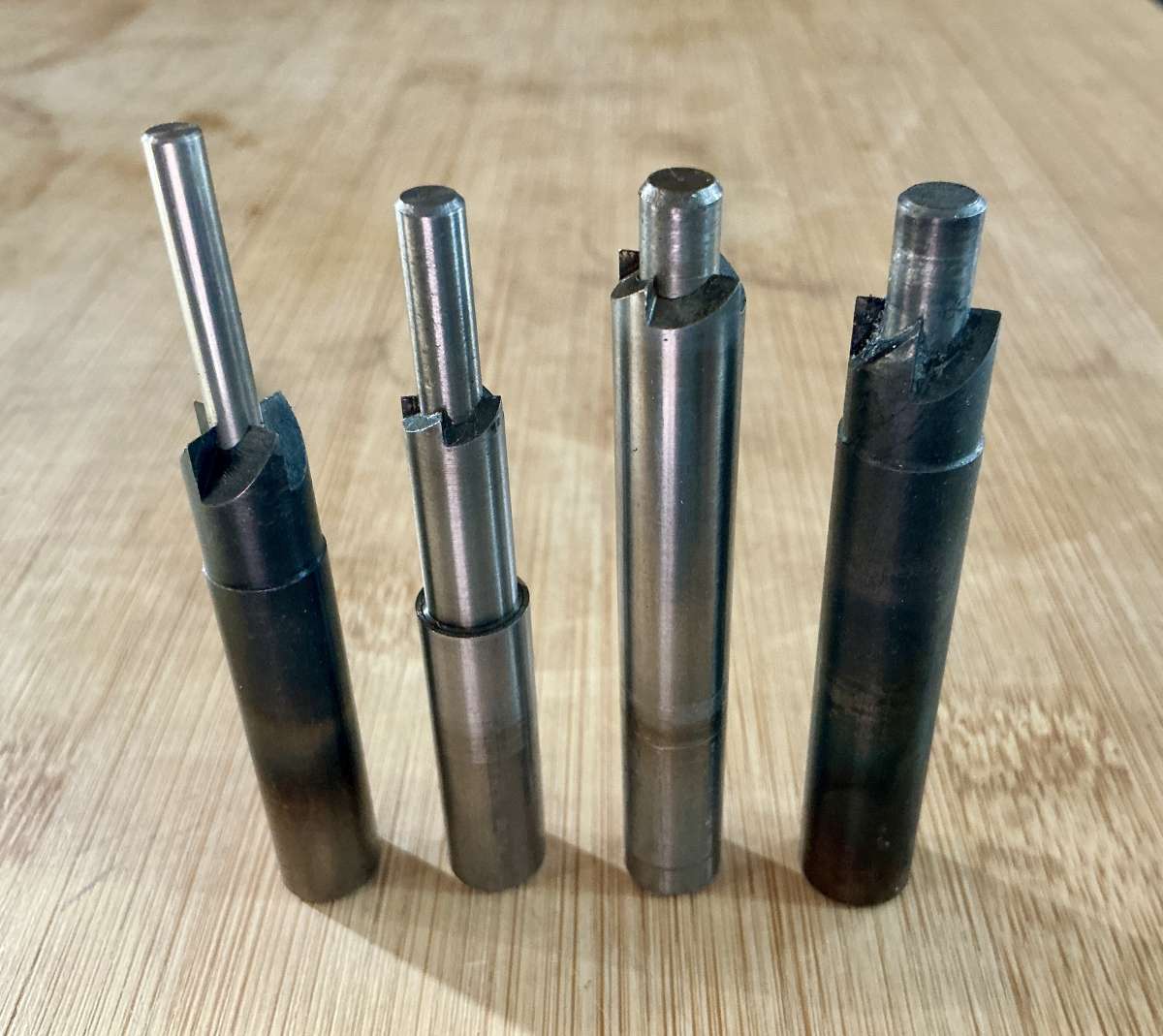

                            Vic
                              @vic
                              On Paul Lousick Said:
                              CounterBore0
                              That’s quite an odd design for a countbore?
                              These are some of the four teeth ones I’ve made from silver steel. I harden but don’t bother to temper them, I just leave them glass hard. I’ve not had one chip yet. The angle of the teeth is easily cut for whatever material you intend to counterbore.

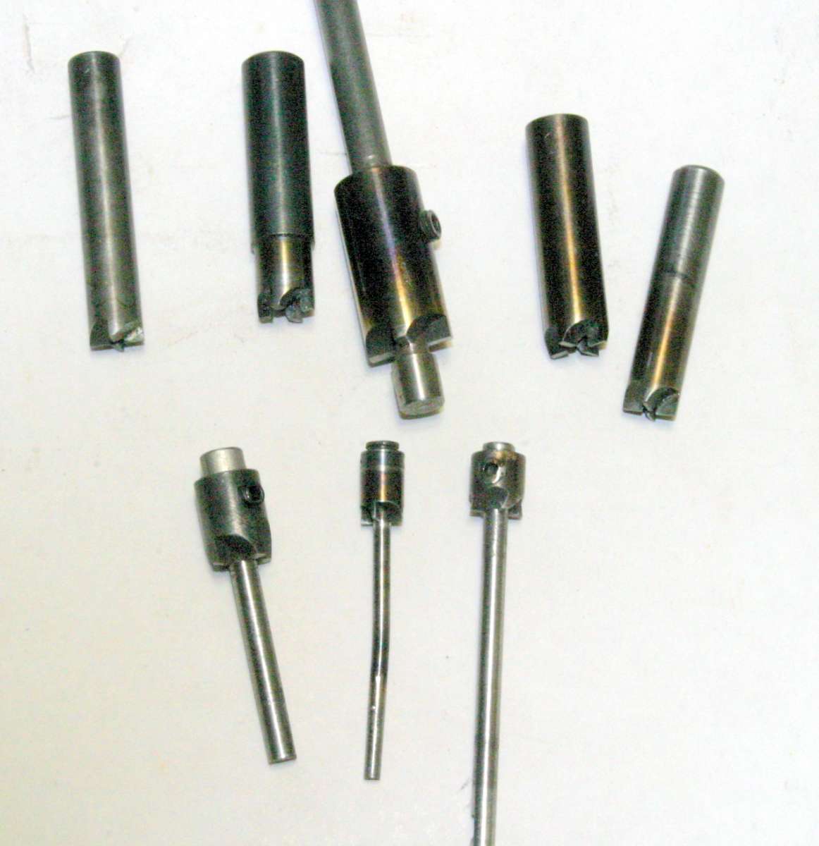

                              John Purdy
                                @johnpurdy78347
                                I make mine like Vic’s out of drill rod ( silver steel). The top 5 have inter changeable pilots. The bottom 3 are for reverse facing castings for the seating of nuts or bolt heads where access is restrictedCounter Bore. As can be seen I let mine down to light straw rather than leave them dead hard.

                                Charles Lamont
                                  @charleslamont71117
                                  I make my own too. For tempering silver steel tools, lately I have been giving them about 15 mins in the air fryer at 200°C. It hardly changes the colour or hardness at all, but does considerably improve the toughness.

                                  Vic
                                    @vic
                                    I generally super glue the pilots in so I can change them if needed.
