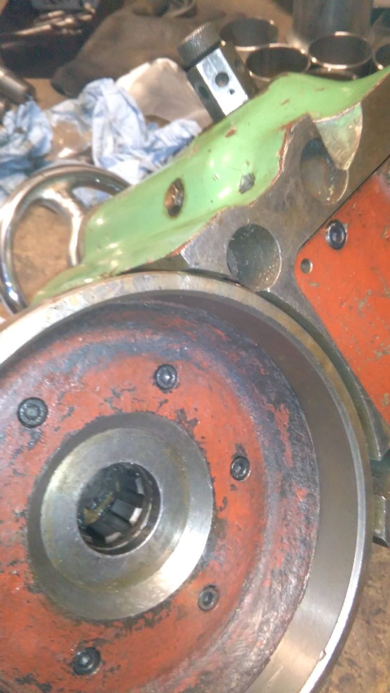

      Hi I have been asked if i could make an adaptor for a NU4 Huron milling m/c vertical drilling or milling head attachment with a 40 INT drive
      Has anybody got one or any information about one please
      Or what would be the best material to make one out of Ie. EN8
      I have taken dimensions to make one but if i could lay my hands on one it would be better and easyier
      Thanks steve butler

                I suspect that this adapter will be an ISO40 taper with some form of drive dog on the front, the form of which will mate with a mirror image version mounted on the head input shaft. i.e. a disc with a slot across the face with taper on the back, which mates with a tenon on the input shaft. Or a female spline in the taper shank that mates with a short splined input shaft on the head.
                I should not be too difficult to measure up the input arrangement to the head to reverse engineer a suitable adapter to fit. As has been stated above, the ISO 40 dimensions are readily available, as are "tool blanks" like this example **LINK**

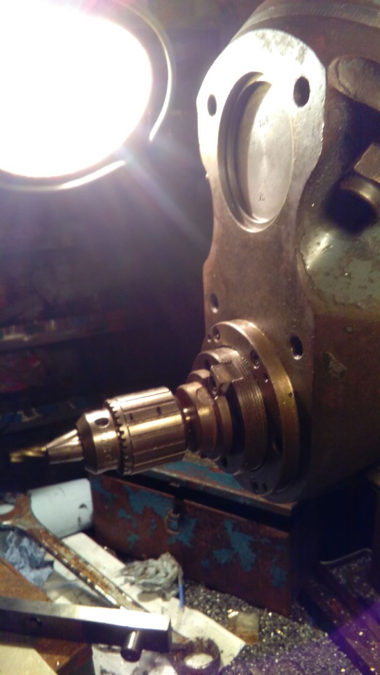

                  The one i have to make one for is similar to this one showing the adaptor next to the head i don't now of the heads origin
                  I was thinking of getting a drill chuck arbor without the chuck and turning it down parallel l was then going to turn up a drive dog and mill the teeth or mill the gaps and fit key steel and then fit to chuck adaptor

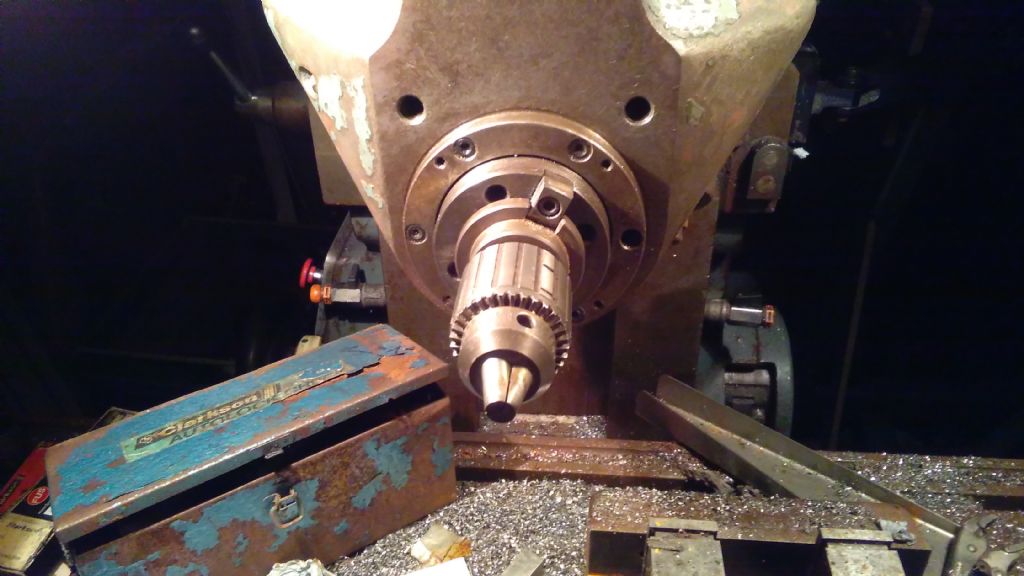

                      Are you able to say what is the purpose/intended use of such an adaptor?… I have not come across such an adaptor. We have a Huron MU6 in our workshop. It came with a pallet full of accessories. I went through it this afternoon and found the drilling attachment… pictures below, but unable to find an adaptor of the type shown in the ebay picture or your description. So am a bit curious about the use of such an adaptor.

                          It looks like Steve 'wants to/needs to make' an INT40 adaptor like the one in the ebay picture – which has some kind of splines at the working end of the adaptor….for some kind of specific application… see ebay listing: 221963367303 and zoom in on the adaptor in the picture.

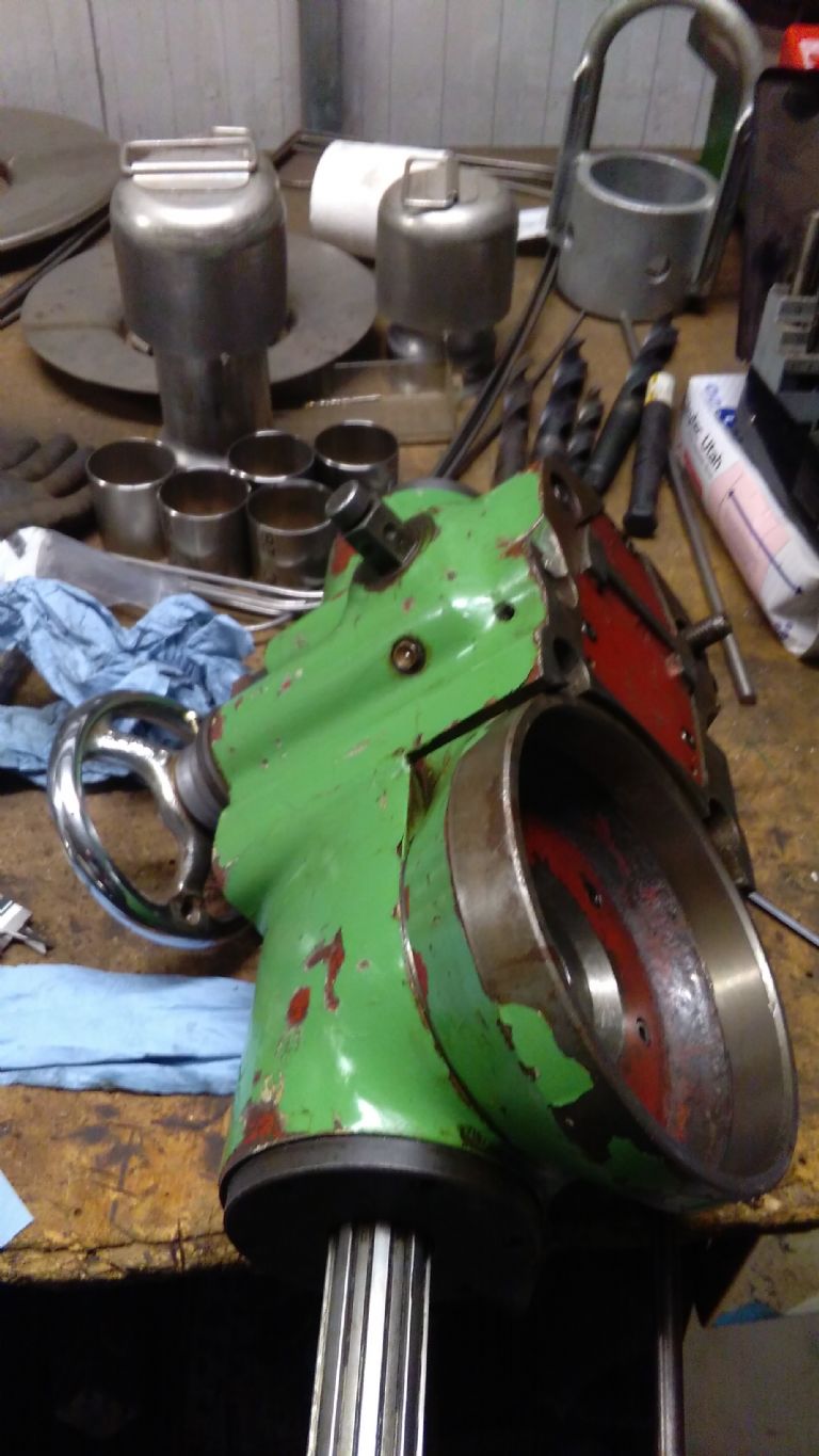

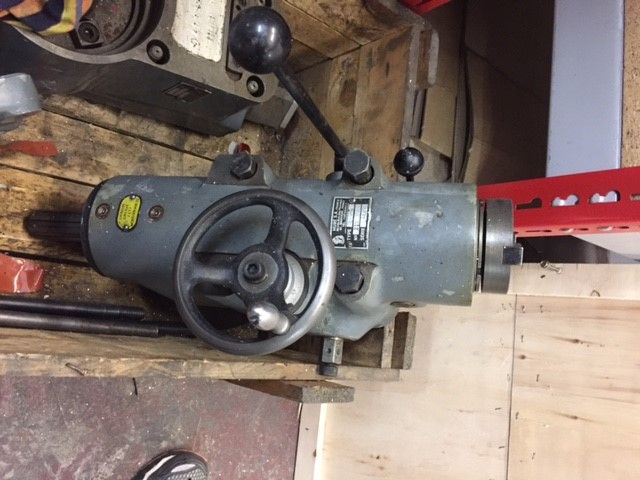

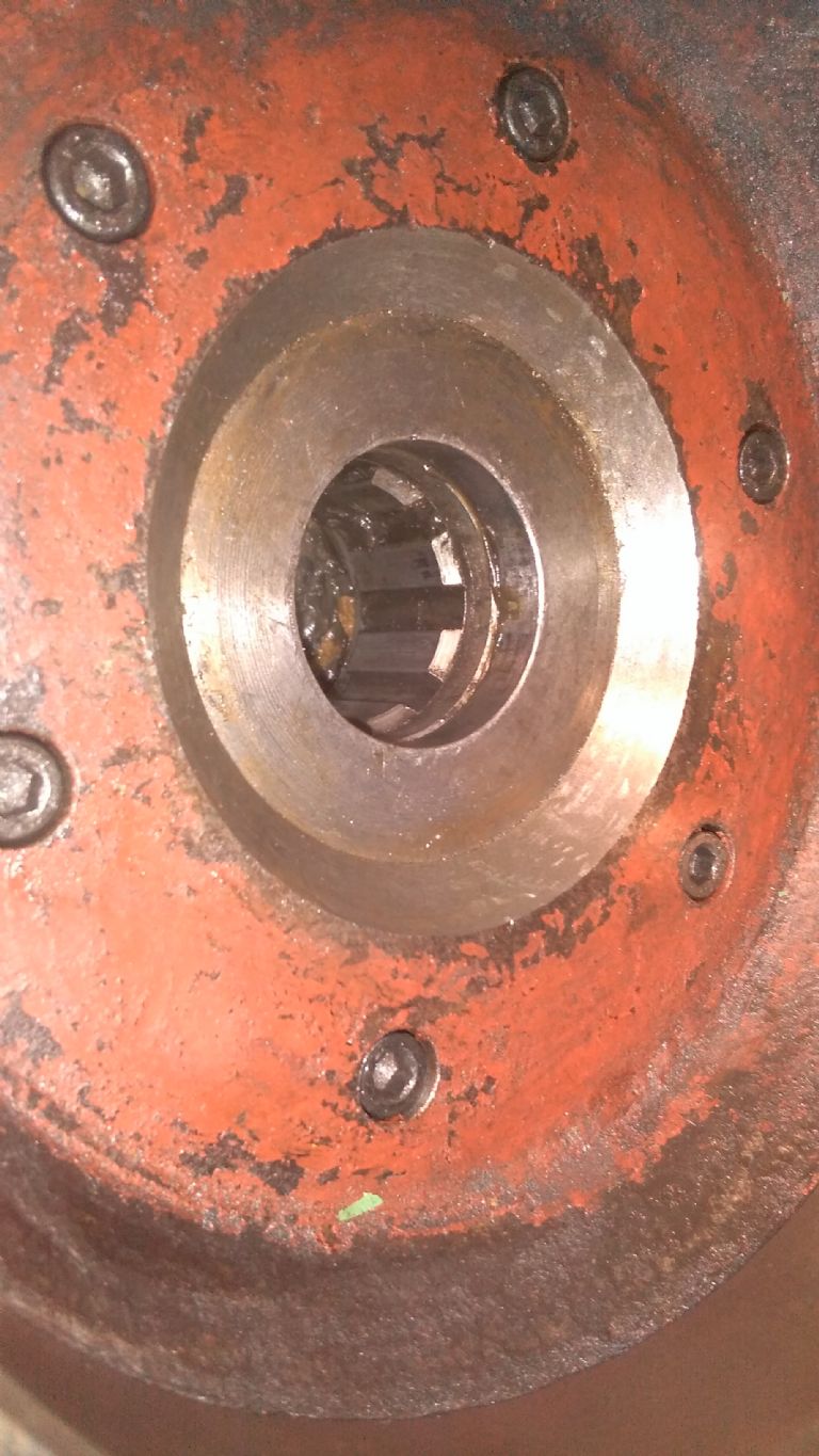

                            "Adapter" here means "drive shaft". The Huron NU4 appears to be a horizontal mill – the "adapter" changes the horizontal 40 taper into a short splined drive shaft that engages with the input gear to the right angle attachment. If Ketan could take another picture of the mounting face of his right angle head (to the right of the spindle nose on the bottom picture posted above), then the female spline on the input shaft should be visible.
                            The Lagun double angle heads we used to fit to Butler Elgamills at the last place I worked were a little less sophisticated – the input shaft to the head was a disc with a slot across that was then same width & depth as the horizontal spindle drive dogs. No "adapter" required here, just care making the plate to hold the head onto the end of the ram the correct thickness so the drive disc in the head just cleared the horizontal spindle front face.

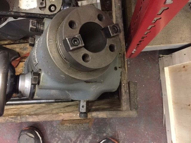

                              img_20161220_165737.jpgimg_20161220_165728.jpgimg_20161220_165647.jpgimg_20161220_165443.jpgHi all sb again Apologys for not being clearer. As Nigel has gessed it is the drive dog adaptor i need to make
                              Hopefully i have sent some photo's of the drilling / milling head that the adaptor fits between (INT 40 male one end and 8 tooth drive dog other end) hope this makes it clearer as previously thought i would possibly make one useing a drill chuck INT 40 drive turned down parellel and make a drive gear out of some EN8' ish material or what would be better
                              Sorry again for not being clearer and thanks again for all your feedback Steve img_20161220_165407.jpgB

                                    Apologies for the scabby sketch below (hopefully – this forum software is a pain !), but I hope this will show why I don't think a standard tool will be easy to modify. Top section shows how a standard flanged tool fits & bottom section shows how I think the splined shaft adapter fits the spindle
                                    The splined drive shaft (adapter) shown in the Ebay link has two driving tabs, not a drive flange with two drive dog cutouts like a standard tool. The picture of the input spline at the back of the right angle head shows very little clearance between the back of the head casting for the spindle nose. I think that the splined drive shaft is fitted to the spindle with the drive dogs removed, so that the drive tabs are below the spindle front face. On a standard tool the existing drive flange & some of the taper will have to be removed to allow an additional part (preferably part of the splined piece) to have the tabs machined on such that the tabs fit below the spindle nose front face. Standard tools (including blank arbours) have the taper shank & drive flange hardened, so removing them will not be easy. Probably better to try to make the "adapter" as one piece as shown in the listing. To find the taper diameter at the drive base of the drive dog slot, remove the dogs, put some layout blue (or indelible marker pen) on a cleaned tool shank, insert the tool in the spindle & scribe the tool shank from teh bottom of the slots, then measure the diameter on the taper across the scribed lines. For what it is doing, I don't think you need a "full" taper, so the middle portion could be relieved to give a two tapered bands (one at each end) to locate in the spindle taper.
