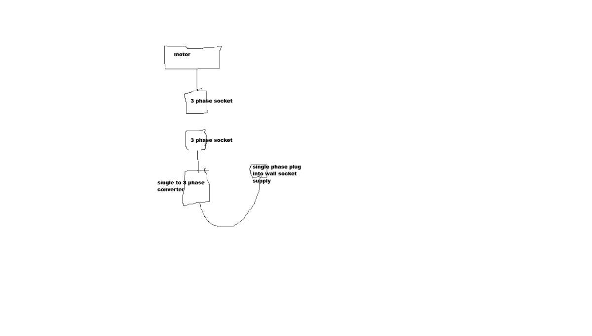

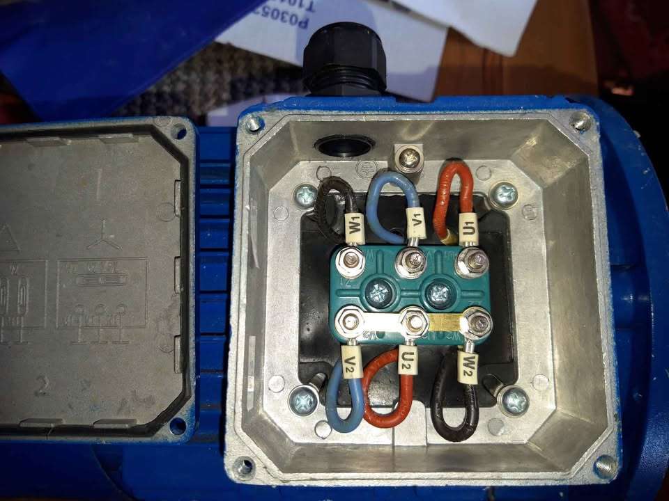

      So, I have a 3 phase motor, dual voltage. It has come with no cable for it. So I obviously need to wire one in.
      It will be powered by single phase power, converted by a single to 3 phase converter.
      I am wondering which wires to use for the cable? Is there an amperage rating I need for the wires?
      Ideally I want to make the lead on the 3 phase motor have a male socket on it, (will this be 4 or 5 pin?)
      and have the 3 phase lead from the converter have a female socket on it.
      Will I need just the 4 wires for the 3 phase lead coming from the converter and the lead on the motor?
      This way I can unplug the motor and use the converter on a different motor.
      Here is a pic of what I mean:
      motorpic1

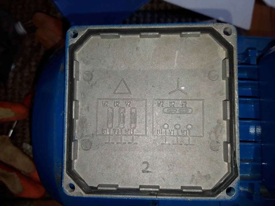

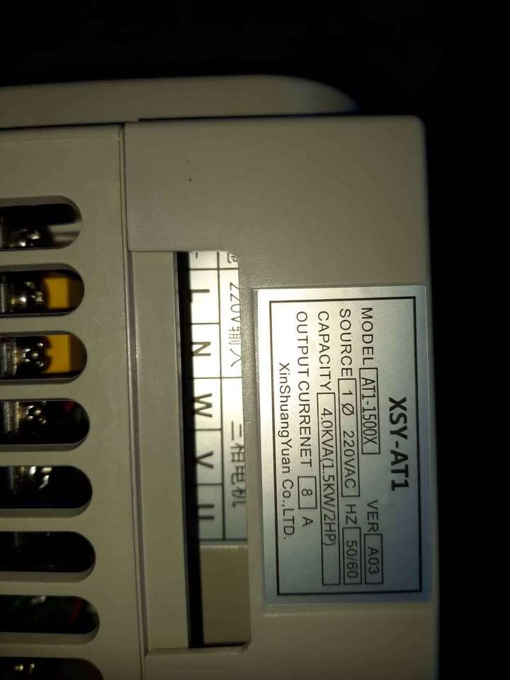

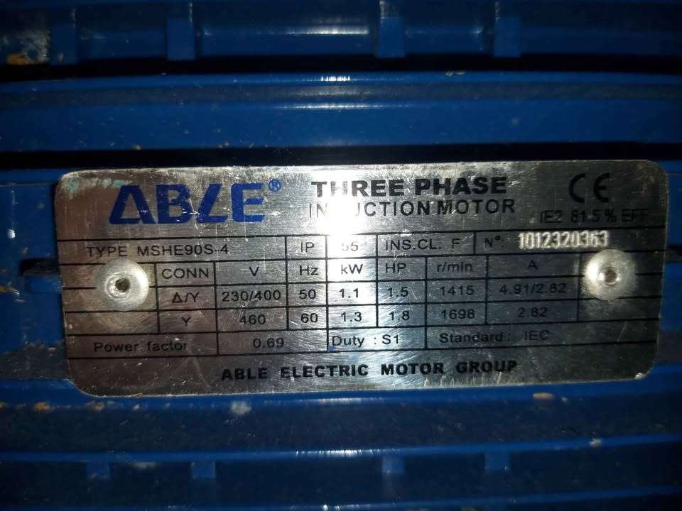

      Here are the pics of the motor badge, the wiring diagram for it, and the converter connections:
      motor3
      motor1motor4motor2

        The wire size is set by the VFD output current rating / input fuse rating. While 1mm2 woube adequate I suggest using 1.5mm.

        It is generally considered bad practice to put connectors in the output of VFCs. If you must then ideally yo should use a metal bodied connector like a Harting HAN series to reduce interference. A more available choice is a 3P+PE 16A red IEC 60309 “commando” plug and socket e.g.
        https://www.tlc-direct.co.uk/Products/MKK9007RED.html
        Don’t un-plug with power on, even with motor stopped.

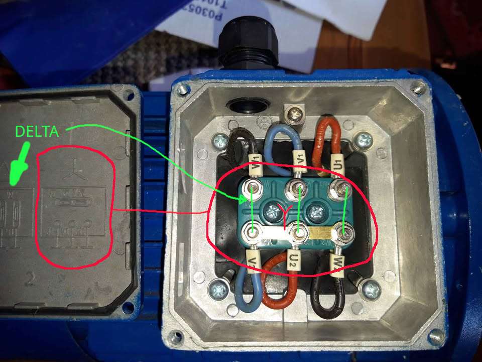

          A minor detail next.  The photo shows the motor terminals are currently strapped for STAR aka Y connection, ie 400V  rather than 230.   The straps need to be moved to the delta Δ configuration.  In the pic below, the existing Y connection is high-lighted in red,  you want to move the straps into the green position (delta), as per the diagram inside the lid.
          stardelta

              In the hand drawn layout picture it shows a socket attached to the motor. This should be a plug. Never use a male/male lead for connections.  Although I agree with Robert that its not really good practice to have a connector between units.  Also Noels point that this is really a job for a competent electrician is correct.

                  Well spotted Old Iron. I didn’t look at the sketch. You can easily get male or female 60309 connectors in cable or fixed mounting.
