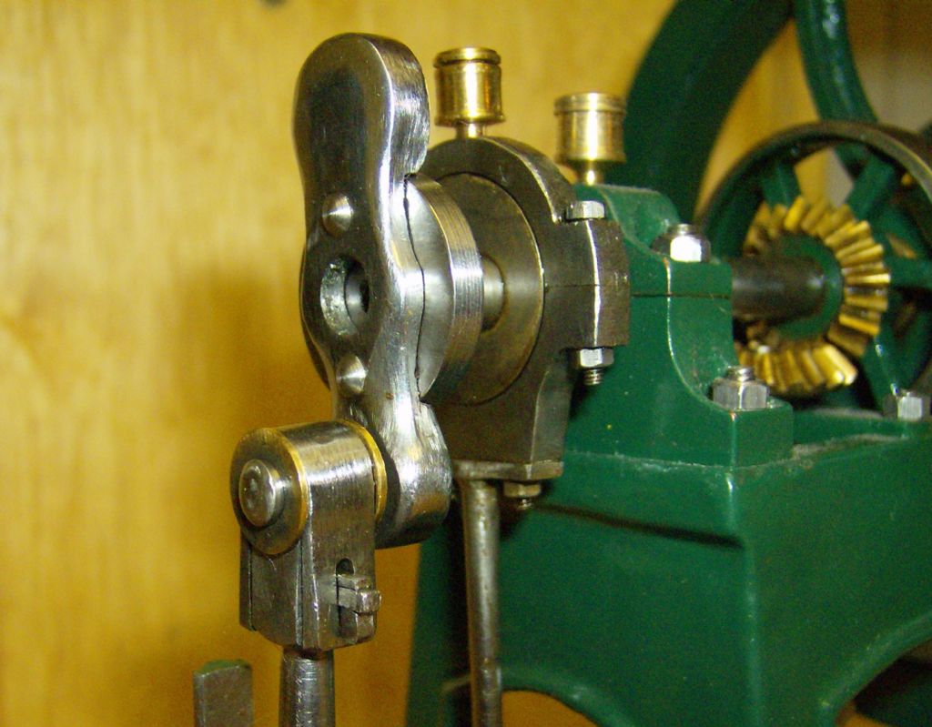

                  I would always use buttons for a part like that, but one day I'll get a linisher/disk dsander and try Chris' approach.
                  I've used the mill/rotary table approach for connecting rods, and it works, but I'm not sure it is significantly faster or easier than buttons for a single part.
                  Don't forget that, within broad parameters what matters here is getting the part to look right, so expect hand finishing anyway. The crank below was entirely done by filing buttons and hand, aside from making three holes. ( the top counterweight has a plug in it).
                  The crank and eccentric
