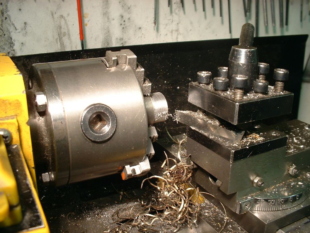

          Maintaining a stock of spares for a large range of hobby machines is one of the biggest costs for the companies supplying the hobby market, and this overhead is one reason why the bigger companies have to charge a bit more.
          If customers want them to stock a full range of all the extra consumables, like belts, when they can't compete with specialist suppliers who shift vastly more of them on price, then the cost of the machines would have to increase further.
          Don't be afraid to take decent cuts with a small lathe – I go up to 2mm on my mini-lathe in steel.

                I had another go this week end. I spent some time with one of the machinists at work on the Hardinge tool makers lathe watching him machine a piece of 1 inch round steel. He demonstrated how different speeds and feeds make a difference.
                I had better luck this time I used a HSS tool he ground for me. My lathe digital read out is not working so I don't know exact speed but it was a lot slower than last time I tried. I got a reasonably good finish. I switched to carbide and upped the speed a tad. I think I'm getting some were now. The work pieces are looking a lot better.

                  I bought some stainless 303 and some bright steel EN1A rounds to play with over the week end from M Machine.
                  A total disaster no matter what speed and feed carbide HSS it makes no difference the finish is terrible. I give up I'm going to get the guys at work to machine the project for me. Enough is enough its just a waste of my time.

                        The biggest improvement on the finish of a job for me was once I started using the tailstock to support the work
                        A decent live centre in the tailstock was a huge help, it can never make a job worse, only better. (For best results use a dead centre)
                        Now I use it all the time

                          I'm beginning to think its more to do with the way the lathe is set up than the actual tools etc. I noticed that the tool post was moving slightly when looking down on it. I had a good tug on the cross slide and saddle etc. Thee is a lot of play/slogger. I took the carriage off and reset everything then put it back together it took a few attempts to get it some were near. I adjusted the cross slide and started again. Using a honed HSS cutter things are looking better. The cross slide still needs some attention and I'm struggling to get rid of back lash. But we will see what happens.

                                  Finish is all about rigidity including the headstock bearings and cutter grinding. Rigidity mean a certain weights for a given size for the simple reason that when a very high quality finish is achieved minor vibrations will cause micron deep marks to appear in the work as metal flexes to some degree as minute as it might happen to be. Go far enough and the ripple from bearings that have rolling elements in them become a problem.
