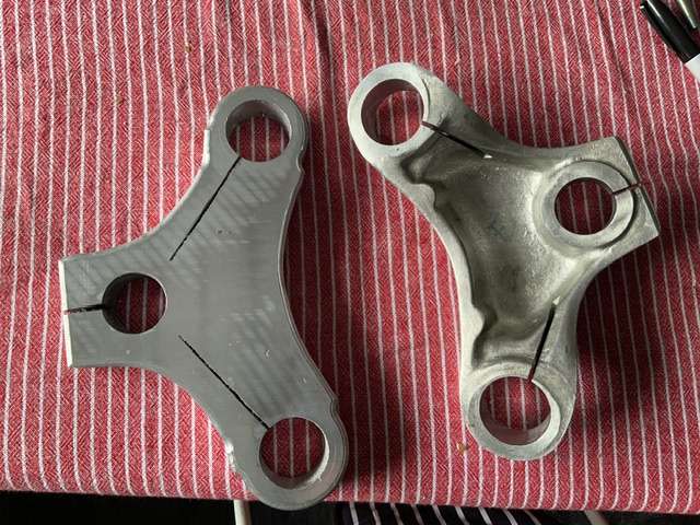

      I’m making a new flat top yoke for a motorcycle to mount handlebars onto directly..
      I’ve cut out a blank and bored the holes on the lathe and it fits well on the forks
      however i have to cut the clamping bolts slots…
      the back one is easy on the bandsaw but any ideas on how to cut the internal ones
      the holes are 35mm diameter and the alloy is 25mm thick…IMG_7506

        If you are happy with a bandsawn one for the easy cut then a hacksaw should do the others

        Clive Foster
          @clivefoster55965
          Hacksaw works OK but you may find the slot bit narrow.
          A power hacksaw blade is wider but harder to control. A relatively fine tooth one works well enough to enlarge an ordinary hacksaw blade slot.

            DC31k
              @dc31k
              Two hacksaw blades in the same frame to achieve a wider kerf.
              As the item is flat, you can clamp something hardish top and bottom (4 pieces total) to act as a guide so the cut does not wander (test cut on a piece of scrap so you can measure the kerf and thus the spacing between the guides.
              If you are jigsawing, you can clamp a similar guide on to ensure a straight cut.
              Are the yokes to be further reduced in size to more closely resemble the original? If not, the two slots you want to cut may not clamp up as there is a lot more metal surrounding them.

                DC31K. Sure they will be as original size wise the originals are cast and the underneath is hollow perhaps only 10mm thick in the middle section..not sure how to deal with the lack of squeeze..

                        Phil P
                          @philp
                          I think you will find that the slots will not give enough grip to the fork stanchions even when done up very tight.
                          The material will be just too stiff to deform enough.

                            Phil the split collets are a great idea but I’m slightly worried about locally crushing the stanchions..they are quite thin wall and with  an internal thread for the top nuts to hold onto to

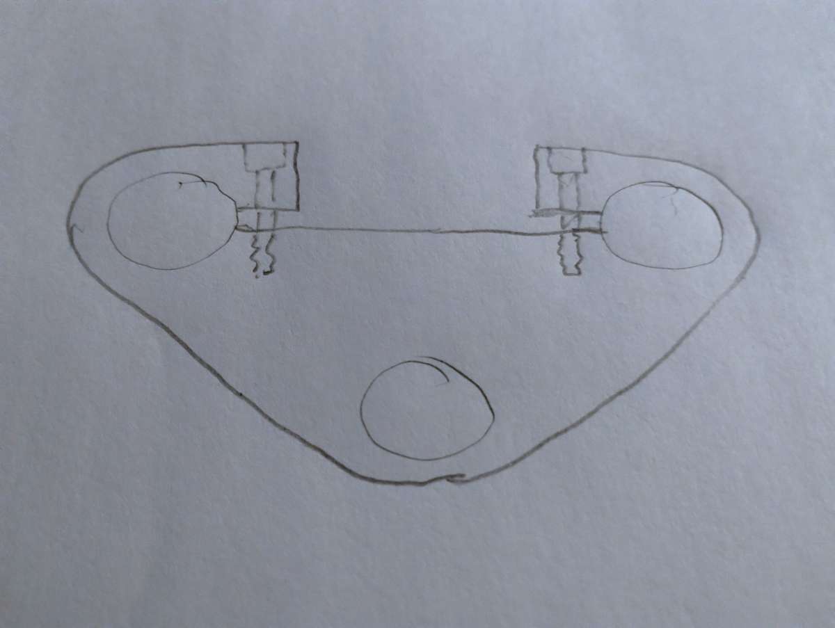

                              I wonder if you could put a slot right across between the two stanchions, that way you should be able to get in with a slitting saw, the long slot should weaken the material enough to get a grip with any luck.
                              You could actually remove some of the material between the stanchions at the front of the slot so you are left with shorter slots at either side with a couple of clamp scews on each. As per fag packet sketch below.

                                    Correct me if I am wrong but those slots dont look symmetrical, the one at the top looks to be the one that is right as its angle has thinned the material to be pinched by the bolt. Just an observation.

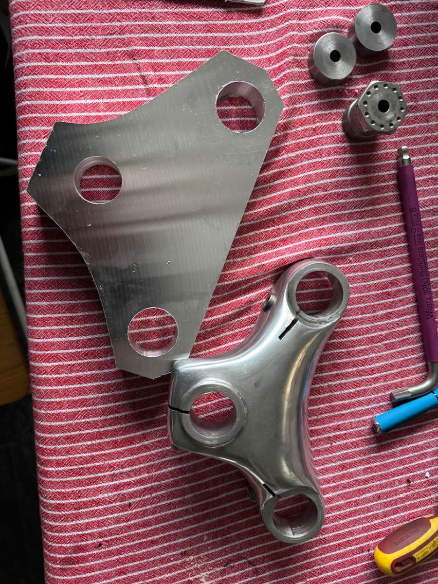

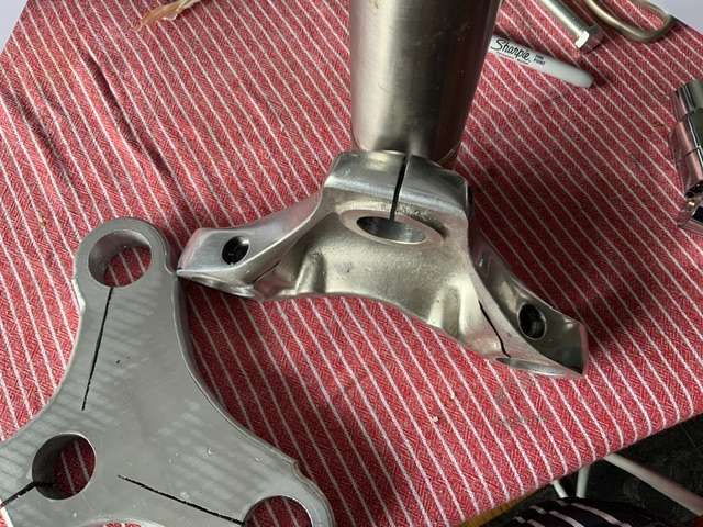

                                      this more pics of the original dropped yoke and my new one awaiting final finishing but the hole with the cut to the outside which I’d imagined would clamp up nicely doesn’t at all…

                                        I imagine that the considerable reduction in thickness over the central potion of the original, cast or forged, yoke compared to the outer web and the immediate surroundings of the holes influences the ability of the slot to close up when clamped.
                                        My one and only experience of making special triple clamps (yokes) was well over a decade ago but, as I recall things, the first test with the material still of constant thickness was very unwilling to clamp up. I think it sort of did but the bolt torque needed seemed dangerously high. For reasons I can no longer recall it had to be thinned down in a manner very similar to a standard cast yoke. After thinning the clamp bolt torques dropped to more reasonable levels.
                                        Factory pinch bolt torques are quite low. For example the manual for the rotary engined Norton Interpol 2 that I have immediately to hand recommends 22 to 24 ft lb on the tube pinch bolts and 18 ft lb on the stem pinch bolt. Which seems fairly typical for modern alloy yokes. So clearly things are inherently fairly flexible.
                                        Back in the day, before (apparently) all the world and his wife had a CNC mill in the garage and the billet craze undreamed of, many aftermarket top yokes seemed to be basically a quite thin plate with slotted tubular extension affixed below to actually grip the fork tubes and stem. Which always seemed a bit scanty to me. But BMW used what appeared to be a chromed off-cut of 3 mm (or thereabouts) sheet steel as their top yoke on the R series airhead twins so presumably the engineering worked out.

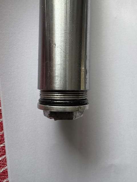

                                          i have a r100 with the thin steel top yoke the nuts hold the tubes in place…an iron head Harley has 35mm tubes but they have tapers on the end of the tubes that fit into the top yoke..alloy with matching tapers and held on with the nuts.
                                          these are for Ceriani type forks I don’t seem to be able to find a top yoke with handlebar clamps or so i can drill for risers..
                                          i suppose i could make new longer nuts and fit the tubes into a new top yoke say 20mm into 25mm thick material then use the nuts to hold the tubes in place in place?
                                          The only problem with is this theres only 1.2 mm for the shoulder
                                          IMG_7507

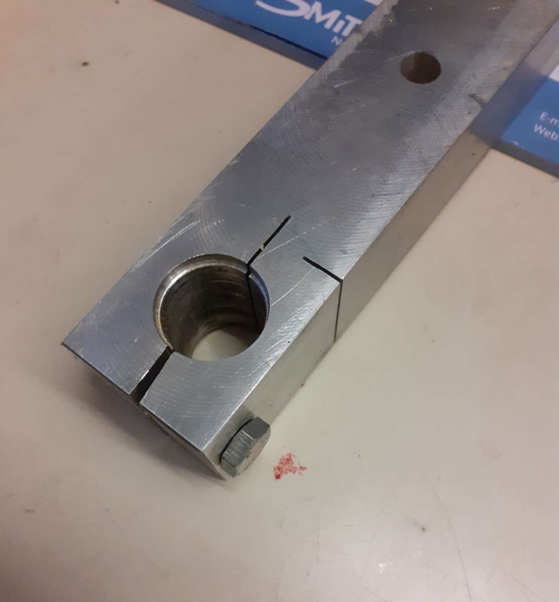

                                              One way to get more flexibility for the clamp is to put a hacksaw cut in from the outside but opposite the clamping slot. It’s a technique I’ve used before for jigs that need to clamp. I have a photo of a crude one in 2″ square aluminium bar. It is an effective technique for reducing the stiffness of the clamp without removing too much strength.Clamp
                                              Might be interesting to work out how far to go – I suggest testing as you go.
                                              The central one would need 1 or 2 slots in outside at about 90 degrees to the main one.

                                                Given that what you have isn’t working it seems worth thinning out the middle in the hope that my experience transfers to you.
                                                Alternatively if you do fancy trying a simple BMW style flat plate top yoke I have vague memories of one of the non-accredited BMW dealers (Benrae?) offering an improvement kit based on a double thickness alloy plate. My recollection is that tis kit used cylindrical slugs screwed into the tops of the forks with the top end made as a smaller diameter spigot to fit in the holes in the top plate. The slug being tapped to take a smaller diameter bolt to hold things together. I imagine the screwed slug had narrow land for the fork tubes to screw up against and the replacement cap bolts were around M14 or M16 (fine?) so clamping took place on an area something like 5 mm wide. Presumably special bolts with built in annular flange to ensure that clamping loads were properly applied through the plate to the top of the slug. New centre nut too.
                                                That said I don’t recall being particularly impressed by the various improvement options on display in a nicely lit up glass cabinet. More influenced by marketing than engineering I felt. This was in the days when high quality, shiny anodising was somewhat rare and pretty components priced accordingly. Well outside my pocket for sure. 1984 (ish) I guess as I had my first K100RS at the time.
                                                It may, or may not, be relevant to note that aftermarket “flat billet” yoke suppliers cut the fork tube clamping part free of the main yoke rather than replicating the slot. This gives 180° or more of flexible wrap to clamp. The stem surround area is frequently shaped so as to give perhaps 90° each side of relatively narrow material to flex and clamp.

                                                  I think you have a decent chance of the slots being adequate if you try to emulate the original part by recessing the underneath of the yoke, the top can still be flat. I assume you have the right grade of alloy and awareness that this is safety critical should go without saying.

                                                      My take on it would be to make the yoke a tight press fit – and warm the yoke to actually assemble it as a sliding fit.  The amount of grip needed, by tightening the grub screw, would then be fairly minimal.
                                                      Thinning underneath, as Neil suggests, to something like the original would then be sufficient.  Torque on the grub screw would be the fairly normal value for the size of fixing.
                                                      As I see it, the length of the slot would be more important than the width.  The thickness of the outer edge, at the end of the slot, looks to be the more important factor to be considered.
