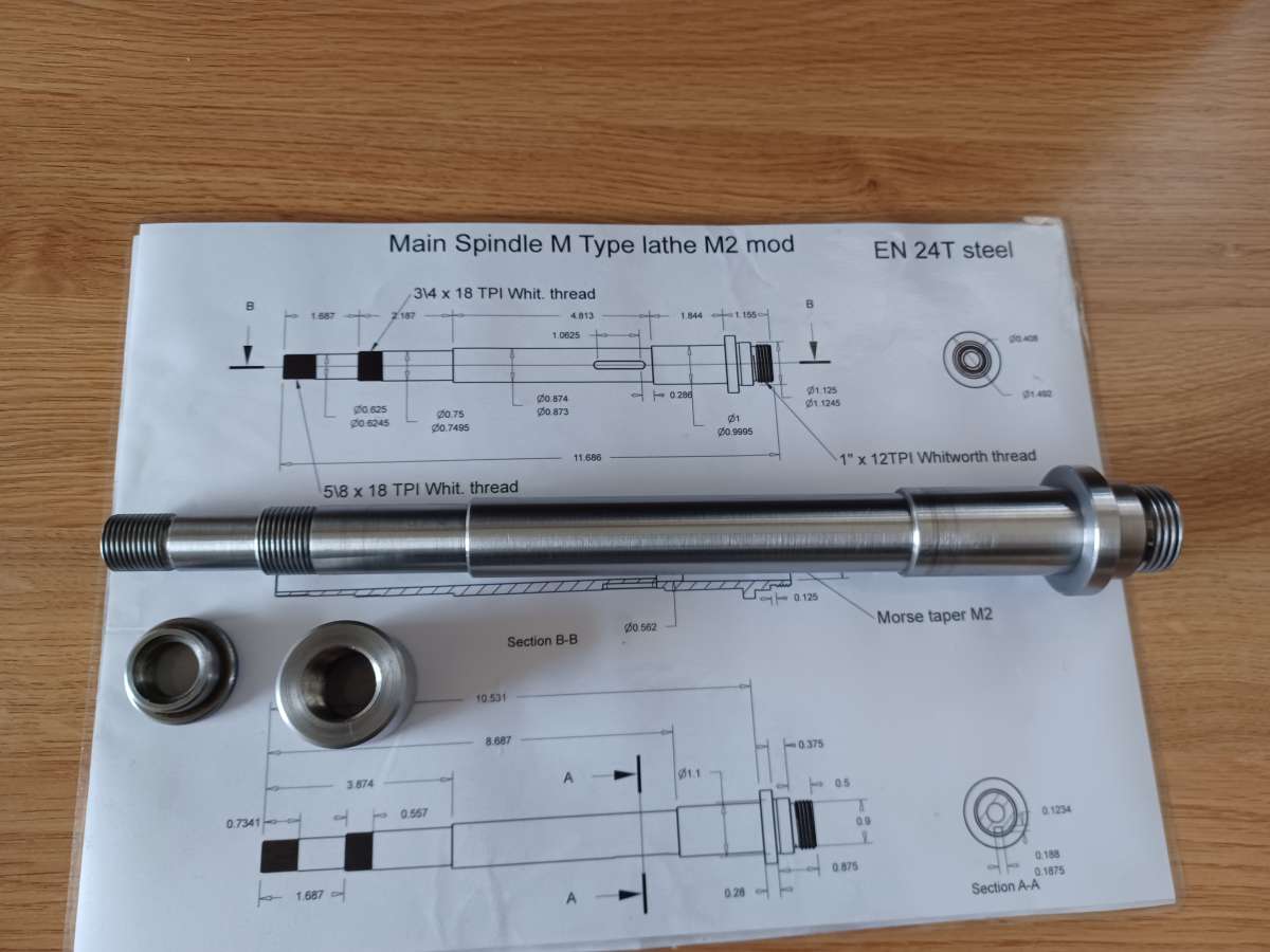

                    David George 1
                      @davidgeorge1
                      I use both partial form for general screw cutting which may be finished with a die but for some parts i.e. a lathe spindle I use a full form cutting insert as the hollow spindle could be compromised by the root depth being too deep on both the chuck holding and the rear bearing tensioning threads.
                      20230313_095108
                      David
