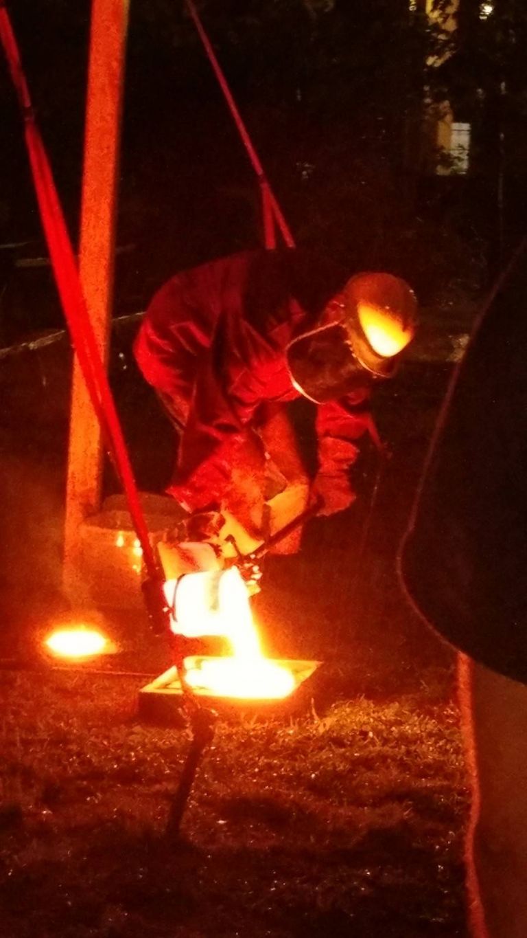

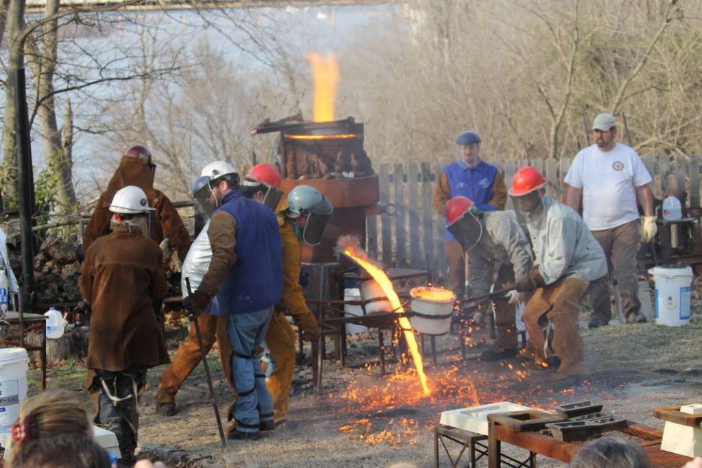

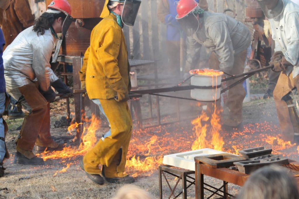

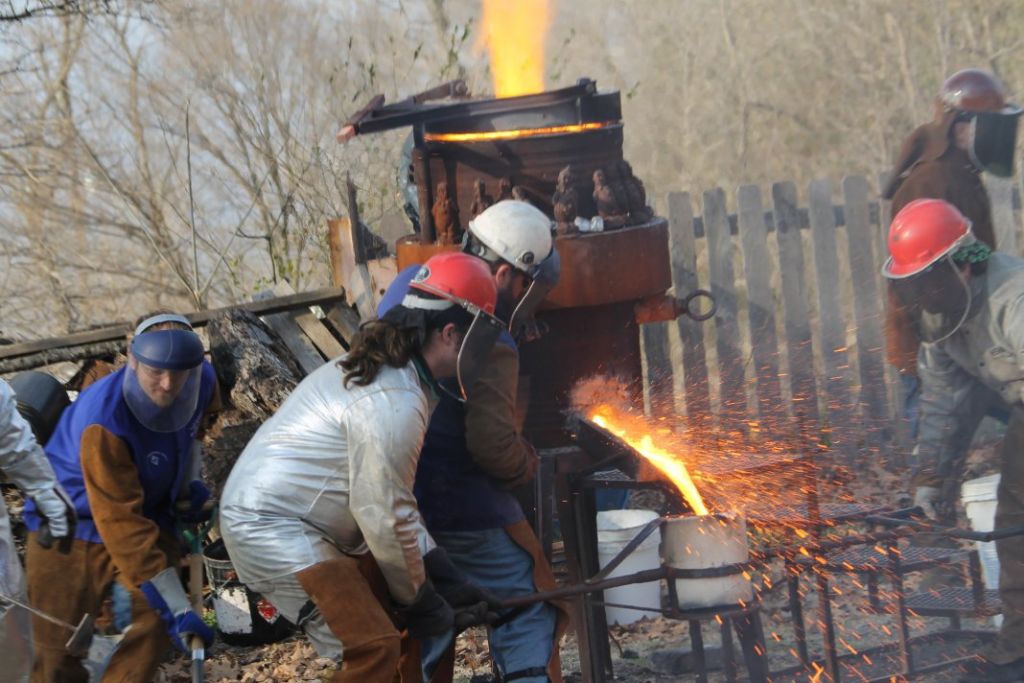

                                      While technically that is a good idea, from a practical standpoint, one has to pull the gloves on and off frequently during a melt for various reasons, and getting the glove cuff tucked under the jacket is not easy.
                                      There are a number of local art-iron groups in the states, and one below is local, and so I have quite a few photos from that one. The art iron groups have designated task-individuals, and depending on your task, that determines whether your gloves go outside, or get tucked inside.
                                      You can see in one of the photos below that the tapper-person has his gloves tucked inside the jacket, and those handling the pouring ladle/shank have their gloves outside the jacket.
                                      I forget the exact idea behind the tuck for each position, but they do consider it.
                                      Approximately half the individuals who do art-iron work are women, and they run the crucible and tap it with impunity. The person in the first photo to the left of the guy in the blue jacket is the lead casting/foundry/cupola-operating women.
                                      They don't even blink when they catch the grass on fire.  They have folks with shovels and sand whose only task is to put out grass fires.  You can't have any water anywhere near molten iron, and so all inadvertent fires are put out with dry sand.
                                      It is all very well orchestrated, with safety meetings before and after every pour, and a plan of action and action-person for every task and for every safety possibility.
                                      You have to go through training to even be allowed "on the floor" as they call it.
                                      They even have "watchers" who overlook the process, and make sure everyone stays in the allocated zone, and does their designated task; otherwise you have people falling over each other.
                                      Some pours have in excess of 40 people on the floor.
                                      Edited By PatJ on 05/05/2022 07:18:15
