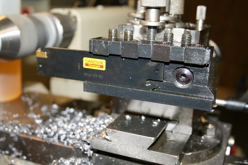

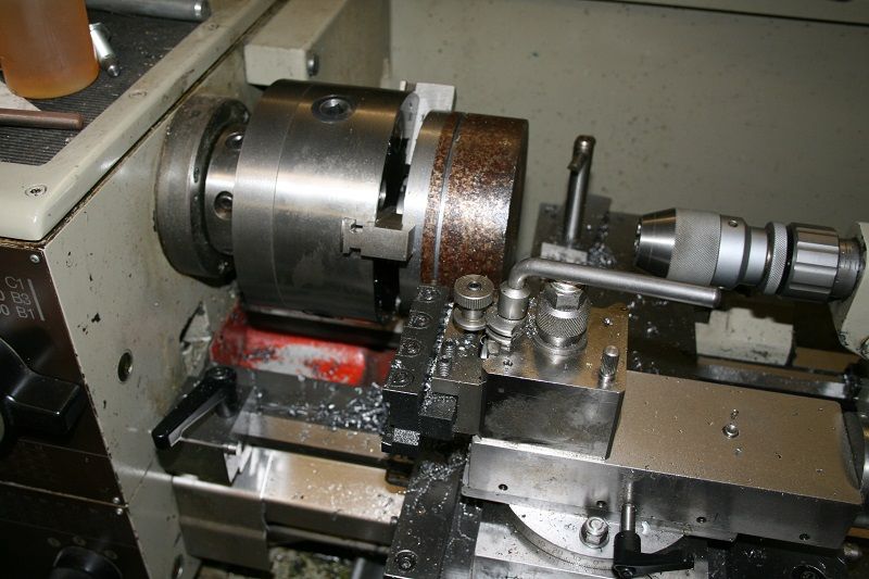

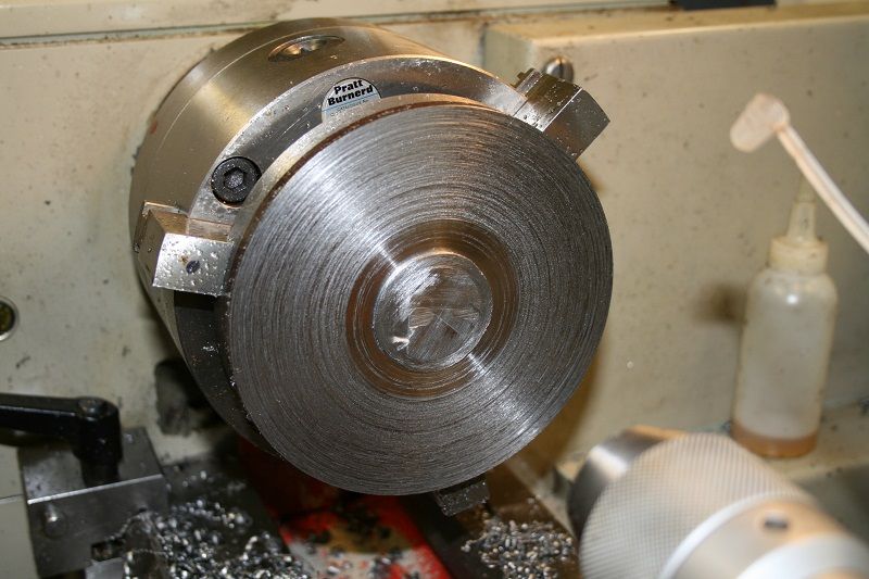

      Following on from the Parting Off Problem thread, I posted a picture of a little 'thought-provoking job'.
      How to part off a 20mm slice from a 5 1/2" (140mm) chunk of bar.
      Muzzer was the only person to offer advice, so today I decided I really ought to finish the task.
      I used an insert parting tool in stages. 1st stage gave me a slot 30mm deep. 2nd – 41mm deep, and 3rd almost 49mm. At that point I chickened out and hacksawed the remainder. Speed was 40rpm and auto feed of 0.10. One hand squirting oil into the slot and the other hovering over the Stop button.
      So the question is: Was I being a wimp or just lucky to get as far as I did?

              You did right and it was a normal procedure, a jam up at the deep point would have badly strained the top slide and saddle. Maybe made damage to the tool and tool holder.

                I certainly won't rib you for stopping when you were up! You must surely be using the tool beyond its specified range so who knows what would have happened if you'd tried to finish it. The result stands!
                Was it noisy, ie juddering and chattering? Did you get proper swarf from it?

                                      I admit that I did have one heart-stopping moment, when the tool was moved out for stage 3. It dug in briefly before I hit the button. I found the tip was chipped on the left-hand side, replaced it, and carried on. It was only after completion that the tip must have been chipped at the start for the rough finish, and the shiny section shows where the new tip started. wink
                                      Posted by Muzzer on 30/01/2016 11:07:08:
                                      No chattering – only when I started at a higher speed. Got to the slowest of 40rpm and the chatter stopped. Also have the VFD, so could increase revs as the cutting diameter decreased. The swarf was small chips but perfectly formed.

                                                I would say that you did a pretty good job of it, you followed good advice and kept the feed and speed nice and slow with a tip hard'n rigid enough to take the cut,

                                                  At this cutting depth you need to provide additional clearance for the swarf, I do this at work on a much larger machine by taking 2 small cuts, 1 approx 2mm offset (for a 3mm too)l away from the chuck to a depth of say 25mm each time. This allows coolant in and the swarf out. At the smaller diameters you need to speed up the chuck to maintain an adequate surface speed at the tip.
                                                  When these tools seize they tend to snap the holder below the insert – very expensive!
