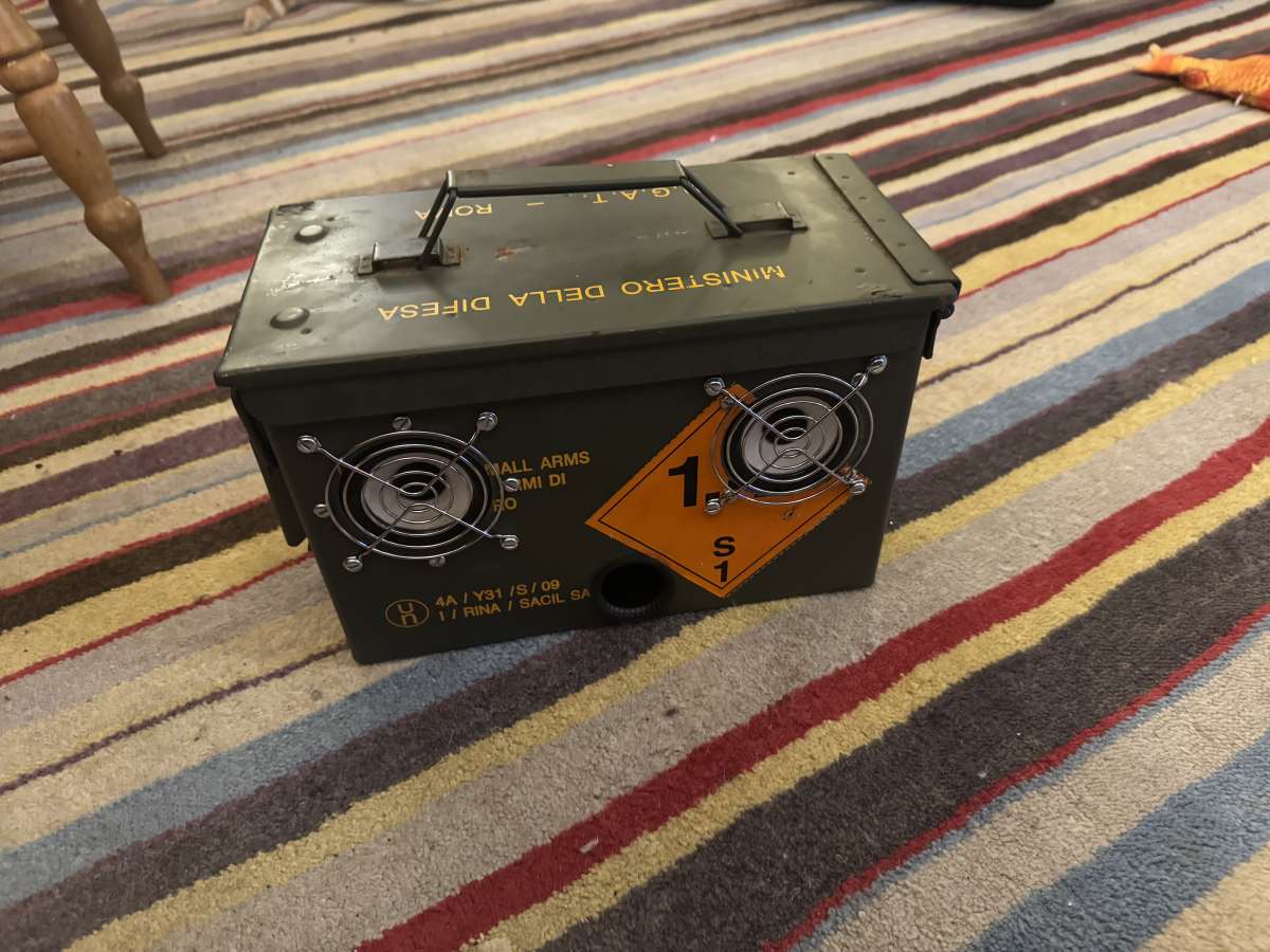

      Ive been building up an Ammobox boombox for a neighbours son…
      So its got 2 70mm holes filled by speakers and a 30mm hole filled with a plastic bass port
      IMG_9713
      I bought a cheap amp with bluetooth connection thinking I was going to have a problem getting the signal in..but to my surprise it works fine certainly up to 30 metres…so far..
      Can any expert explain how bluetooth works signal wise? getting into a nearly sealed metal box?
      #830787
      Robert Atkinson 2
        @robertatkinson2
        Bluetooth is UHF radio, around 2400 MHz so just below what is normally considered microwave. A slot or hole of more than a quarter of a wavelength, about 32mm, in thin metal will allow these frequencies to pass easily. The speaker cones are paper or plastic so will not restrict it either. Both speakers and bass port will allow the signals to pass. You may find it is directional if you use it outside where there are no walls etc for the signals to bounce off.
        Robert.

                Class 2 Bluetooth is specified for 10m range. The higher power class 1 units are 100m range.
                While all Bluetooth modules should meet various specifications but most of the cheap modules have never been tested and are probably not compliant.
                Microwave ovens and bluetooth along with a lot of wireless network devices use the 2400 MHz (2.4 GHz) Industrial Scientific & Medical (ISM) band. This band is licence free and devices using them may interfere with one another. Note that by the modern definitions a microwave oven is actually  UHF oven as the UNF band is 300 MHz to 3000 MHz (3 GHz) (1 m to 100 cm wavelength) and microwave is 3 GHz to 30 GHz.
