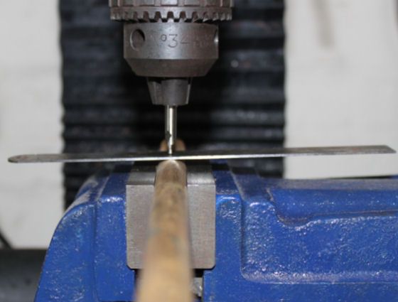

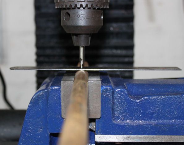

                Seriously if I may divert for a mo’, back to Wolfie’s problem. As you can see Wolfie, there are almost as many solutions to engineering problems as there are engineers! Some are simple, others more complex (just like said engineers perhaps – Just to clarify for the more sensitive souls on the forum, no offence or reference to any person living, dead or otherwise is intended ).
                If you have limited resources you can easily
                centre a drill on a round bar in the vice using a simple 150mm rule. I
                use the mill for drilling accurate holes but there is no reason that
                this method cannot be used on a bench drill. It is the same as the method referred to above by Mick above, but with pictures!
                Support your bar in the vice nice and horizontal, use a small centre drill in the chuck then put a 150mm rule across the bar and lower the centre drill to capture the rule between it and the bar. If the rule is horizontal you are on centre so you can clamp and start the hole with the centre drill (that is important, a normal drill is liable to skid on top of the bar). If you think necessary, once centred replace the centre drill with a small slot drill to create a small ‘land’ on the bar before centre drilling to stop any chance of skidding.
                The method is quite sensitive and accurate enough for most purposes. Pictures can show it better so here are a few.
                Drill set 0.2mm to left of centre
                Drill set 0.2mm to right of centre
                Drill set on centre
                I hope that makes the technique clear,
                (By the way, that mill vice was rescued from my garage fire in an awful state, I have de-rusted it in hydrochloric acid solution – as suggested by John W I think, in another thread,- refurbished it and it is now quite serviceable again.)
                Best regards
                Terry
                Edited By Terryd on 20/11/2011 15:13:20

                  Ah yes back to engineering.
                  The ruler method used by Terry is my fav method. If care is taken, starting with a end mill to make a flat , you can quite easy give to within 5 thou, which is all you need for 95% of cross drilling. If you have to be spot on then use a guide of the many types other posters used or an edge finder.
                  Mike

                      p.s.
                      I also have a lathe tailstock vee centre, it is an original Boxford one and is quite accurate, but not really much more so than the ‘rule and eye’ method. When using the drilled bush method the drill can wander off by a few thou as it drills through. ‘Horses for courses’ so to speak.
                      Furthermore, the chuck in the picture is another ‘fire rescue’ job!
                      Regards
                      T
                      Edited By Terryd on 20/11/2011 21:26:52
