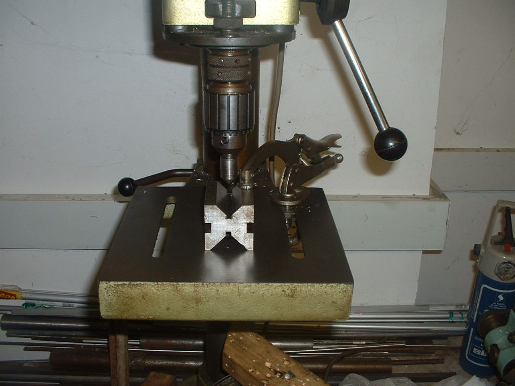

      OK next question.
      How do I drill accurately through a piece of round bar. I don’t mean end-on, I know that one, but through it side to side.
      I tried it, centrepunched a mark on it and drilled to find I hadn’t gone through the centre of the bar so the hole was off centre so to speak. Am I making sense here?

          Here is a simple method of cross drilling a round bar. You set up a Vee block under the drill centring it with a Vee shaped mandrel. And lock it down to the drill table.
          Next mark and centre punch the hole you wish to drill. Put the drill you are going to use in the drill. Now using the drill to make sure that the centre punch mark is under the drill. Drill the hole. A coconut every time (within a couple of thou)!
          The set up
          Rdgs
          Dick

            Just seen what Dick has posted using a V block on a drill table. The big advantage of this method is that, assuming you don’t move the V blocks between operations, you can use it for a variety of round bar/rod sizes and it will center every time. As I said there are going to be alternative solutions to the problem .
