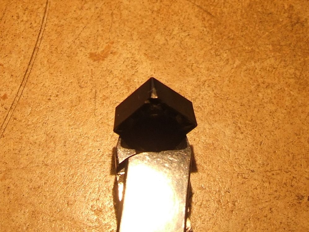

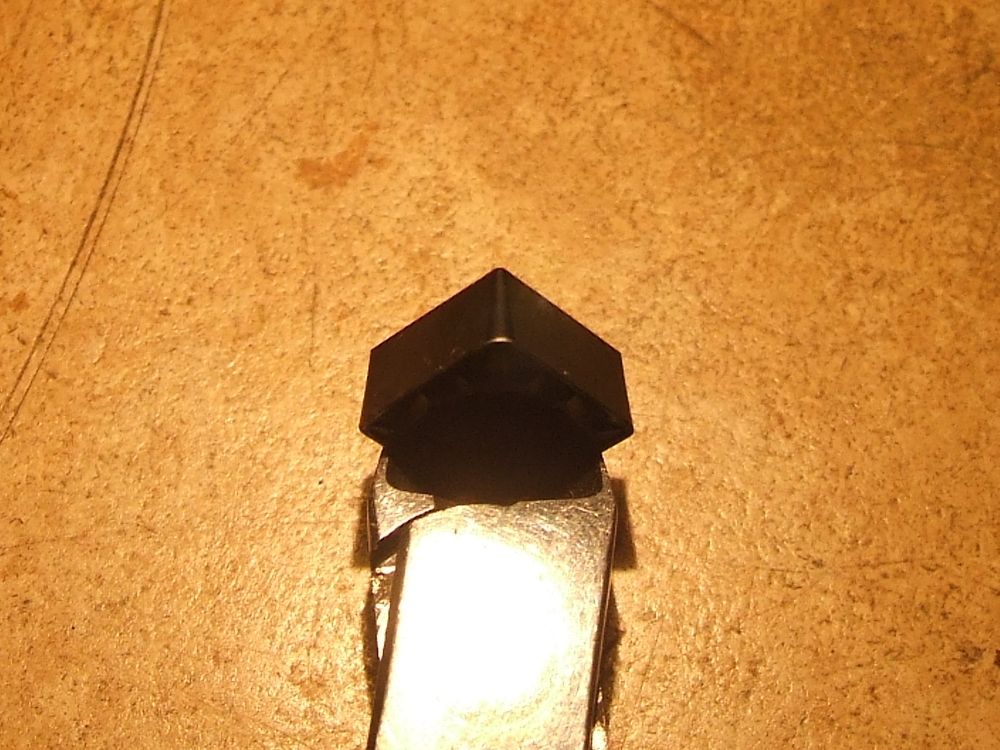

                        #218357
                        Anonymous
                          Not the best pictures (Lord Snowdon needn't worry) but here is an unused edge:
                          And on t'other side of the insert a worn edge, although it was still cutting:
                          Another way to detect worn inserts, or cutters, is to look at the power being used, but I don't have that facility. Other than listening for the motor to start protesting!
                          Andrew

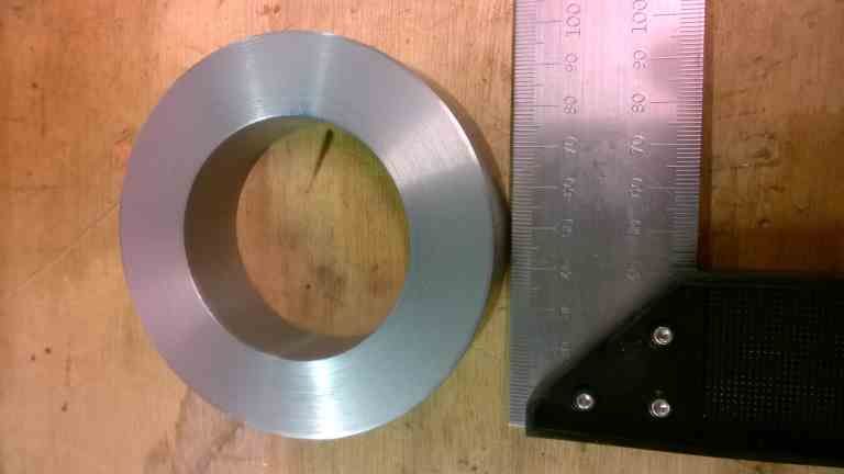

                              #218407
                              Iain Downs
                                @iaindowns78295
                                Hmm. If I have my sums right I was turning this at about 75m/min. Which is under half the recommended speed. I have yet to rise much above 500rpm in my lathing on the grounds that the slower you muck things up the more chance there is of turning the machine off in time…
                                This is what I ended up with.
                                From the links provided, I guess I should be looking at a polished finish if I'd done everything just right (including selecting the correct steel!), but (as a newbie) I'm delighted with the results.
                                In passing, my first inclination was to cut a deep channel in the face of the bar (both faces, meet in the middle) so I could save the inside steel. I ground something like a parting off tool, but with a steepish chamfer on the outside for clearance. This really didn't work (wouldn't cut in, loads of chatter) and I couldn't find any references to cutting a channel on the end of a bar. Could this have worked and how should I have approached it?
                                Iain

                                  #218451
                                  Anonymous
                                    Iain: Looks pretty good to me. While EN3B can be a PITA to machine it has some advantages. It is widely available in hot rolled sections, which have the advantage of not distorting when being machined and being cheaper than cold drawn. It also seems that EN3B is less prone to rust than EN1A?
                                    Andrew
