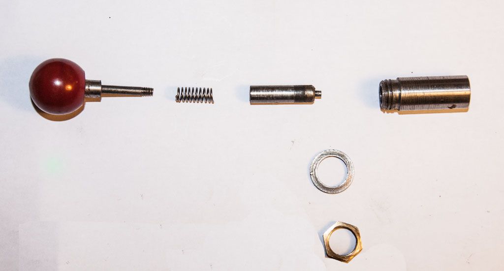

                  I made a direct dividing attachment some years ago to cut some clock wheels – see my photos album
                  I have shown the plunger of the type I assume you mean.
                  here is an exploded view;-
                  The division plate I purchased ( from Chronos? maybe – I forget)
                  Most of the rest came from the scrap box and the major casting from a skip – one of those things you see and think "That might be useful one day"  – and this time it was! The barrel was from a scrap tailstock and, usefully, had a No 2 MT in the nose.
                  It all worked well, cost next to nothing and was made in a short time!

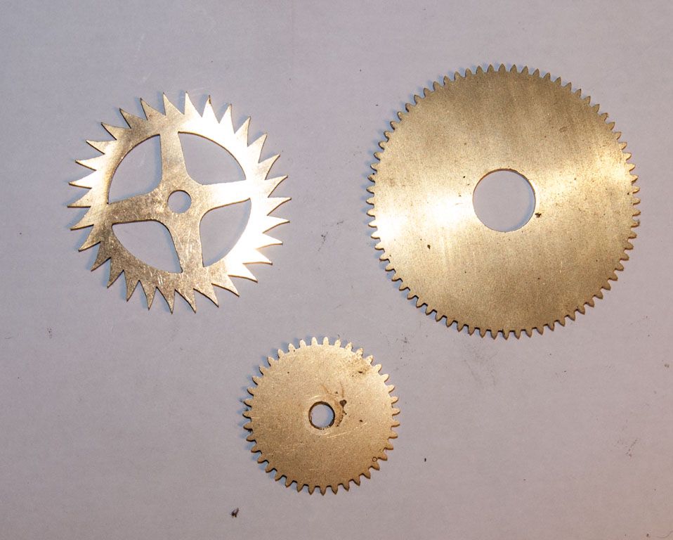

                  Here are some of the wheels cut on it.
                  If you want further details of the plunger send me a PM and I will do a sketch
                  Regards
                  Norman

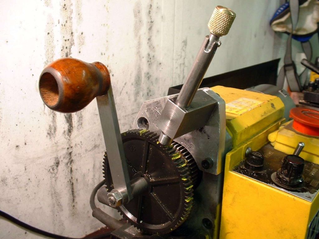

                    Hi Johan,

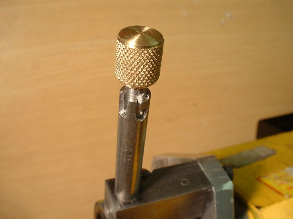

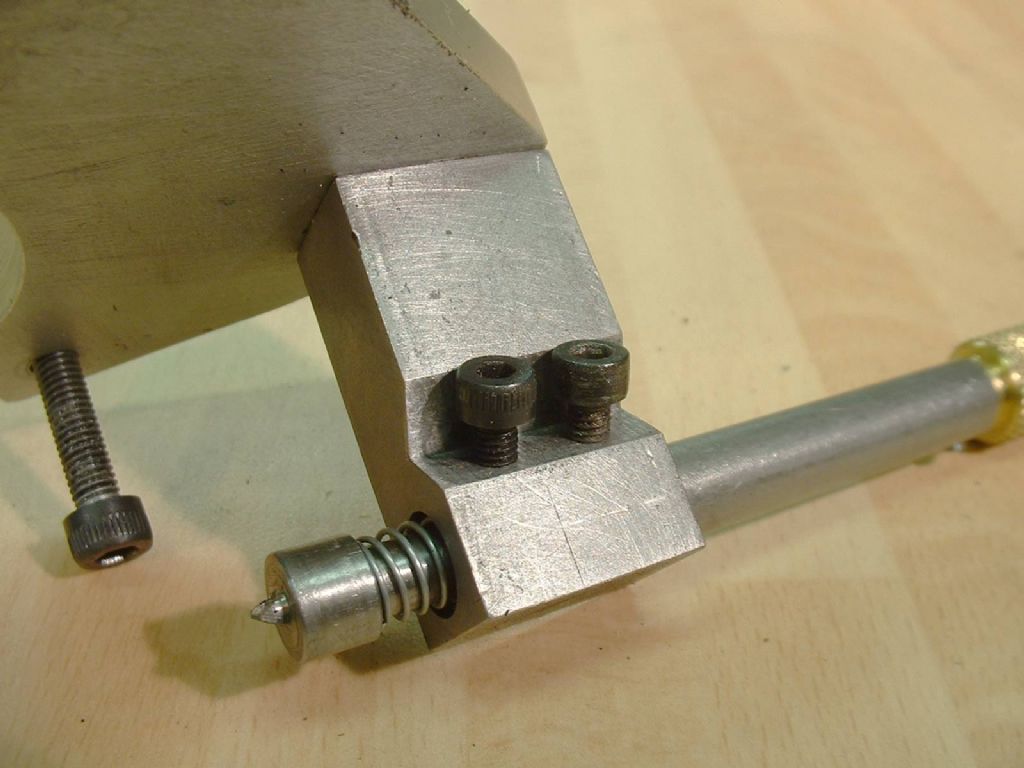

                    I made a similar dividing attachment for my mini lathe. I used a detent which can fit either between two teeth.
                    Obviously you need pin type plunger, but perhaps you could make use of my sprung design which includes a simple way to keep the plunger retracted by pulling it and twisting it .
                    For my small divising head, which uses a plate, I made a pin with a knurled cup fitted to it, this screws onto a hollow tube and the pin enmerges from the end into the dividing plate. Much slower.
                    You could use a spurung arrangement like this – the spring doesn't need to be hugely strong
                    The two slots are for the different plunger positions (i.e. at 90 degrees to each other) if the pin is turned right around, it stays retracted.
