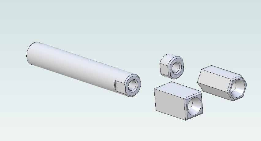

                              Giving it a bit mor ethought and bearing in mind the small scale work Chris want to do eg clock making/repair and the general small size of his machines I think I would go for something like this.
                              Square and hex collet block to take the WW collets directly which could be 16mm A/F and length to leave the collet's thread exposed at the back much like Phil's 10mm collet blocks.
                              For hand held use the "draw tube" can take the form of a handle, if made the same dia as the block's A/F it will not cause the block to tilt when resting on the sander table etc and can also be used as a nice hand vice. A nut can also be made which would be less cumbersome if the blocks were being held in the milling vice and a larger diameter one could also be made to act as a stop much like this Levin one.
                              keeping the actual blocks separate will make them easier to machine on the Sherline and you don't need as much material if the handle and nuts are interchangable.

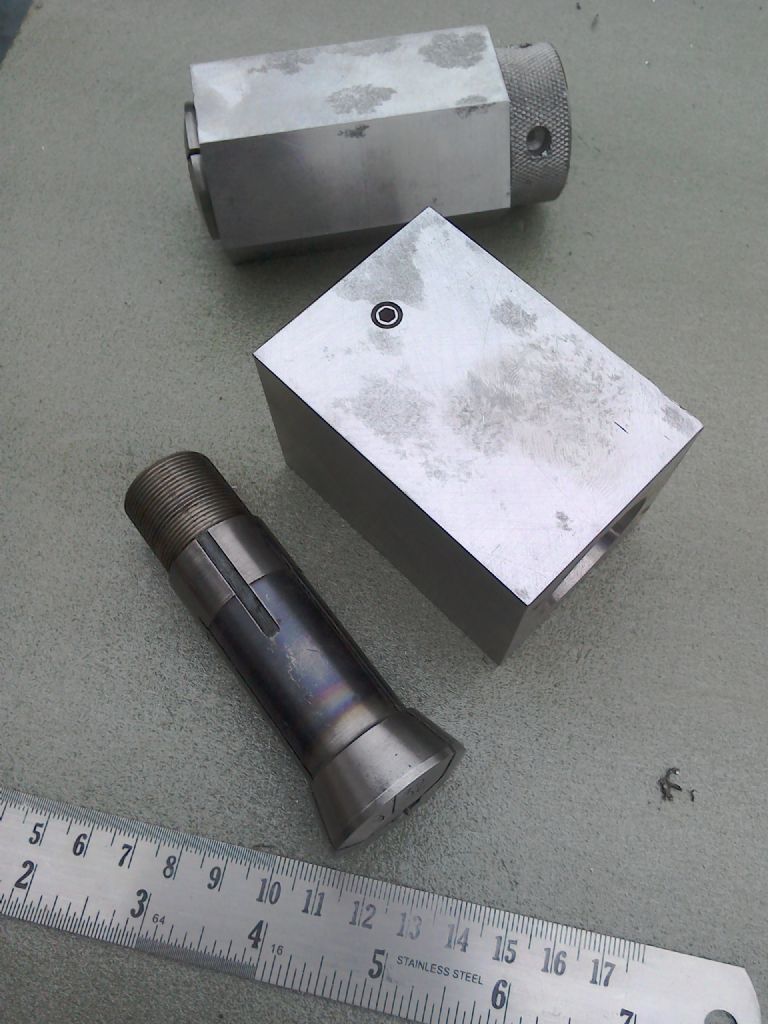

                              Martin Connelly
                                @martinconnelly55370
                                Smart & Brown collet blocks. An example of what Jason is suggesting.
