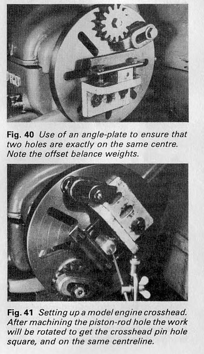

                  I scanned this pair of photos from Tubal Cain's "Workholding in the Lathe" (well worth buying for this very reason) to show a mounting as it was easier than setting up for a new photo:
                  What set me to this idea was that you said that your block had to be perfectly square.
                  Mount your job on the angleplate and, like you say, rest it against the faceplate until you have a flat datum surface to work to (assuming your faceplate is true).
                  Mounting on the cross slide for flycutting would just be the same, clamp the job to the cross slide using parallels to set your height (I assume that you have T slots), or mount your angleplate on a vertical slide.
                  I hope that this helps.
                  Andy

                    Hi Kane, the method Andy has shown is a safe way of holding your block. Whatever way you do it, don't be tempted to use G-clamps or anything else that can escape during turning should the set up become loose.
                    Regards Nick.
