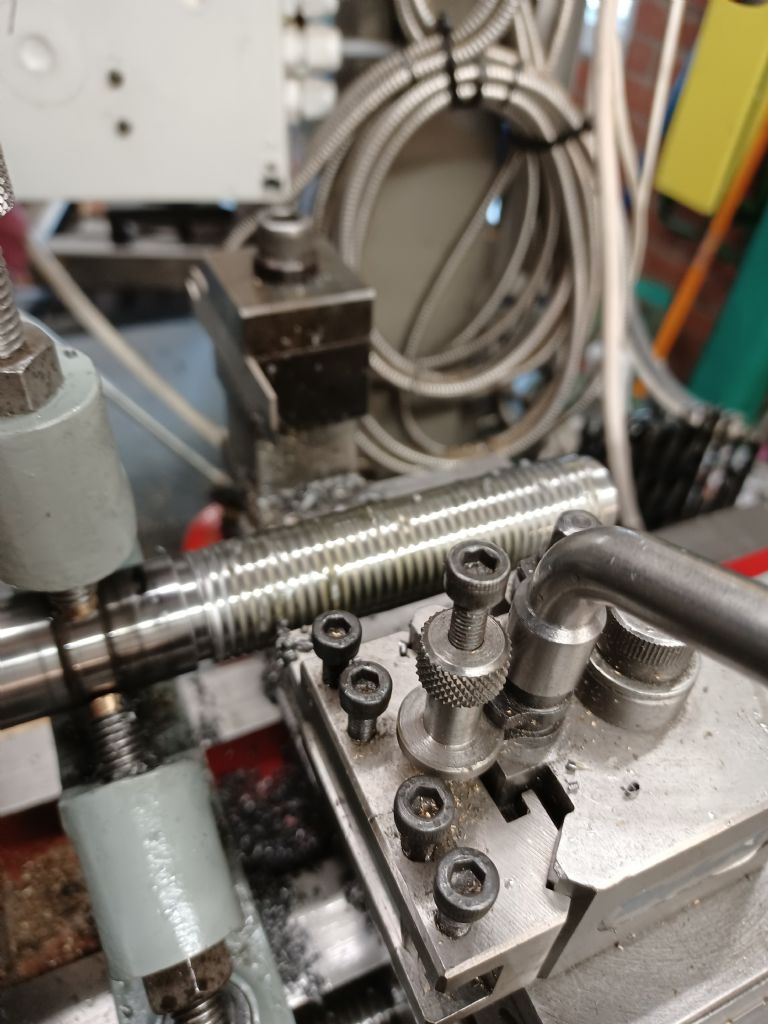

                                        I've adapted a standard steady to use small commercial bearings to use on some stainless printing press rollers that needed shortening. Worked well and left no marks on the polished surface, the only snag comes if any chips or swarf get between the roller and the shaft surface, a normal steady will usually just scrape the swarf along, but on one roller, owing to the rolling action of the bearing some chips caught between roller and shaft ruining the surface. The answer was to cut a fairly close fitting hole in a piece of thin card to go over the roller and tape it to the steady, making a shield between the lathe tool and steady, this worked well and enabled the dozen or so to be completed successfully. Hope the above is clear, found it difficult to explain in words!
                                        I should perhaps explain that the steady was only used to face and centre the rollers after the length had been sawn down, the rest of the machining was done between centres, from memory the rollers were about 100mm dia.

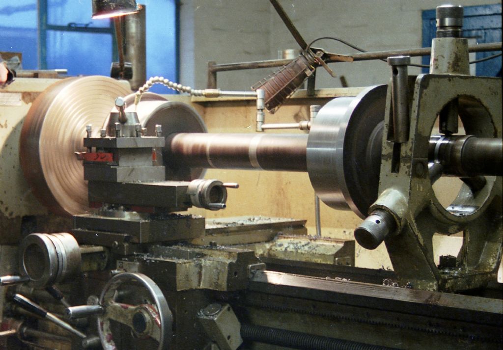

                                          Hi Steve, one thing about using rollers is that they really need to be parallel to each other and to the work, otherwise you could get skewing which will produce marks onto your work. The photo below shows a job I did about 18 years ago on a Colchester Mastiff 1600 80" bed lathe, this was about 300 Kg in weight. The steady was in the position where a 4" Plummer block bearing is fitted, so damage by scoring needed to be avoided, but it can be seen that the rollers polished the area where they were running, even though they were well oiled, the shaft was probably free cutting mild steel, although it could have been EN8, but no grooving could be detected after the job on both of the built-up rollers was finished.
                                          Regards Nick.

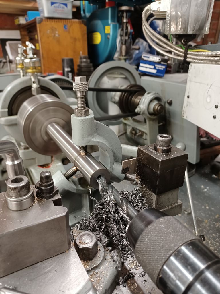

                                            Hi Steve. This is the fixed steady for my M Type Myford. It has bronze tipped bolts. The original bolts were all steel and they marked jobs and do made new bolts from EN16T with bronze tips, not brass as you can get wear. I have made larger bearing bearing faced steady tips for larger lathes but they won't support smaller items.
                                            David
