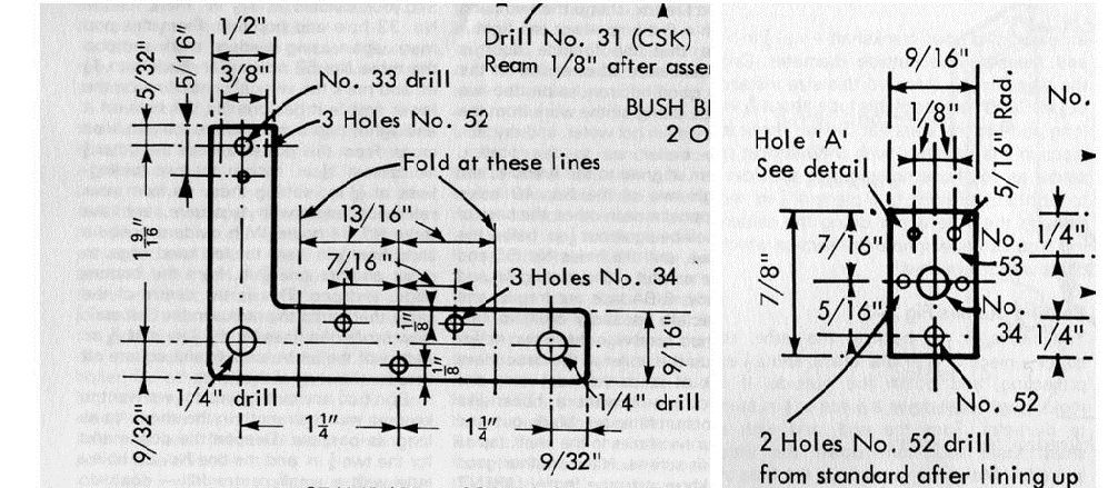

        Making good headway on building but now i'm confused.
        If i line up the holes on the portface to the standard for a 5 ba bolt the lower No53 hole for the rivet appears to be 5/16 out ?
        Am i reading this wrong or is it a misprint?
        Thanks for any help

              Sorry guys ,poor info.
              Its Tubal Cains polly
              How do I get a picture of the drawings on here ?

                  #114979
                    The way I read it is that the central No34 hole in the port face lines up with the No33 hole in the standard this will then make the three No52 holes in the standard match the three holes in the port face
                    #114980
                    Packmule
                      @packmule
                      Thats what i tried to do but following the book the lower 52 hole is drilled as is the one on the port face and then offered up.But the hole in the standard is shown as 5/16 from the top and 5/16 from centre of the hole on the portface. Not sure which is right ?
                      #114981
                        I think that 5/16" should be from ctr of the No33 to ctr of the No52 which would make it work out ok
                        #114998
                        Sub Mandrel
                          @submandrel
                          I think Jason is correct. the drawing of the standard appears to be in error.
                          #115078
                          Packmule
                            @packmule
                            Thanks for all the replies. I'll fill the holse in the standard with solder and re-drill
