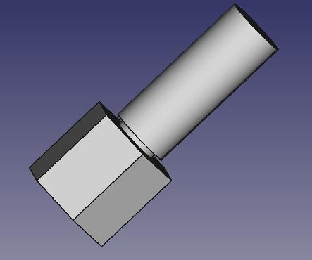

                An "on edge" insert will let you thread very close to a shoulder. If you grind your own HSS tools you can grind a tool that lets you thread right up to the shouder.

                  I'm self-taught, which means book learning supplemented by experiment corrected by much help from forum. Great fun, but self learning leaves a multitude of gaps!
                  Is there a good reason for threading up to a shoulder?
                  My reading suggests, and what I've always done, is to start by turning down the blank (hex or round stock), to thread diameter and then cutting a slot as deep as the thread at the shoulder with a parting tool. This creates start or finish space for the threading tool and much reduces the chance of a collision.
                  I don't believe the slot makes any difference to bolt strength, so why not always make one?
                  On the subject of collisions, I always thread away from the chuck in reverse like Jason. Possibly I learned the trick from him! However, reverse threading isn't a good idea if you're unfortunate enough to own a lathe with a screw-on chuck…

                    Dave aka SoD making an undercut at the shoulder is industry standard but doing it with a parting tool will potentially reduce the strength due to sharp corners creating stress points. Undercut tools as a general rule would be 1-1/2 x pitch wide with a radius on the corner adjacent to the shoulder and the "thread side" having an angle equal to half the thread angle or 45 deg.
