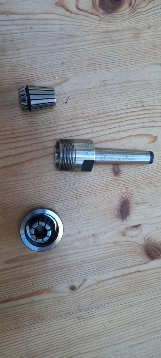

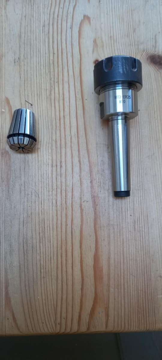

      I have purchased some second hand tools. In them is a Milling machine collect chuck.
      There are a number of different collects and are interchangeable, well they would be if I could extract the existing collect! It has a large lipped washer in the chuck body. It is fixed and locates on the grove in each collect. How do I extract and change the collect. Photos herewith. Do you know how to do this or the manufacturer of the chuck?

        You need to tilt the collet to one side then it should snap out

          just grasp the collet and twist it to one side axially then it should fall out..when its out you will see how it fits

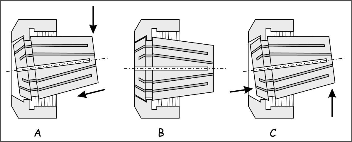

            It’s of the ER type, in this case an ER25, Jason has shown how it works.  Noel.

              Bearing in mind that the nut needs to be twisted at the same time to get to the position that allows the collet to release easily.

                Press the collet in every direction until it tips and then you drop it. The collets must be snapped into place before screwing the head on the arbor.

                  I’ve lost count of how many times a tool problem turned out to be a collet NOT fitted properly to the nut….

                    If not clear from above replies, the hole in the washer is eccentric – you might be able to see which is the ‘low’ side by looking inside..

                      The usual first-encounter problem with ER collets is failing to click them properly into place during installation.   Jason’s diagram shows the collet and tightening ring are both removed from the chuck to do this.  Stage A shows the collet goes in at an angle and pops into place.  You can’t just drop the collet straight into the ring and have it click correctly into position when the ring is tightened in the chuck.
                      As Jason explains, removing is the reverse: the collet is popped out by tilting and pushing, as shown in Stage C.
                      Easy when you know how, but not obvious.   Some do it intuitively.  Had me confused for about 10 minutes before I twigged.  Others have to ask.
                      Bonus hint. ER tightening rings come in two forms.   The rings fitted with a ball-bearing are easier to tighten and undo: worth buying.

                        As I mentioned in a thread a few weeks ago about ER Collets, if you mark your nuts where the eccentric lip is closest to the hole you don’t need to waste time rotating to try and find the spot where the collet tilts. Just tilt towards the mark whether inserting or removing. This 6mm ER32 snaps in & out easy enough when you know which way to tilt it.

                            Thanks. All is well and I have iy out and a different one in. Thanks so much for the help!!
