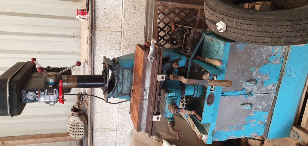

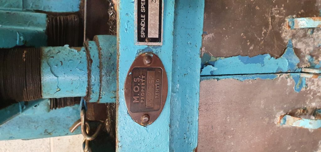

        Today i became the proud owner of this fantastic specimen. Now all I have to do is identify it and find out what bits are missing!
        Any help appreciated. there are more pictures in my album. (sorry i cant get them the right way up!)20201016_142136.jpg

        Oldiron
          @oldiron
          Sorry no idea. By the looks of it it has been modified as a drill press. The whole motor/spindle assembly appears to be missing. It will not be an easy task finding bits for it. I hope someone can identify it for you.
          regards
          #501751
          Rik Shaw
            @rikshaw
            I think what you might have there is a lash up between a bench drill, a milling machine and an eclipse magnetic chuck. Heath Robinson would have been proud of it but goodness knows what was going through the mind of the person who conceived of it. He seems to have aimed at making it machine portable as well – pity one of the wheels has fallen of !
            Rik
            #501752
            Baz
              @baz89810
              M.O.S is that ministry of supply, if so probably Second World War and rented? Absolutely no idea of what make it is but like Oldiron says motor and spindle missing for a start.
              #501753
              Oily Rag
                @oilyrag
                By the fact the base has a MOS plate (Ministry Of Supply) dates that area of the machine to 1939 to 1959. Note that the MoS took over the powers of the Ministry of Aircraft Production (MAP) in 1946 as it was a separate entity until then. The MoS was thereon responsible for all provisioning all services (with the exception of the Admiralty I think). They were also heavily involved in the A and H bomb programmes.
                As Rik has said it looks like an amalgam of bits that were never meant to be amalgamated! The plate (both of them) holding the upper part of the pillar drill does not give any confidence that it could accurately deliver high precision. I suppose the miller parts could be salvaged as a half decent horizontal mill – but it would take some effort.
                Out of curiosity what does the max speed plate have stamped on it – surely no one ran a vertically cupped wheel in the drill chuck!!!

                mgnbuk
                  @mgnbuk
                  The Ministry of Supply (MoS) was a department of the UK Government formed in 1939 to co-ordinate the supply of equipment to all three British armed forces
                  The Ministry of Supply was abolished in late 1959
                  Above from Wikipedia., so that is guaranteed to be older than I am !
                  If there is no evidence of filler on the castings under that scabby coat of blue paint it is likely to be "War Finish", where such nicities were dispensed with – most WF machines I have seen had a small plaque stating that they were rough for that reason.
                  Can't help with a maker, though I have a recollection of seeing something similar around 30 years ago at the Vickers tank factory in Leeds (formerly ROF Leeds at Crossgates). It was surplus to requirements, but there was mechanism to allow me to buy it.
                  It shouldn't be too difficult to come up with a replacement horizontal spindle to return it to grinding duties – a bit of plagiarism of a similar sized machine's bearing & spindle arrangment would save having to design one from scratch.
                  Good luck !
                  Nigel B.

                      Surprised that they rented items? Would that be significant after the war?

                        Thank you all for you comments.
                        The original machine came out of a Rolls Royce tool room, since then the head was removed and the drill press added. the guy I bought it off is keeping the drill press part. I paid £100 for it and that includes him delivering it (I'm guessing, but I reckon the base its on weighs about 200k)
                        The table moves freely in X Y and Z and I think the Z lift is about 6". ill know more once it arrives and i may be able to find some more labels to help identify it.
                        If i cant find original parts i think ill either make a new head for it or as NDIY and BrianH say salvage something from a donor machine.

                                The paint colour suggests that the machine was from a R-R aero engine division factory.
                                Oil engine division machines were Industrial Green. But any that were made for aero division were painted that shade of blue.
                                The M o S plate suggests that it is a machine of some antiquity, and likely to be British rather than American and certainly not Teutonic in origin.

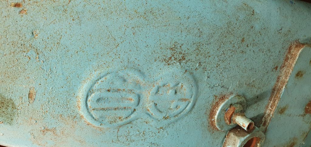

                                #503909
                                Paul L
                                  @paull58212
                                  Its finally arrived today. the main body of the machine is an oil resevoir with a sight glass included (I suppose it may have been for suds?)
                                  There is also a makers mark in the casting on the side as in the picture below. anyone recognise this? i though maybe GE

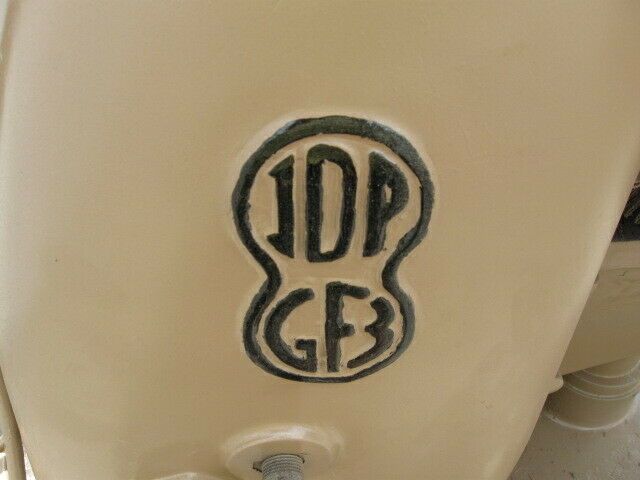

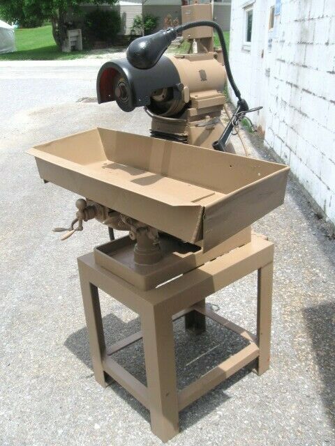

                                    We have a winner! Many thanks to Mark F for letting me know that I am the proud owner of an IDP GF3 Industrial Grinding Machine (well most of one anyway).
                                    IDP (Impregnated Diamond Products) were a Gloucester based company that seemed to disappear in the 1960's. there are some references in Graces Industrial History LINK and there is a reference in the National Archive LINK
                                    There is a grinder for sale on ebay in the USA. Whilst I cannot buy that one, I have been in touch with the vendor who has kindly offered to send me some more photos.
                                    The grinding head seems to consist of a motor with an extended armature which the wheel is attached to. is this a normal method of driving a wheel?
                                    Edited By Paul L on 01/11/2020 09:31:47 for Speelung mistakes
                                    Edited By Paul L on 01/11/2020 09:32:53

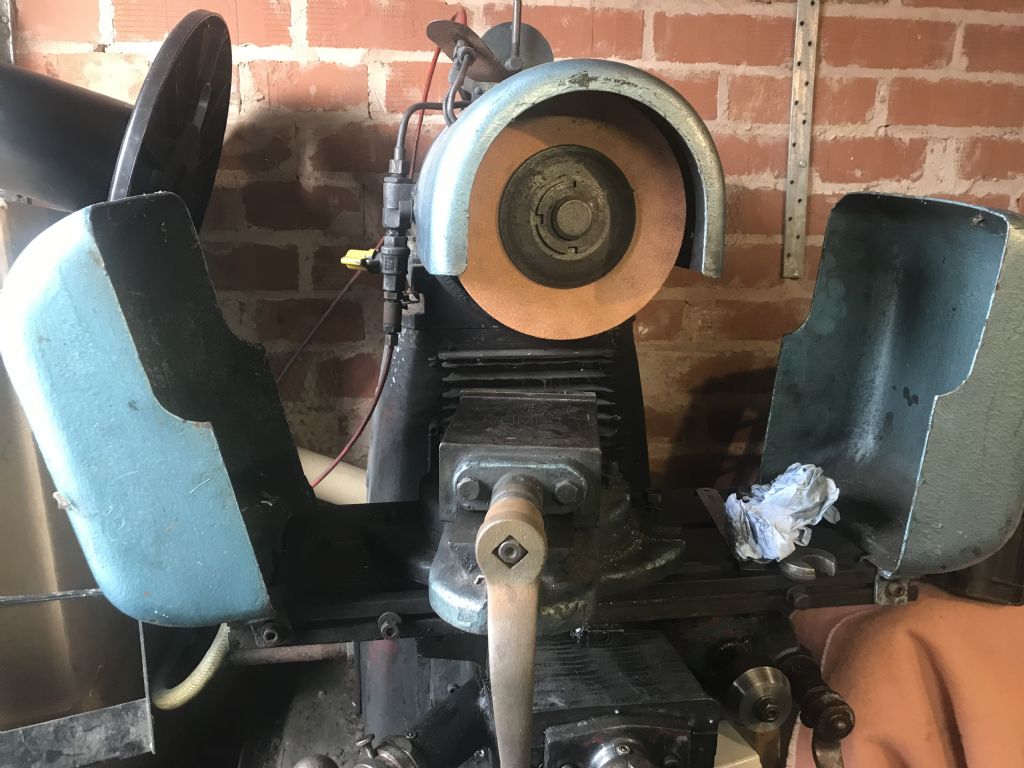

                                            PETER ROACH
                                              @peterroach92938
                                              More pictures in the AlbumFront view
                                              #508421
                                              PETER ROACH
                                                @peterroach92938
                                                Pump mounted on rear of motor, 3 phase fractional hp. Extension tube on front of motor to which spindle mounted. It came with the milling vice mounted, but i do have a 10×6 mag chuck, that came with it. Missing the rapid traverse lever, but of original cast box base/stand. It also had a perspex front suds screen. Was given a clean restored Herbert Junior, but this takes up less space and despite the condition does a better job for what i need.

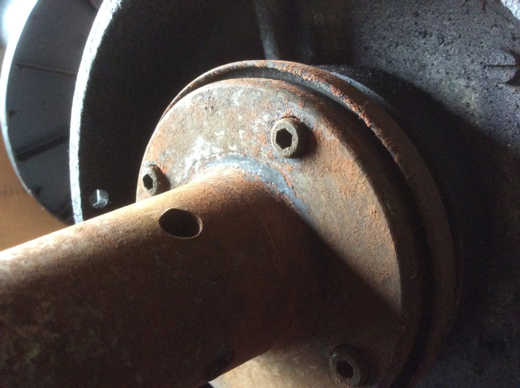

                                                  PETER ROACH
                                                    @peterroach92938
                                                    Spindle dia/ wheel bore 1 1/4”. 31.75mm but this is at the end of an extension tube, that bolted to a faceplate on the end of the motor spindle. Machine came without a wheel, but with some diamond disc and lots of flanges. Not sure that they came off this machine as we had several different grinders in the deal.
                                                    On the rear end is the suds pump. I will take some more pictures…….
                                                    Peter
                                                    #508945
                                                    PETER ROACH
                                                      @peterroach92938
                                                      ?trumpet ? on motor faceplate
