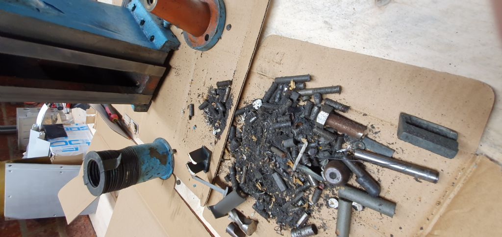

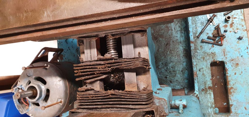

        Started to strip the grinder down this afternoon prior to the arrival of the new head unit (thanks to Peters eagle eyes!).
        All the guideways look like new despite the bellows being split and half a jet engine dropping inside.
        Anyone any experience of purchasing replacement bellows?
        #509647
        PETER ROACH
          @peterroach92938
          Paul,
          Arceurotrade supply some bellows which may be suitable. However you may be able to salvage what you have. Don’t let it dry out any further, a bit like the Mary Rose. You need a good leather saddle soap or a leather sofa treatment and slowly feed it. Once it supple you can remove section that beyond hope, patch the holes and replace pieces. Either glue or stitch or staple. Even just a gorilla tape mend. Option B is to replace with rubber sheet skirts, but seems a shame to change them if you can restore. Someone with an small industrial sewing machine could be useful and a trawl around charity shops for old leather jackets. I been there done that, have a machine, just the task indoors on a winters night?
          Peter

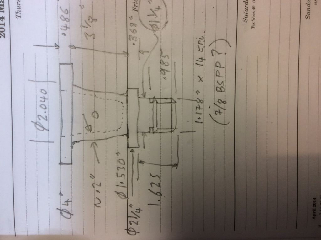

                      Sketch of trumpet to convert patented motor with face plate to surface grinder as used on GF3
                      Trumpet cone

                        Hi Peter,
                        Thank you very much for taking the time to do this (and for all the other help)
                        The motor will be here next week and I have plans now for the Christmas break!
                        I'll post some more pics later.

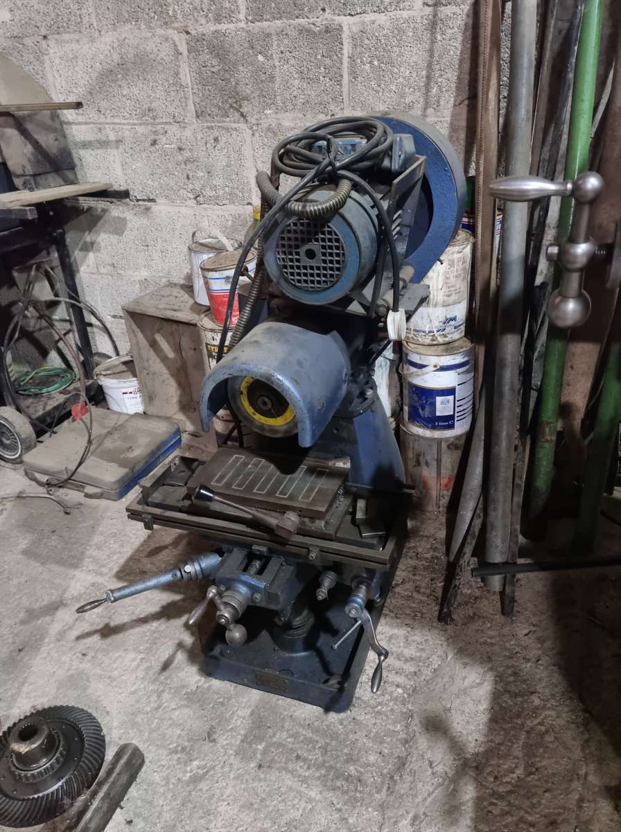

                          And another IDP GF3, note the rather nifty single phase conversion 😀 I need to have a look to see if the original windings are still in the head and give it a good clean up but it does actually run in it’s current state.
                          Paulgrinder
